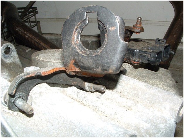

    The bracket for the shift cable will need to be fabricated; the bracket in the following picture is from one of the GM Concept Cars.
