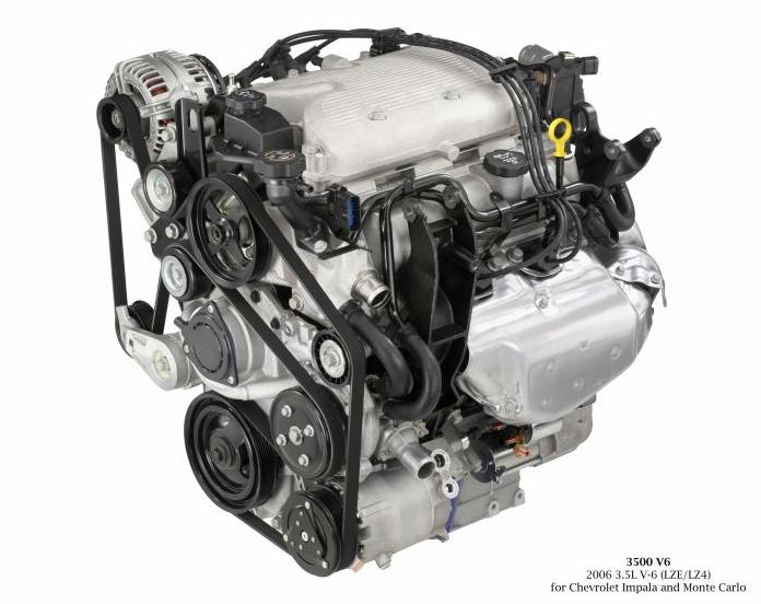

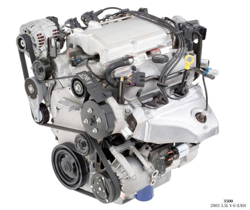

        Pic? Starting to wonder if you got a 3500 VVT instead of a 3500...
          • 13525
          #34
          Must be a VVT 3500.

            That would be my guess as well. Got a picture?

                Brian,
                There are many differences but the most easily spotted are the VVT engines have a housing extending from the front of the timing chain cover where an actuator is mounted. This controls the VVT function and is missing on non VVT engines. Also, intakes on the VVT 3500s have a V shaped notch in the end opposite of the throttle body.

                  The other really easy way is to look at the plenum. The VVT one has the indent by the PS pump, whereas the non-VVT is just straight across on that end.

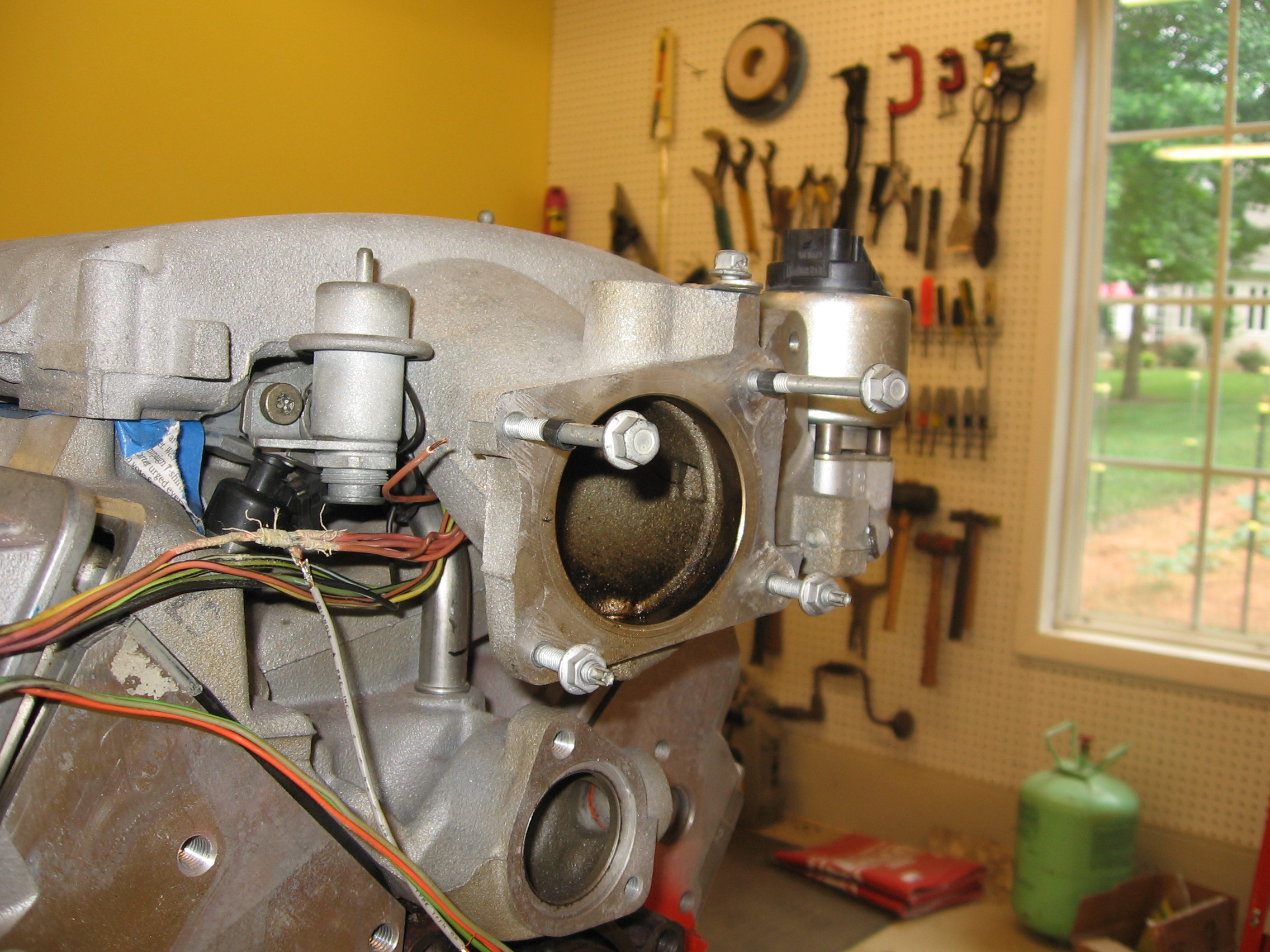

                    Thanks for the pix. I definitely do not have VVT - no notch, no activator.
                    I thought all 3500's would have the 4 bolt TB. But then, what do I know? I'm a newby!

                      Guess we'll need a pic of your plenum then...

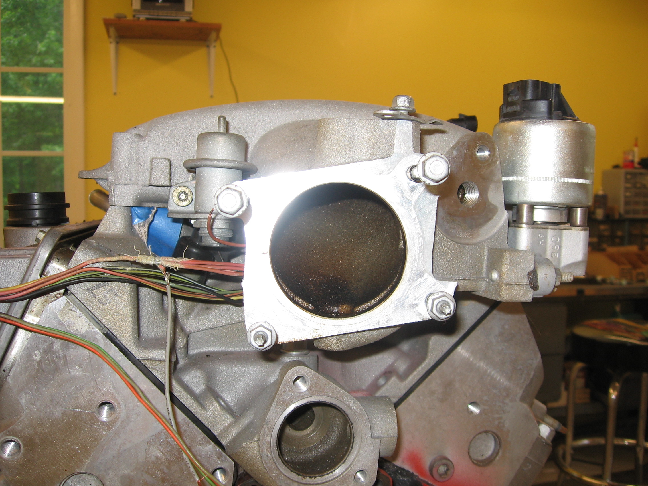

                          Attached are a couple of pix from today. Note that the pattern on my plenum is canted only about 10 deg. Distance L-R is about 3.5", down is about 2.75".
                            • 9190
                            #43
                            That looks the same as the pic Ben posted , to me at least...

                              I am with brad on this, that adapter should fit.
                              Please explain what did not line up.

                                No matter which way I tried to line up the holes for the adaptor to plenum, they did not line up.
                                Since then I've been to the recycle yard, brought home a 76mm TB from a '97 Prism (3.8?). Is that too big? Lines up with my plenum save one hole.
