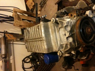

    There is an oil filter adapter on the LX9 that drops the filter lower. This won't work on a w car, it wont clear the subframe. What can I expect to find under there when I pull the adapter off? I need to be able to mount an oil filter without that drop down adapter.

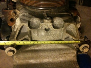

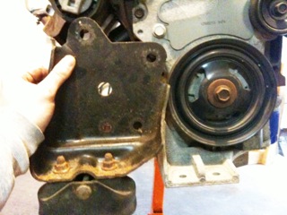

    Left Side Pic- the 3100 lower mount bracket. Not exactly sure how this mount without interfering with the crank pulley, am I holding it wrong?

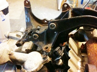

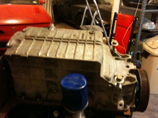

    Middle Pic- the a/c bracket against the LX9, not even close? wrong part? oriented incorrectly?

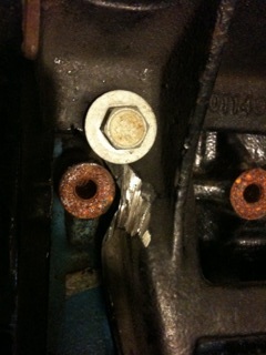

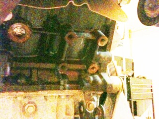

    Right Side Pic-, will the bearing mount for my getrag 284 intermediate shaft bolt up correctly to the side of the block?

    For that left pic, I don't know what to say. I've never even seen a mount that looks anything close to that. But for a couple other questions, I did a search through the 3500 sticky in the Performance section and found the following...

      If you want an easy fit, get a 1stgen w-body 3100 rear exhaust manifold to put the down pipe in the right spot. Then you can use a 3400 front and crossover.
      Oil filter adapter - you can remove the threaded adapter (?don't know what its called) on the end of the extension, remove the extension and screw the threaded adapter straight into the block and attach your oil filter straight to the block.
      1st pic - That looks like the automatic trans mount on the drivers side of a W body.
      2nd pic - I can't help you with the A/C but I think that the only A/C you can use is the one that came on the 3500. I never installed the a/c compressor or the passenger side upper mount. I just have one upper mount on the driver side.
      3rd pic - the holes are in slightly different positions. You will have to open up the holes your bracket to make it fit.
      About the passenger side lower motor mount. The engine mount bolts right on to the oil pan. Go find a 1stgen 3100 W in a junkyard and have a look at the mount and you'll see what I mean. There are two bolts on the side and one on the front right under the crank pulley. Looking at your oil pan, it looks like you have a different one than what I had. Can you take more pictures of it right below the crank pulley?

        It looks like my car, being a 91, leaves me in a tricky spot for the a/c compressor. I'd like to retain the original r12 compressor since it works great. Not sure what to do for this bracket.

          Do you have another picture of your oil pan? It doesn't look like what I got.

            I'll take a few pics tonight. I know the 3x00 oil pan is much more rigid than the stamped steel LQ1 pan, does the 3x00 have a bracket for a mount bolt to the pan? Wonder if my different looking pan is going to be another issue.
            I'm still not 100% clear on the lower engine mounts for the LX9. I've heard that my LQ1 mounts will bolt up but I'm not so sure
            Edit: when I picked the engine up at the scrap yard it was already out of the car (which I never saw) it was supposedly from an 05 Malibu.
            After reading the massive 3500 swap thread I believe I recall reading about the mounting bosses for the motor mounting being slightly different and the need to elong the bolt holes on the brackets. And I re-read your post and see that you wrote the engine mount bolts right to the oil pan. I know you said my oil pan looks different than yours but for sake of arguement, lets say they are the same, then would all I need be a 3100 lower mount? Does a 3x00 w car only use ONE lower mount on the passenger side? Problem is that I have never owned or seen the underside of a stock 3100, I'm only familiar with how the 3.4 dohc mounts. Do you have any pictures that I can use as a reference just to see how a 3x00 mounts?
              These are the best I have
              I've never had a 3.4dohc. Do you have that motor mount?

                Thanks for the pics, I think I see. On your setup it looks like directly beneath the balancer there is a bracket bolted to the oil pan and a mount to the bracket.
                My LX9 has a bracket beneath the balancer but a long time back someone indicated that this bracket would not work in a W car. So, they may still be correct, but in your setup it looks like a similar bracket. Did your LX9 come with the right bracket/mount on it or is that something you had to transfer over from a 3x00 equipped W car?
                The 3.4 dohc uses two lower mounts (the motor is still in the car so I don't have pics) Rather than a single one in the middle, like you have pictured above, it uses one on each side. And again, a long time back, someone said that I could use my 3.4dohc rear mount along with the 3x00 mount and have a pretty solid setup. Possibly negating the real need for the dogbones or at least getting away with only 1, after all the 3.4 dohc only uses a single dogbone.
                I'll take some pics of my oil pan tonight and hopefully we will be able to figure out whether or not the 3x00 lower mount will workout for me. Now, I'm REALLY hoping that my subframe has a provision for the 3x00 lower mount!

                3) The a/c bracket looks like it is going to be a pain. I can cut/weld and fabricate to an extent and I may end up hacking up that bracket that I have to make it work

                  The pictures I posted are just pictures of my oil pan. I don't have any pictures of the mount bolted to the pan. I would like to see some more pictures of your oil pan right below your balancer. From the one picture you posted earlier, it looks like your oil pan is different than mine.

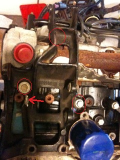

                      Here we go... I think this all is good news right now:
                      The oil pan, I removed the bracket from the Malibu and it looks like it will accept a 3x00 bracket/mount. The distance between the two bolts is about 8", does this look right? I'll have to get the bracket for the 3100 since the motor mounts seem not to come with them.

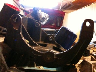

                      Now the other good news, I got the a/c bracket to bolt up. I had to cut out a spot from it where it hit a mounting boss on the block meant for the stock 3500 a/c compressor. Also had to bend up the heat shield on the manifold. 3 bolts hold it (circled in red), one into the head, and two into the block. This will be sufficiently strong to hold the a/c compressor but will it be strong enough to use the dogbone mount? I also need to consult my factory service manuals for the 91 to make sure that this bracket is correct for my a/c compressor. The last pic shows the "C" shaped part of the bracket where the compressor would bolt up.

                        Yeah, that (oil pan) looks like it'll work. The real test will be bolting the mount to it.
                        As far as the A/C, it also looks like it will work. I would say that those 3 bolts should suffice for the dogbone mount.
