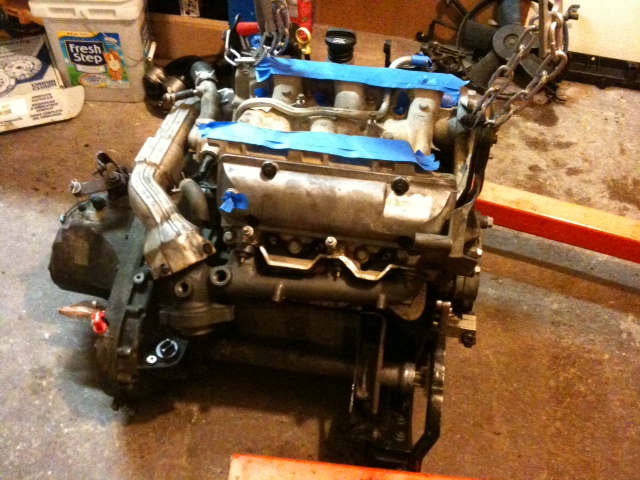

              Made some progress today.
              Mounted the clutch to the flywheel and the getrag to the engine.
              Also installed my 3x00 exhaust manifolds and crossover pipe. The ports on the manifolds seem to match the LX9 heads well but I notice the downpipe connection is not a ball and cone type and it seems a bit on the small side, I'd guess 2-2.25" I'm not sure if the smallish size of the manifold will hamper power much but I may end up welding a ball connection to the manifold just so it mates to my existing exhaust a little better.
              Tomorrow I will install the 'new' steering rack and then hopefully drop the engine/trans into the cradle. From there on it will be accessories, wires, hoses, etc.

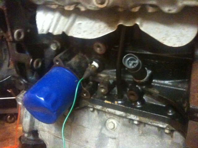

              One questions... the below pic is the oil pressure sensor and I'm not sure if it is in the right place. There is no 'port' for it near the oil filter. The reason I put it there was because the LX9 came with a nearly identical sensor installed in that port, the connector was just a bit different, a 2 pin I believe. I think it is right and the 2 pin is for an idiot light whereas my GP has an oil pressure gauge.

              And today's progress:

                You know, I can't answer that question about the oil pressure. I used that spot and I get a maxed out reading on my oil pressure gauge. But, I redid the wiring harness in my engine bay so I may have forgot to ground that sensor or something.

                  I guess the oil pressure sensor will be a wait and see.

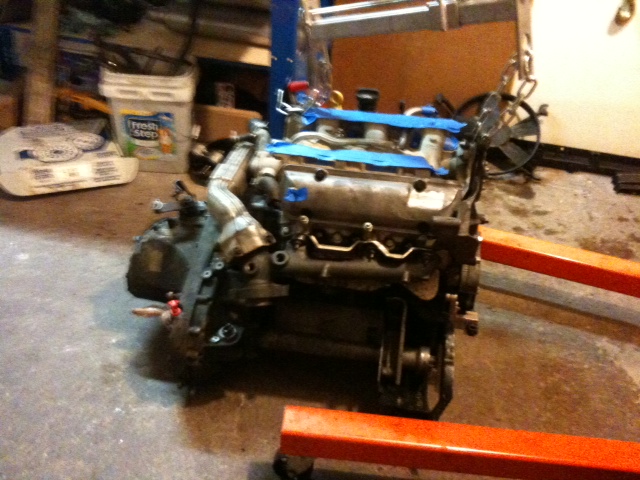

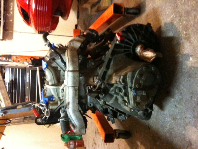

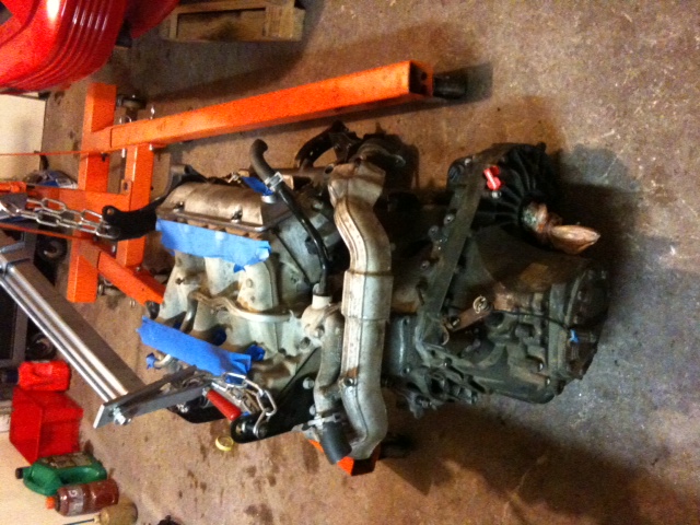

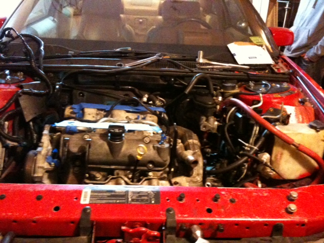

                          Progress today, engine and trans are bolted into the car.

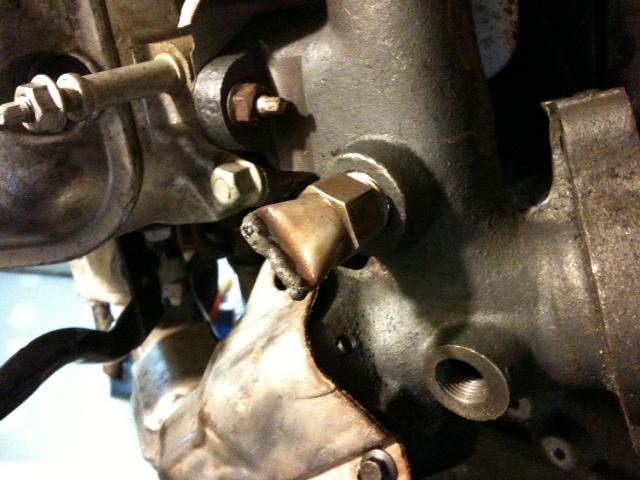

                          Also found that the fitting on the air tube from the dohc motor threaded into the egr port on the 3x00 manifold. So I cut the pipe off, pinched it closed, welded it to prevent leaks, and threaded it in.
                          Now, its a matter of hoses, wires, axles, downpipe to manifold, plenum/injectors/throttlebody, etc. etc. etc.
