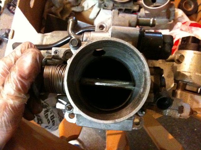

                  Turns out you can mod a 96/97 3.4 DOHC throttlebody to bolt up without an adapter plate. I had to do some cutting, grinding and drilling but it lines up and bolts on. In the pic you can see the bores are a millimeter or so off, but since the pic was taken I took a die grinding/cutting bit to the manifold and opened up the TB hole enough so that there is no longer any overlap.
                  The only thing that isn't perfect is that the 3.4 TB is exposed on the backside where there are ports that see full vacuum - meaning without something to seal them off I will have a giant vacuum leak. My plan is to cut a gasket from a rubber gasket sheet and just leave that part intact to seal the area. I'll have to use some silicon to ensure it seals and the top bolt hole on the dohc TB can also be used to secure the gasket since it is not used to bolt onto the manifold.
                  I washed the manifold in the kitchen sink afterward to clean the aluminum shavings but after I dried it (in the oven, I can get away with that when my girlfriend is not home) I could see that shavings were still in the ports. Back to the garage to use compressed air to clear it, but still the shavings were not all gone! Finally, I went to shower...and I took the manifold with me! I used the high pressure setting on the removable shower head (the thing with the hose, I don't know what its called) and that seemed to do the trick but its getting compressed air again before going on the car.

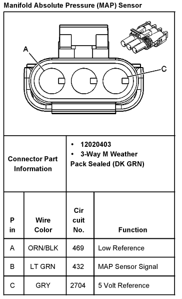

                    Did you figure out anything with the MAP pinouts? I'm looking at using the smaller MAP sensor instead of my 03 style MAP.

                      The new small size MAP sensors are labeled on the back! GM made this easy for us. The pins are labeled Gnd, Out (which is signal) and 5v. So now I know the correct pins on tne new map and can match the wires up easily. I don't know what the wires on my harness are but I can easily reference my factory service manual for that information. So, yes I did figure it out but I haven't wired it up yet. I'll take a pic of it showing the labels in case yours doesn't show it.

                        I did find the wiring for the MAP connector for my '03. Looks to be the same, just need a harness adapter.

                          I have connector kits for the new style MAP sensors in stock. If your wires are long enough, it's easy to cut the old connector off and install the new one.
