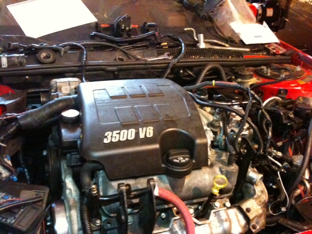

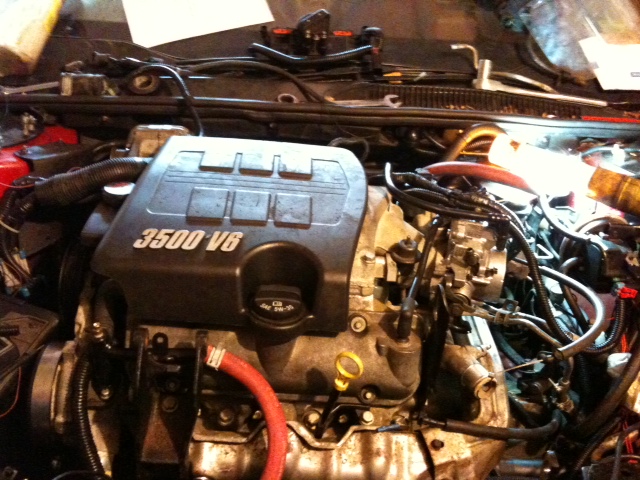

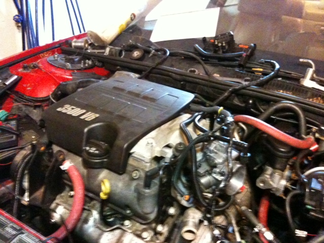

      IT RUNS. Finally, I started it up. I just couldn't wait anymore and there is LOTS left to do but all the essentials were there to make it run. I didn't burn the LX9 bin I have yet but it fired right up on the dohc code. Don't have the tach wire hooked up so I couldn't say where the revs were for sure but it sounded to run a bit high, granted the IAC is set to start a LQ1 with a lope and I just capped off the brake booster port and TB vac connections so I may have had a small vac leak. No exhaust on it yet so this thing was pretty loud! Other than that it sounded smooth, didn't smoke, and fired up on the first try. No immediate CEL but I ran it for only a matter of a few seconds, literally, because it didnt have any water in it. I still have lots of odds and ends to finish up and I really want to redo the wire looms - I bought some OEM grade non-adhesive wire harness tape on ebay so I'm waiting on that as well.
      Anyway, some pics as promised.
ID:	376605 Click image for larger version
ID:	376604 Click image for larger version

        You could have run it longer than a few seconds with no water. Good deal that it started on the first try though I fired up the 92 with just the manifolds when I was "fixing" the cat and had the exhaust off- downpipe and all. That thing was loud... It was also up in the air on jack stands about a foot and a half in a garage with a smooth cement floor. I could read my friends lips saying it was too loud, then I reved it to about 2k rpms, lol. That thing sounded like a full blown race car with the lope and no exhaust, lol. Call me hillbilly, but it I got a kick out of it. So yeah, I guess I am nuts
