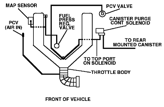

                        #101
                        Using this picture as a visual groundwork I'd like to take things one step at a time and try to figure out the best way to run all the vac hoses.
                        Here's a list of necessary components:
                        #1- pcv valve /hose - Solved
                        #2- MAP vaccum hose/ mounting bracket-Solved
                        #3- HVAC hose- Solved
                        #4- Brake booster hose- Solved
                        #5- FPR hose- Solved
                        #6- Purge Solenoid thingy vacuum hose/mounting
                        #7- Valve cover breather - Solved
                        #8- EGR valve- Solved
                        Let's start with the one's that I know already.
                        #1. PCV valve. Without going into much detail I can explain what needs to happen. The RWD and FWD setups are completely different as far as PCV valve is concerned so I will have to purchase the FWD vaccum hose that runs from the passenger side valve cover (where the PCV valve is located) to the top hole located just above and behind the throttle body on the upper intake. I will need to also buy a new pcv valve. This is a done deal.
                        PCV- Check
                        #4- Brake booster hose- On the RWD intake the booster hose comes to the "T" at the very rear of the upper intake and fits onto the larger of the two metal tubes. On the 3400 the brake booster line runs to the right side of the upper intake where the "black plastic" tube is. This tube looks to be almost the same diamater as the RWD one and I know for a fact thatt the booster hose will have proper length to reach over to it. Therefore all I need to do is run the old hose to the new "black plastic" inlet on the 3400 UIM. Therefore, this is also a done deal.
                        Brake Booster -Check
                        #3 Hvac Hose- On the 3.4 RWD there is a small vacuum hose coming out of the wiring harness at the very back of the motor at the firewall. This hose fits into the "smaller" metal tube on the metal "T" located at the rear center of the intake. The only possible port to tap into is the far back right inlet that currently on the 3400 UIM is "plugged" with a small rubber nipple. The pipe is a "little" smaller in diamater than what I would have liked but if you look at the 3400 UIM, there simply is no other tube close by to tap into. I may have to cut the vacuum hose out of the wiring harness but I don't see why it shouldn't reach that port with a little elbow grease. We can then therefore consider the Hvac hose a done deal.
                        Hvac Hose- Check
                        #8 EGR- I have to mention it since it has an inlet on the UIM. But this will be a non-issue since I've purchased the EGR block off plate. 2 bolts later and we can consider that gaping hole next to the throttlebody a DONE DEAL.
                        EGR- Check
                        Now, after all this, things get hazy. So let's start by figuring out the valve cover breather tube. ON the 3.4 RWD the breather tube comes out of the passenger side valve cover and runs all the way to the rubber intake elbow in front of the throttlebody.
                        So does the 3400 have a valve cover breather tube? I'm pretty sure I've seen pics of a tube going into the top of the rubber intake elbow just before the TB but I have never seen where that hose comes from. Is it the driver's side valve cover? (or what would be on the FWD the REAR valve cover)
                        My options could be something as simple as putting a filter onto the breather hole (if one exists) and then just plugging up my current intake elbow inlet since it is no longer necessary.
                        So who knows anything about the location/routing of the valve cover breather tube on a 3400? We'll start there.

                              #104
                              found something useful
                              93 Firebird 3.4
                                #105
                                you may find this useful?
