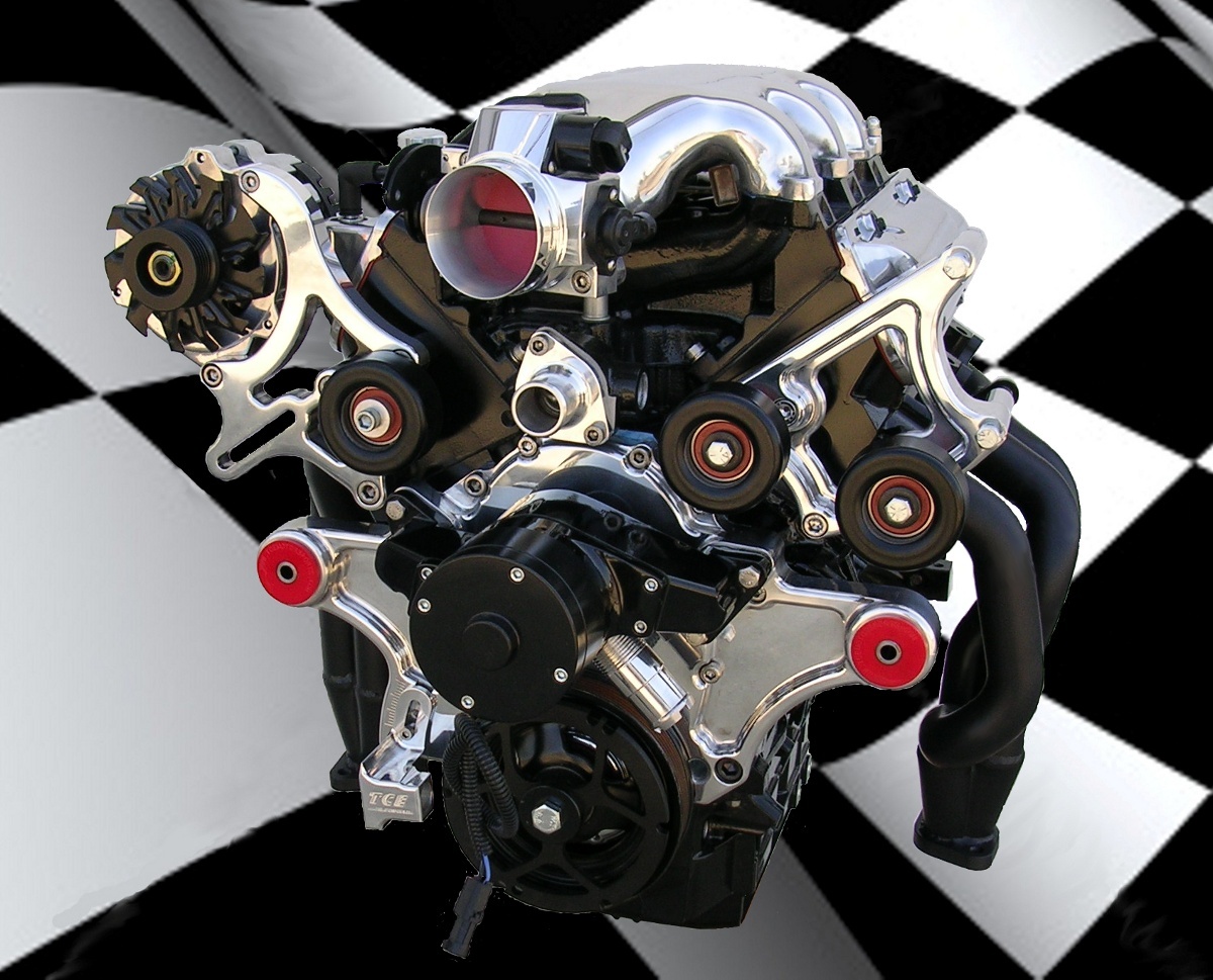

                            Purple power works very good to remove grease and crud but doesn't get off the corrosion. PP will burn/discolor aluminum if you let it sit too long.
                            For corrosion removal, we buy gallon jugs of A/C coil cleaner and it works pretty good. I have also had decent luck using Eagle One etching wheel cleaner. Mothers used to make some that worked great but no longer offers it. The coil cleaner and wheel cleaner contain acid so handle with care.
                            I don't know what kind of look you are going for or the amount of time you want to spend but you could always cut off the EGR passage and weld any unwanted holes up for a cleaner look. It's slow dirty work but the UIM and valve covers can be polished as well. We milled the top of this UIM flat before it was polished as the owner is going to have a Healey logo engraved on it.

                              #149
                              @CNCguy
                              Amazing detail, gorgeous engine.
                              That would look so nice in my car but I don't have the cash flow to run with the big dogs
                              "It's your car. Do with it what you wish, but as you enter this unknown world you will need to invent the wheel all over again. For the adventurous and those that are backyard mechanics who have nothing but time you might like this. Most have plenty of frustrating moments and the process usually takes significantly longer then what anyone could imagine. The end result of this conversion is completely up to you." - Jon McCullough of BMCautos.com
                                #150
                                That right there is some nice car-porn. It's polished so nice it looks chromed I bet that took a good long while to do.
