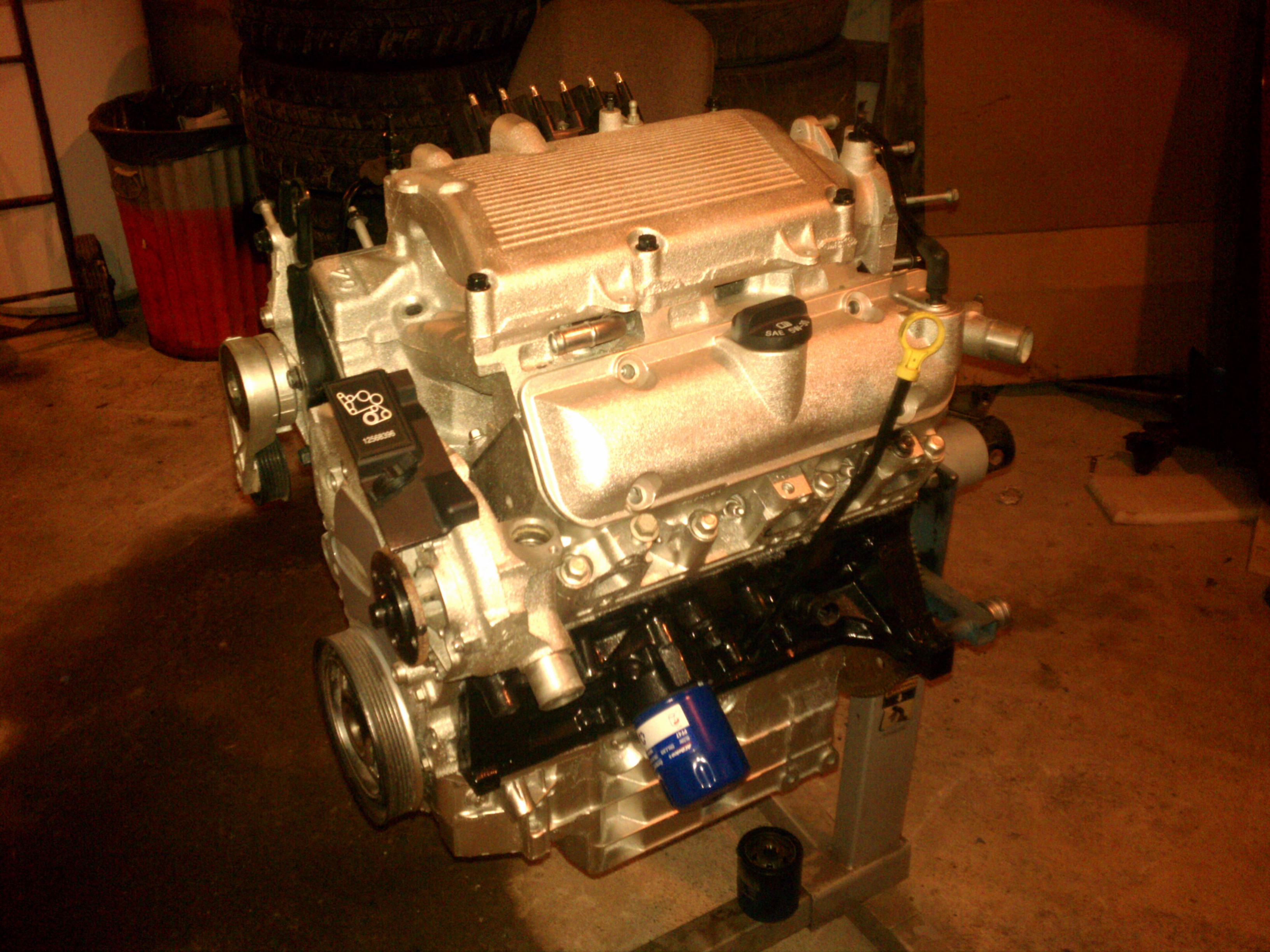

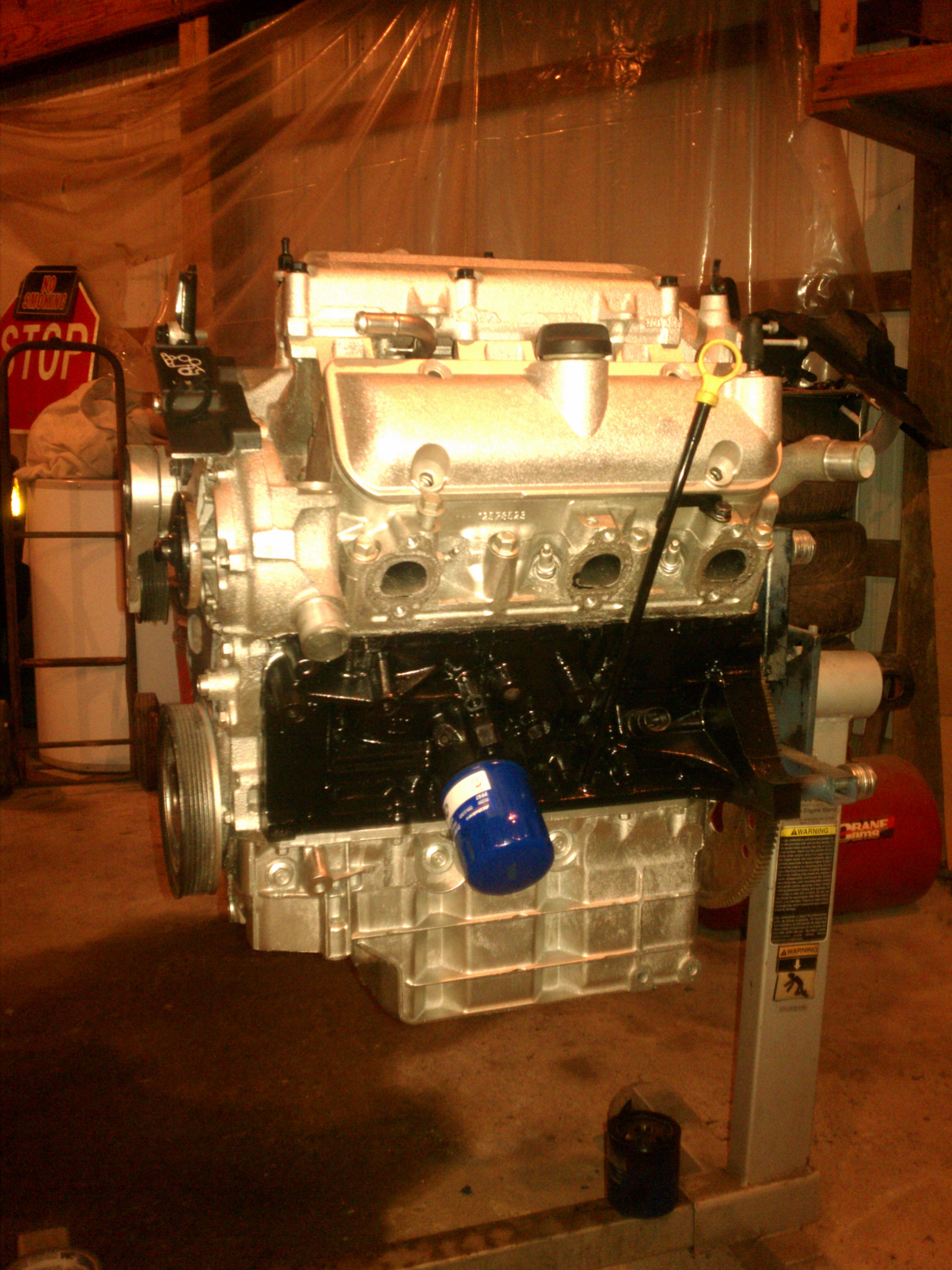

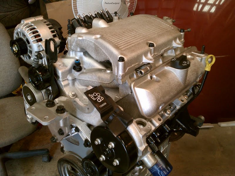

      Ok, most of us have seen a three-five. This one doesn't look too different from the rest, especially without it's shinny CNC aluminum parts yet. It's hard to capture the true color of the aluminum parts but they're not new metal pieces. Everything's been painted either gloss black or Toyota Almond Beige Pearl. Matches the interior's tan/biege colors and flows with the Ruby Red Metallic paint.
      Picked up some end-of-the-list stuff today like the new (reman) alternator, Mobil 1, PF47, Dex Cool, and Bosch wires. I'd really love some Packard wires but there are budget contraints.
      Still waiting for my PCM from MMS as well as the trigger, tb, icm, and a/c adapters. Injectors on their way, ordered my 65mm tb and sent out the core today, and tomorrow comes the over $200 GM parts order of mostly engine sensors.

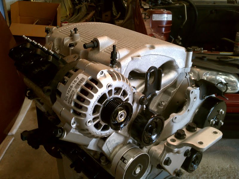

        I know, I'm beating a dead horse here but, here's some more. Had to tape all the idividual cooling holes on the alternator to make it look llike it was disassembled for paint. Took a little while but well worth the "professional" results. Delphi 28# injectors came from WOT-tech yesterday, they look lonely next to the Fel-Pro gaskets on the shelf of LX9 parts.

            Wow....that looks great. I've been wanting to paint mine too and you've given me some ideas there, but I'd probably go with black on the oil pan.
            I do have some questions for you since I'm doing the 3500 swap also:
            1) How did you mount your oil filter like that which is more like stock location for the 3400?
            2) What are you going to do for a PCV valve since you're using the stock 3500 valve covers with no PCV valve hole?
            3) What are you doing for the EGR valve tube differences?
            4) What are you using for exhaust manifolds? The stock 3400 exhaust manifold ports are smaller than the stock 3500 exhaust manifold ports.
            5) If you're running 28# fuel injectors, how are you adapting the stock wiring harness connectors which are different?

                        Re: Oil filter adapter
                        1) The three-bolt adapter on your 3500 can be removed and a filter can be fitted directly to the block, like the 3400. First remove the spindle (filter threads) from the adapter with a 10mm allen wrench/socket. Next you can remove the three 10mm bolts from the perimeter of the adapter. This will allow you to remove the adapter and the aluminum/silicone gasket behind it. Rethread the spindle into the block and spin on filter for original 3400 performance.

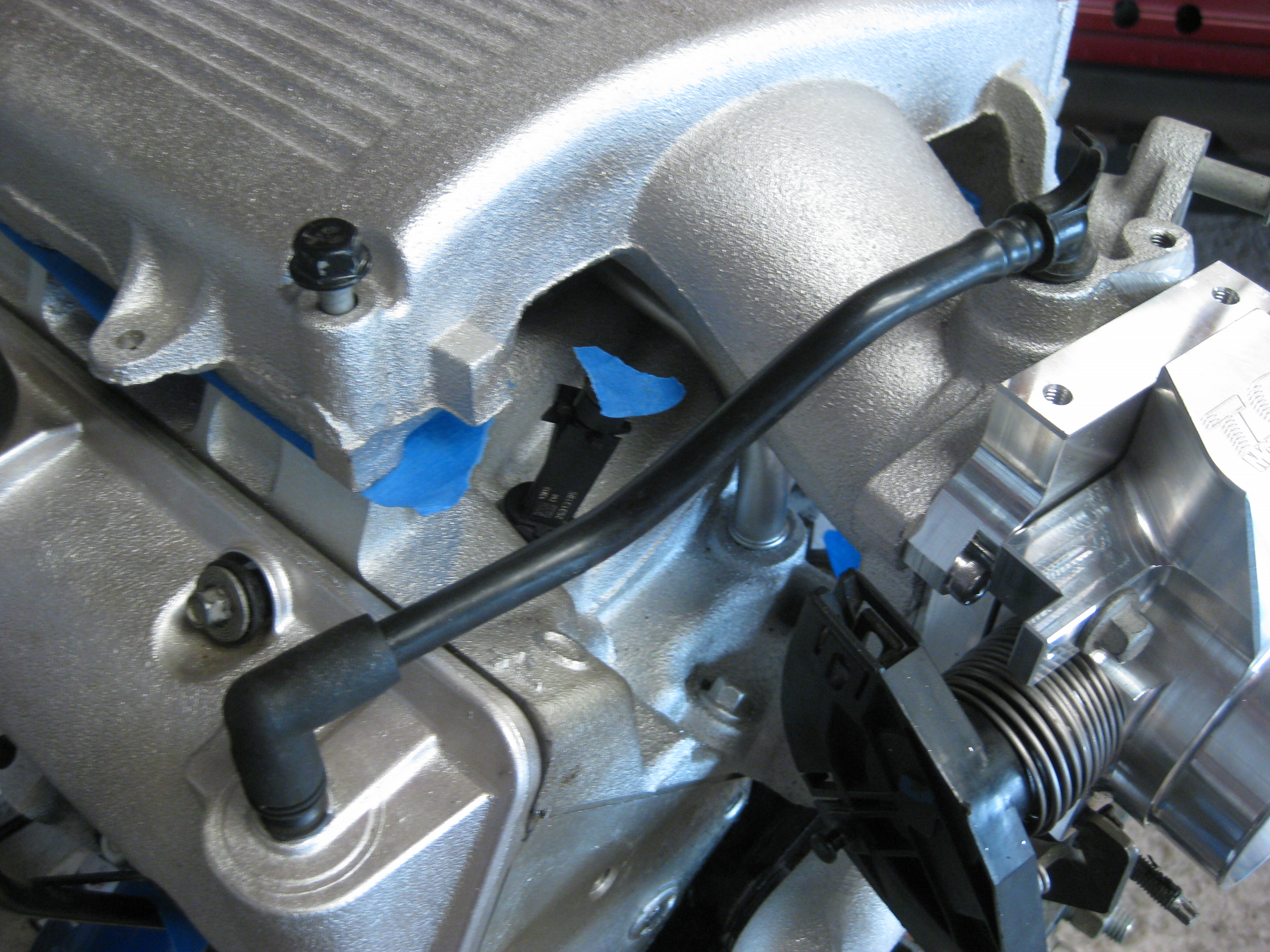

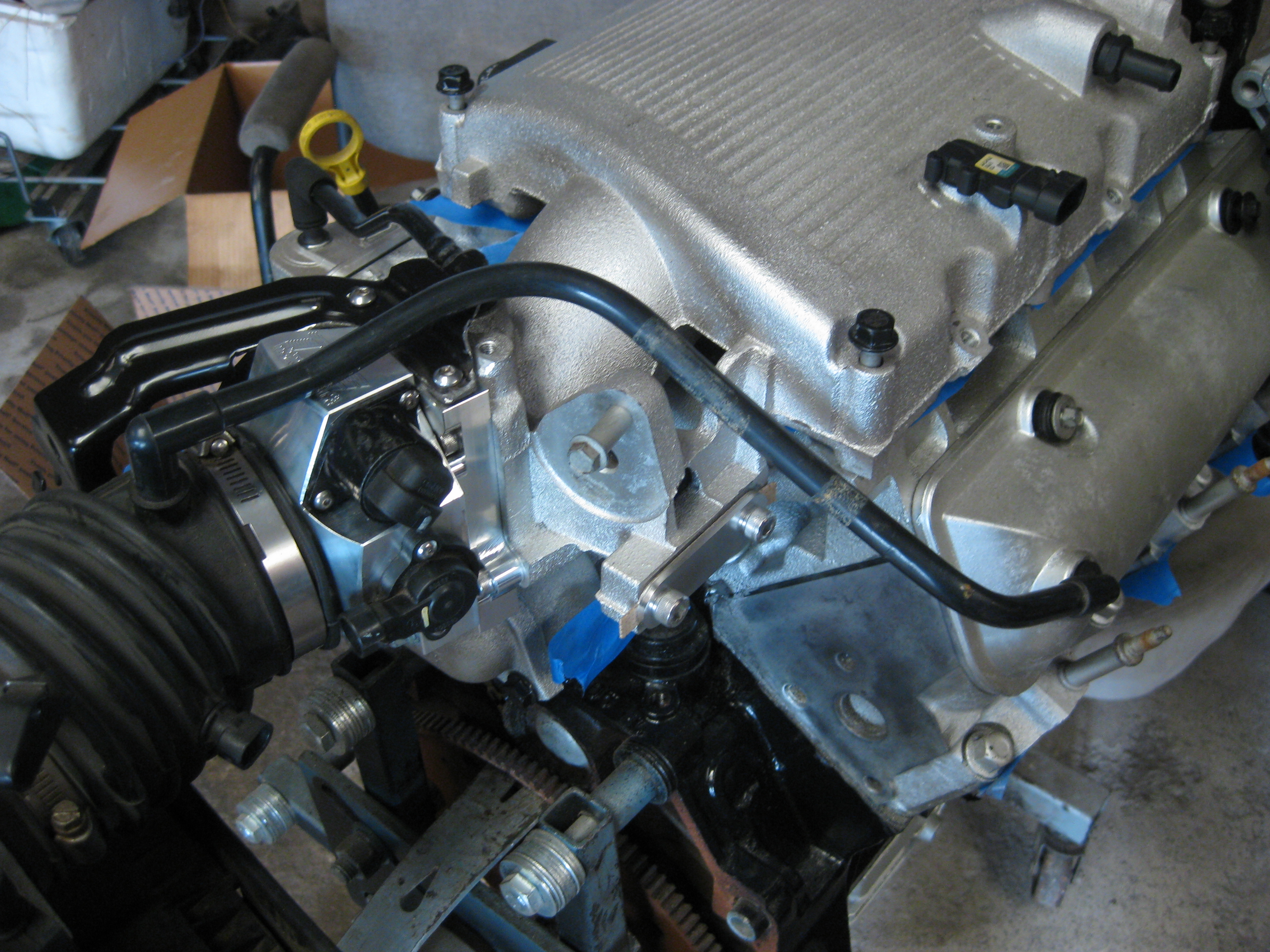

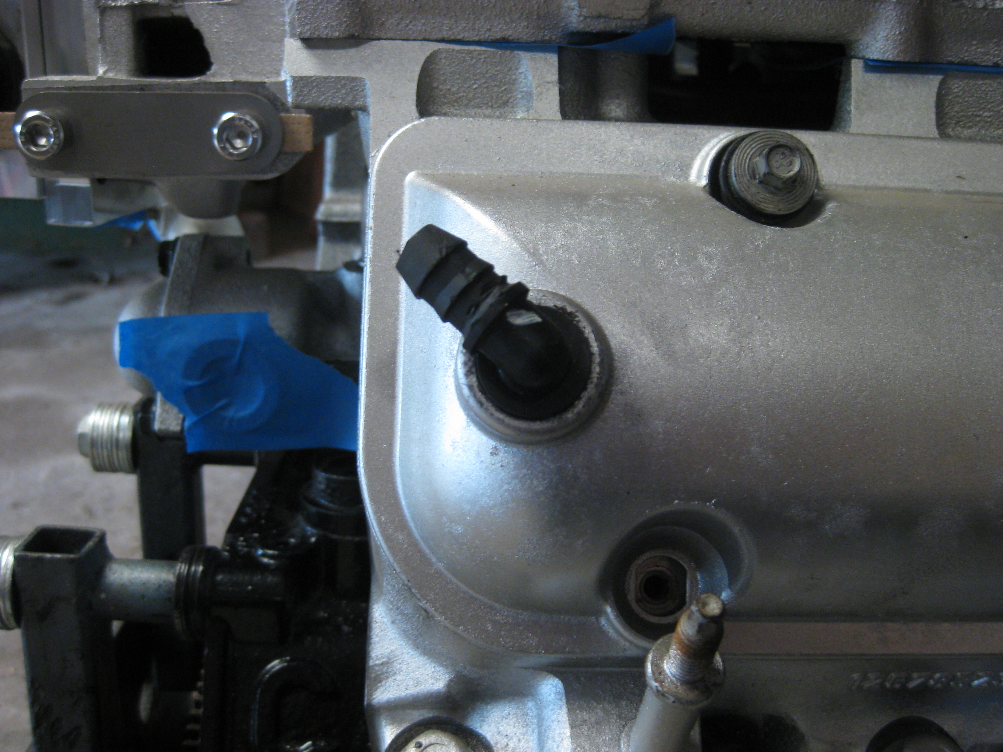

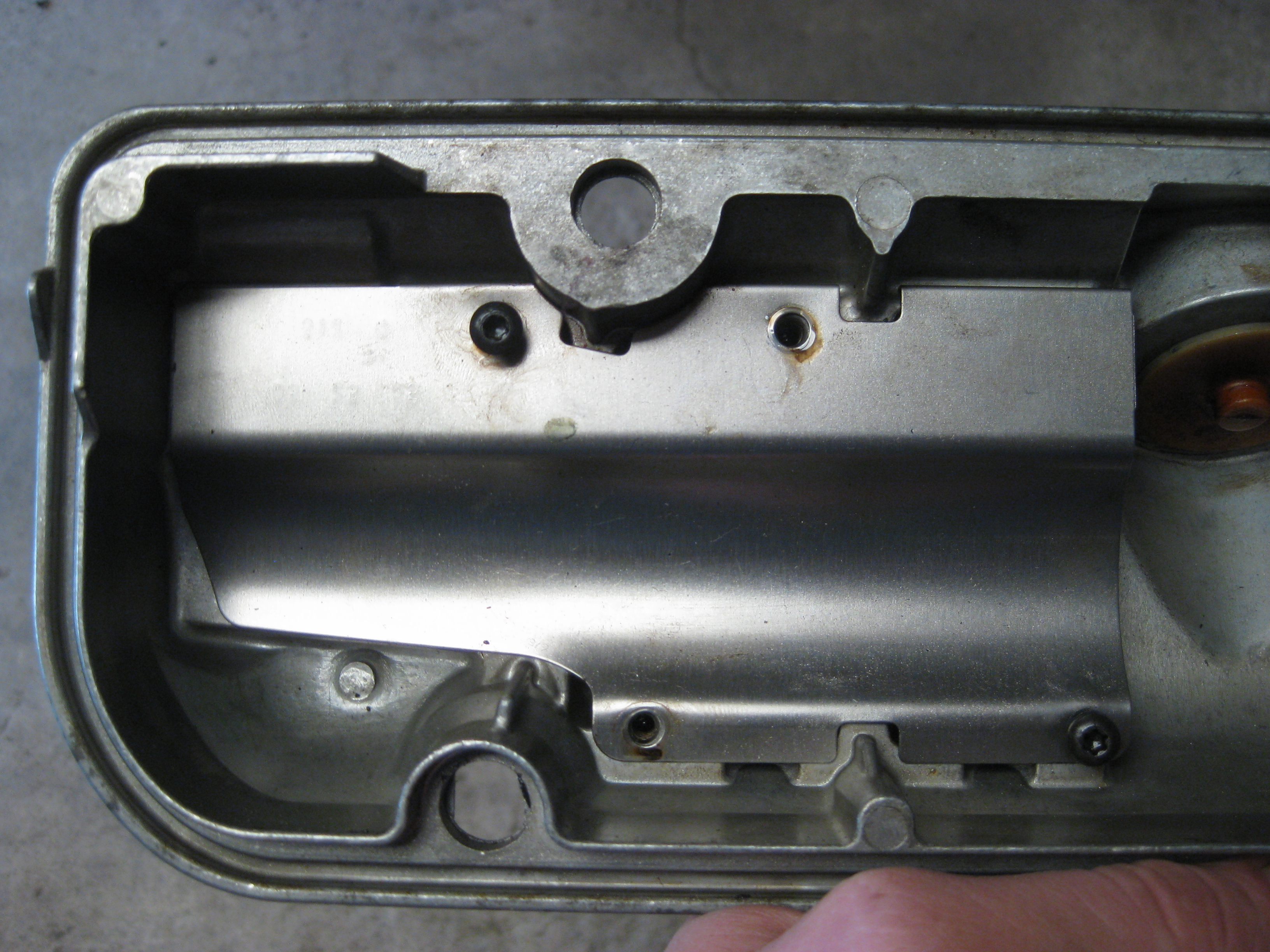

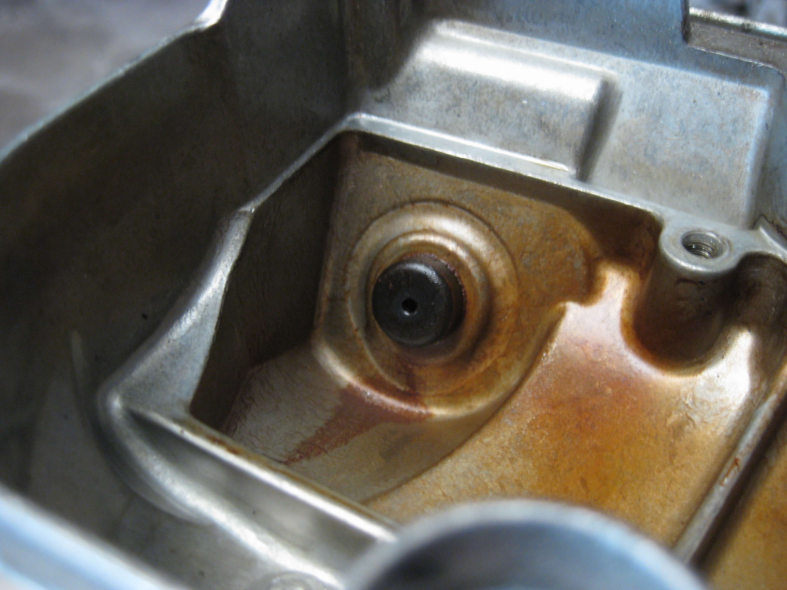

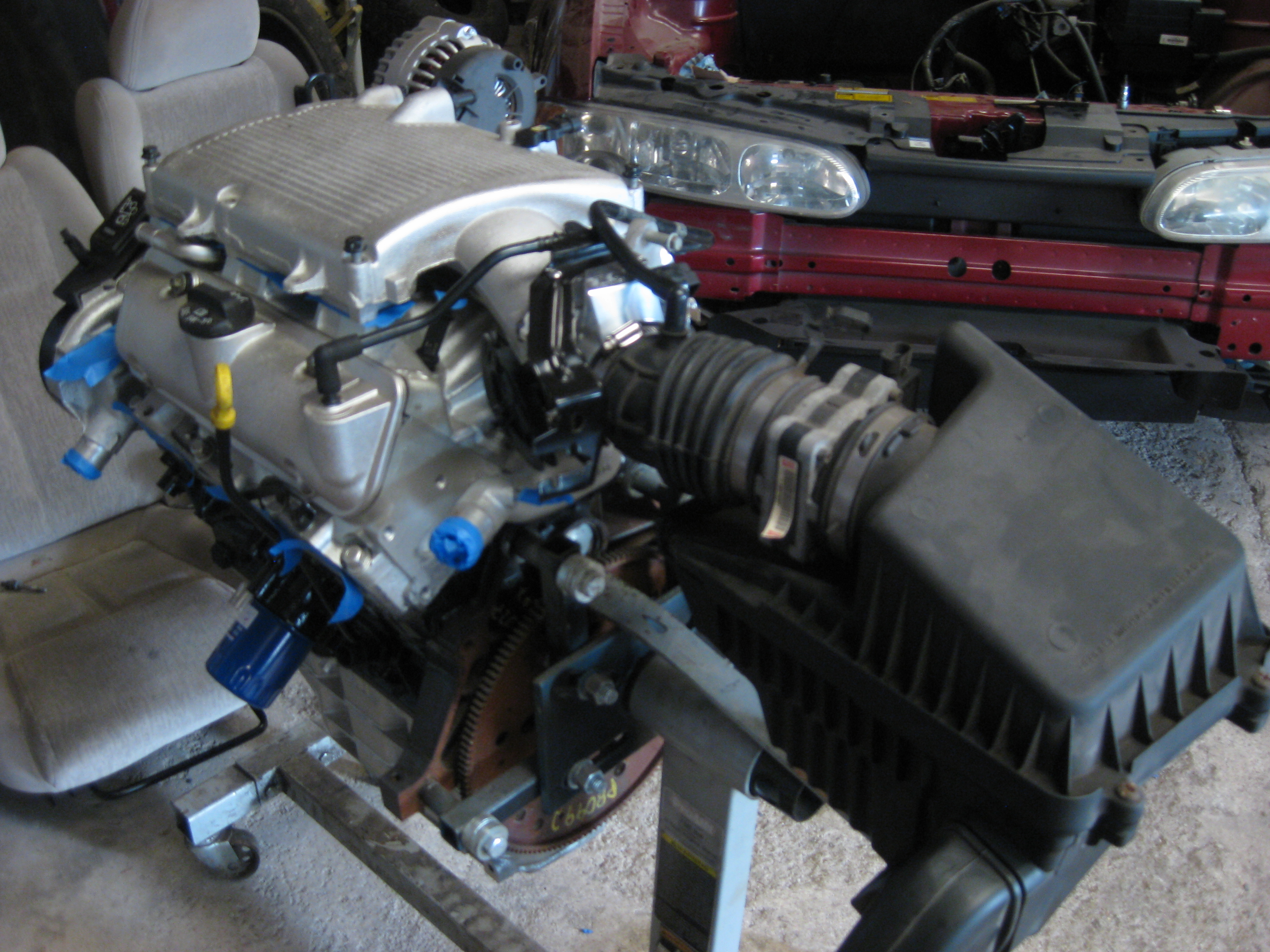

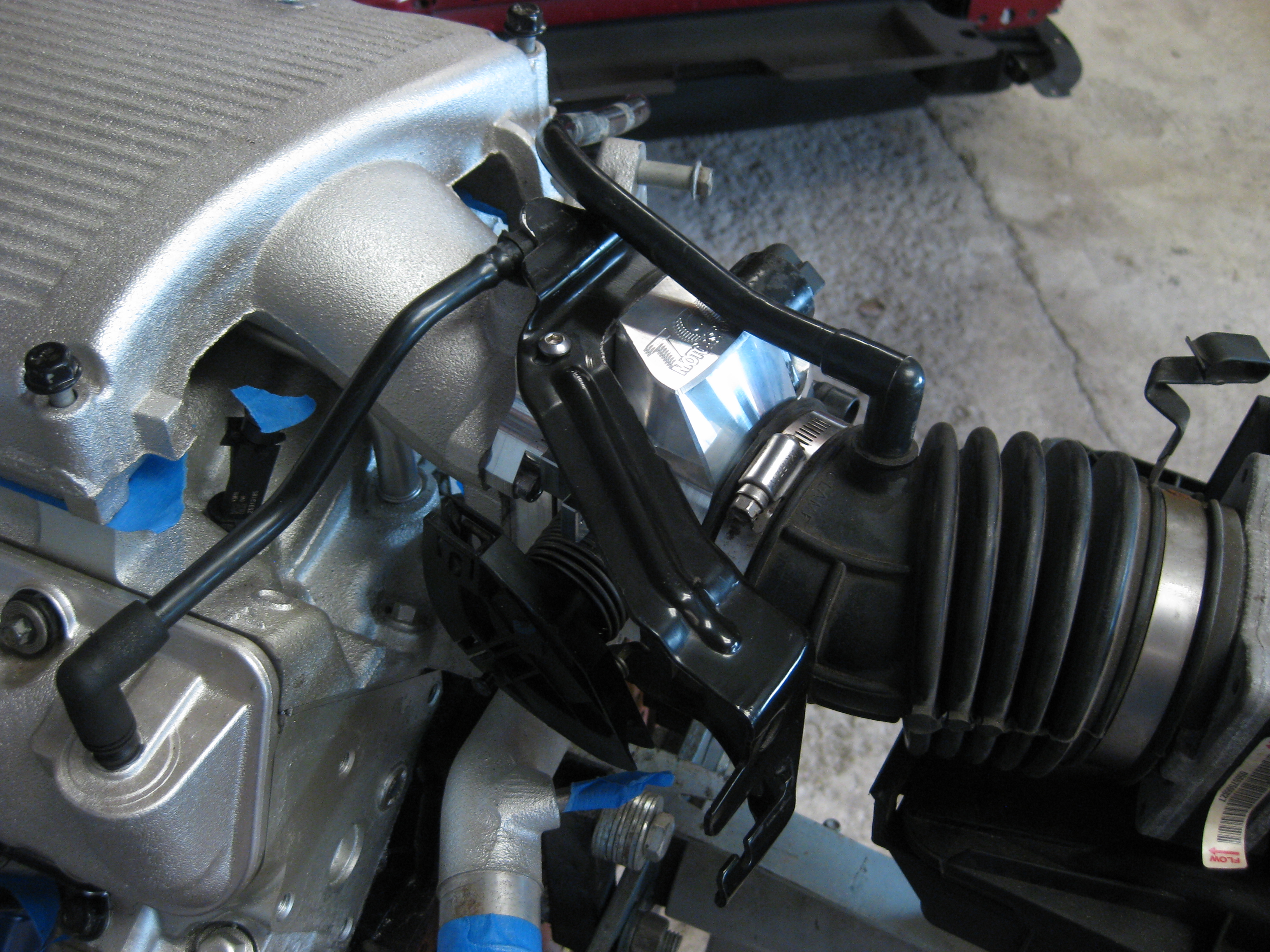

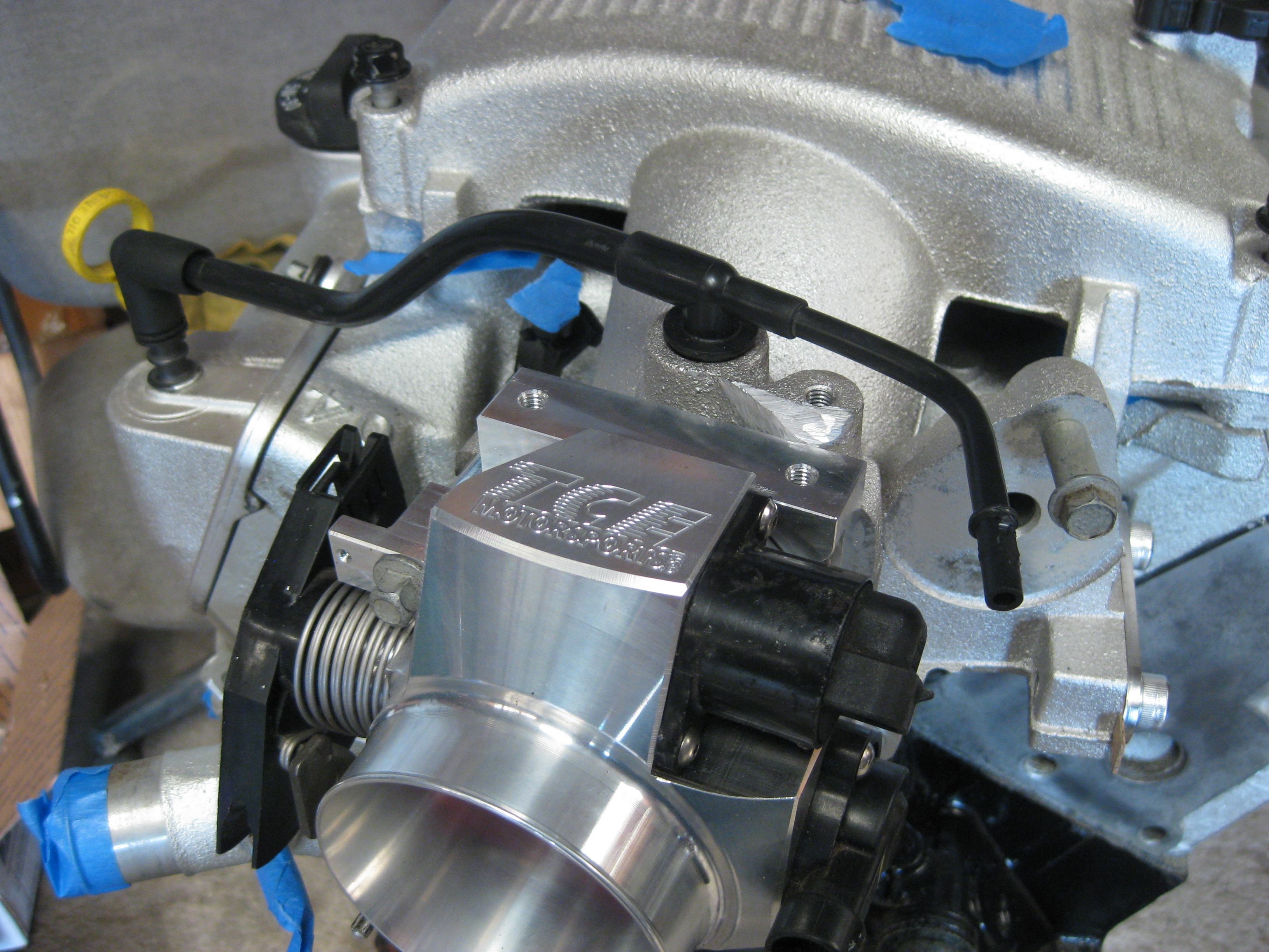

                              Time to touch on the LX9 PCV operating issue. I snapped some pics of the components and how the system is constructed for those that asked.
                              Photo #1 & 2 show the inside of 3500 "front" rocker cover, both with it's baffle installed and then removed to show the orifice to the valve itself. GM did something similar to this on it's LS series engines. Early Vortec engines consumed too much oil so an updated PCV valve with a 1/16" orifice was implemented and reduced oil consumption.
                              Photo #3 & 4 are of the 3500's original PCV components and routing. Like everyone else, there was a short line from the PCV valve to the intake plenum, just like the 3400. The "rear" rocker cover had only this nipple installed upon pickup. My assumption is the remainder went with the crashed car and therefore I cannot show you exactly what it looked like originally.
                              Photo #5 shows the original 3400 PCV line with the provision for the remote mount EVAP purge valve. If you're reusing the 3400 EVAP purge, you'll benefit from using this line.
                              Photo #6, 7, 8 show my future PCV routing. I decided to use the original 3500 "front" rocker cover PCV line to the orifice behind the throttle and the original 3400 "rear" rocker cover vent line to the original 3400 intake assembly. Some modification was necessary to the fitting that inserts in the plenum so it would clear the throttle cable bracket enough and allow it to do it's job and retain the PCV line at the same time.
                              BTW, previously I read somewhere that it was IMPOSSIBLE to reuse the stock intake assembly on the aftermarket throttle body because of it's inlet shape change. My only resolution was to use aftermaket silicone or I had thought of using the LX9 rubber but it's just that, rubber. It will go whatever shape I want it. And it's not that much of a delfection in the rubber and clamp where the clamp can still work as designed.
                              More photos of parts and details to post later, hope this helps if anyone had questions!

                              • jmgtp
                                • 1219
                                #30
                                Yah, thats the exact PCV setup mine came with. Dunno why mine sucked oil. Dunno if the fact that it was running on 5 cylinder due to a pushrod that was installed incorrectly somehow caused it. Now that the pushrod issue is corrected I may try taking the pcv valve I installed and see what happens.
                                Side note, I used a bone stock 3100 air box and intake tube. I threw the intake tube in the oven for about 15 minutes at ~200 degrees. It softened it enough that I was able to massage it onto the 65mm LX5 throttlebody.
