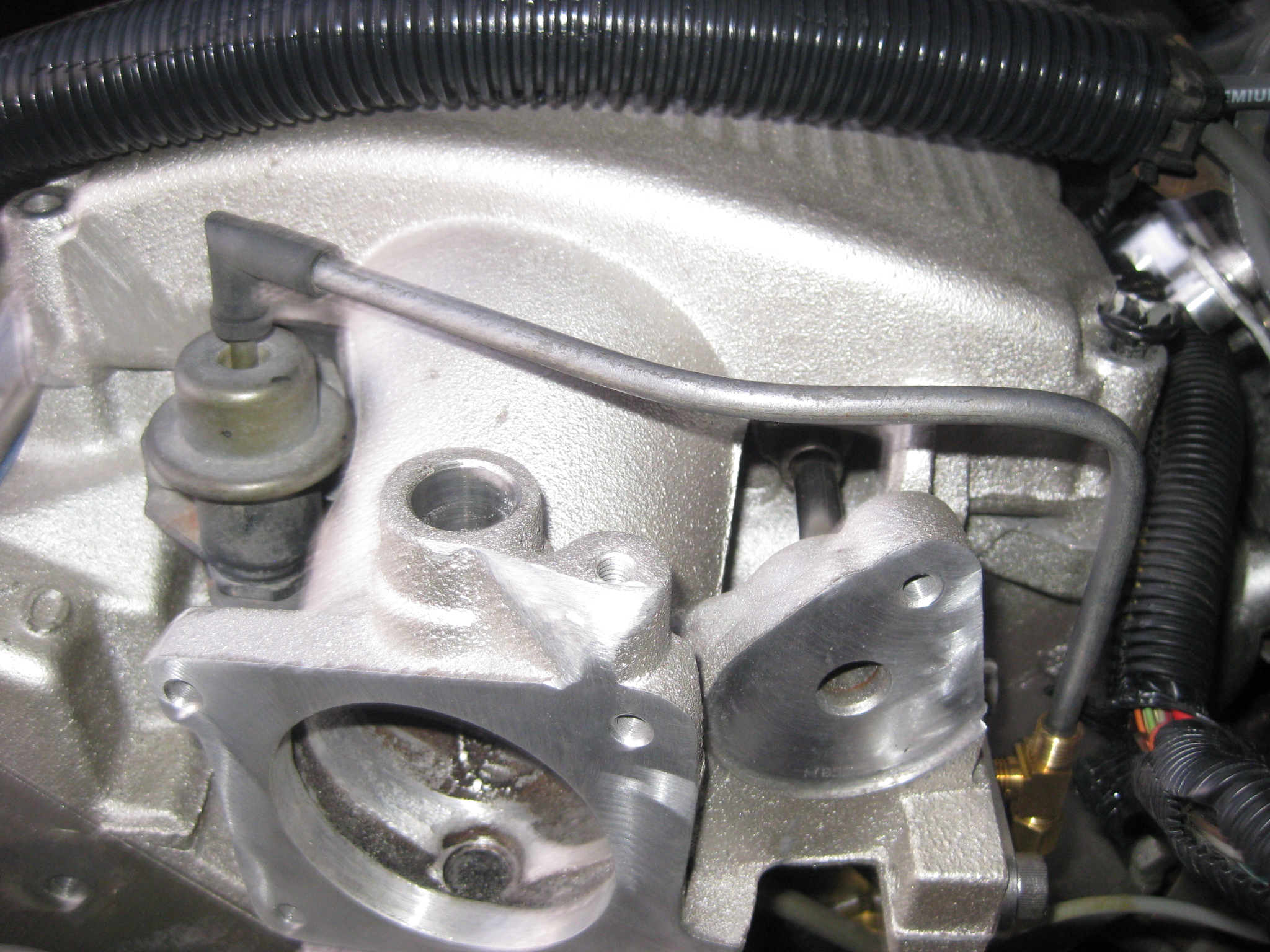

                  You'll probably notice right away that everything top end has been removed, again. If you've been following, I ground most of the flashing off the upper intake to dress it up some, but left myself unsatisfied with the finish. So being I plan on doing more engine mods down the road, I decided now was a great time to port the runner openings. It saves me money with the tuner's and being they're done on the exchange process, I didn't want another OEM plenum back.
                  I also decided to tackle the vacuum situation now as well. Not that I rely on the forums to solve my problems, but I scoured the pages to see what I could find, and I saw a lot of folks taping the EVAP port and installing a barbed fitting. I don't like the idea of just rubber hose, it looks cheap and I couldn't do that 'cause I'm using the OEM LX9 EVAP valve. So after many nights losing sleep, thinking about a clean solution, I came up with this.
                  I wanted it as hidden as possible, and run the shortest lines. After removing the EGR block off plate supplied by Milzy, I drilled a hole in the stainless and borrowed a 3/16" pipe tap, ordered a compression tee from my local NAPA (only real parts store around here), and it fit! I'll probably drizzle some thread lock to ensure a leak free seal. The FPR source is up top and as you may see, the ghost gray plastic hose that lies at the bottom is the HVAC line which will run out of the bottom of the tee. All you'll see is the one hard line from the FPR to the EGR plate. It will probably wear paint, not sure what color yet.

                    Looks good....I can't do that on mine because the EGR needs to be in place for state emissions inspection. What are you using the 3500 EVAP for and how are you going to connect it electrically?

                      Considering the vacuum supply isn't near completion yet, it's good to hear compliments already, thanks Starglow!

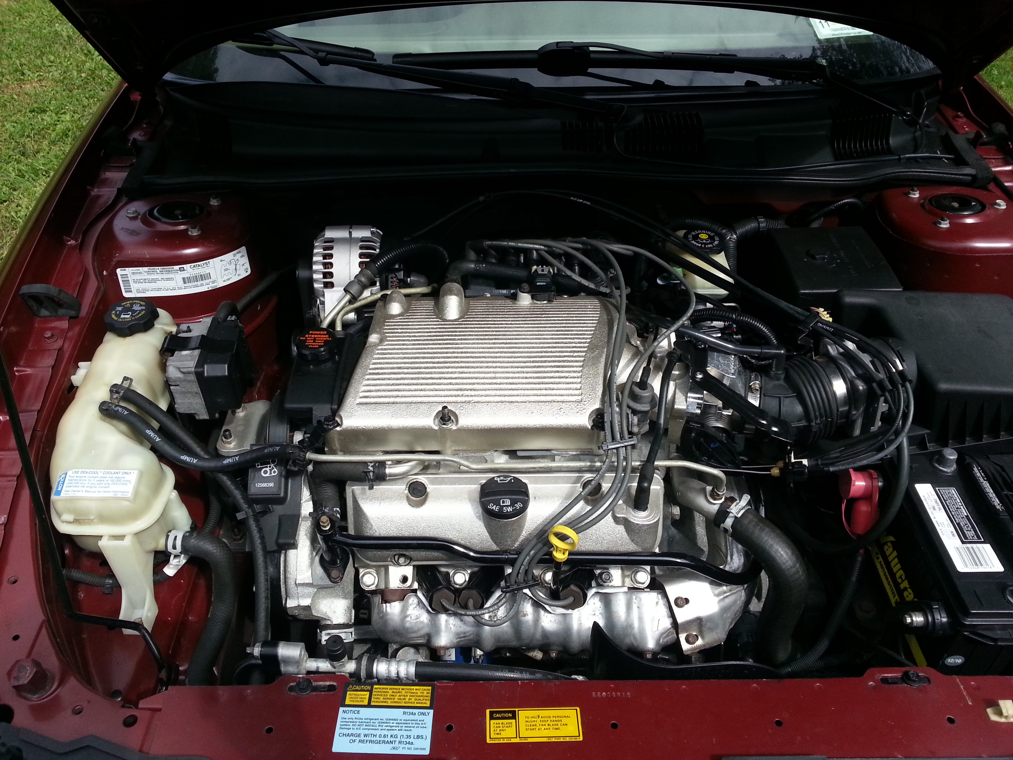

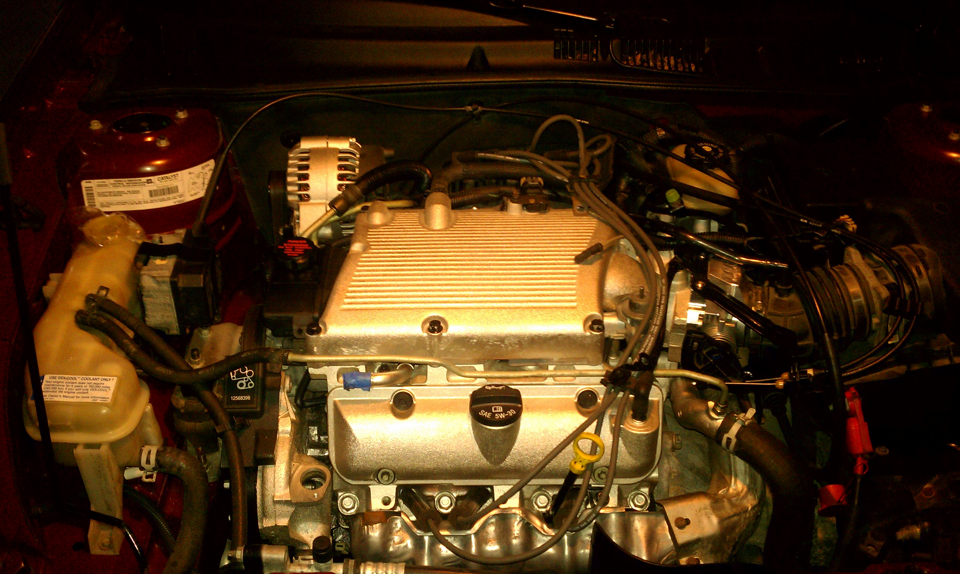

                            This is my favorite photo so far. It's wearing last year's 15's, side mouldings and no GM squares on the fenders.
                            This is the engine finished for last year. It looks a little different now and it doesn't run the OEM air box anymore. You'll see more later.

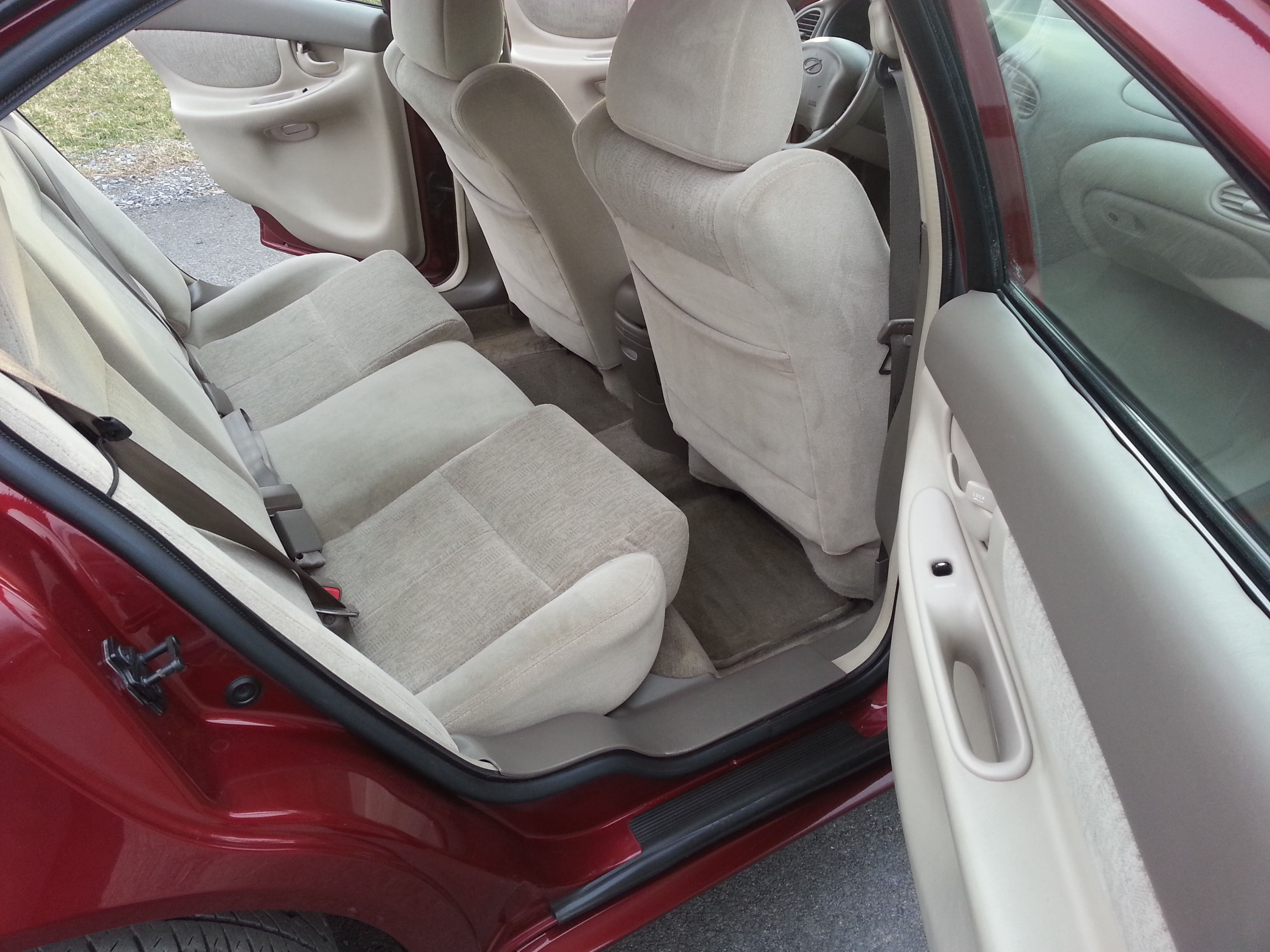

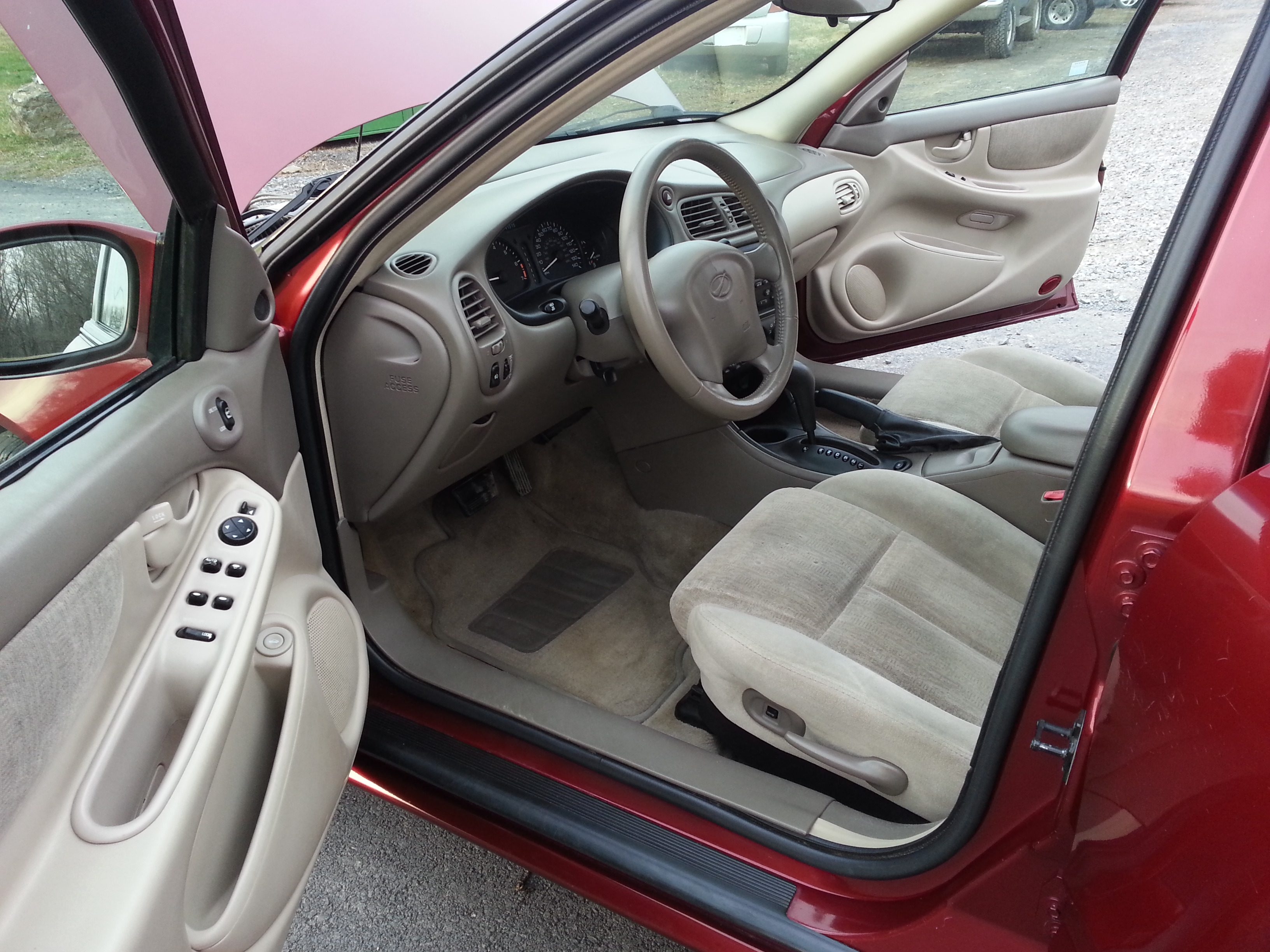

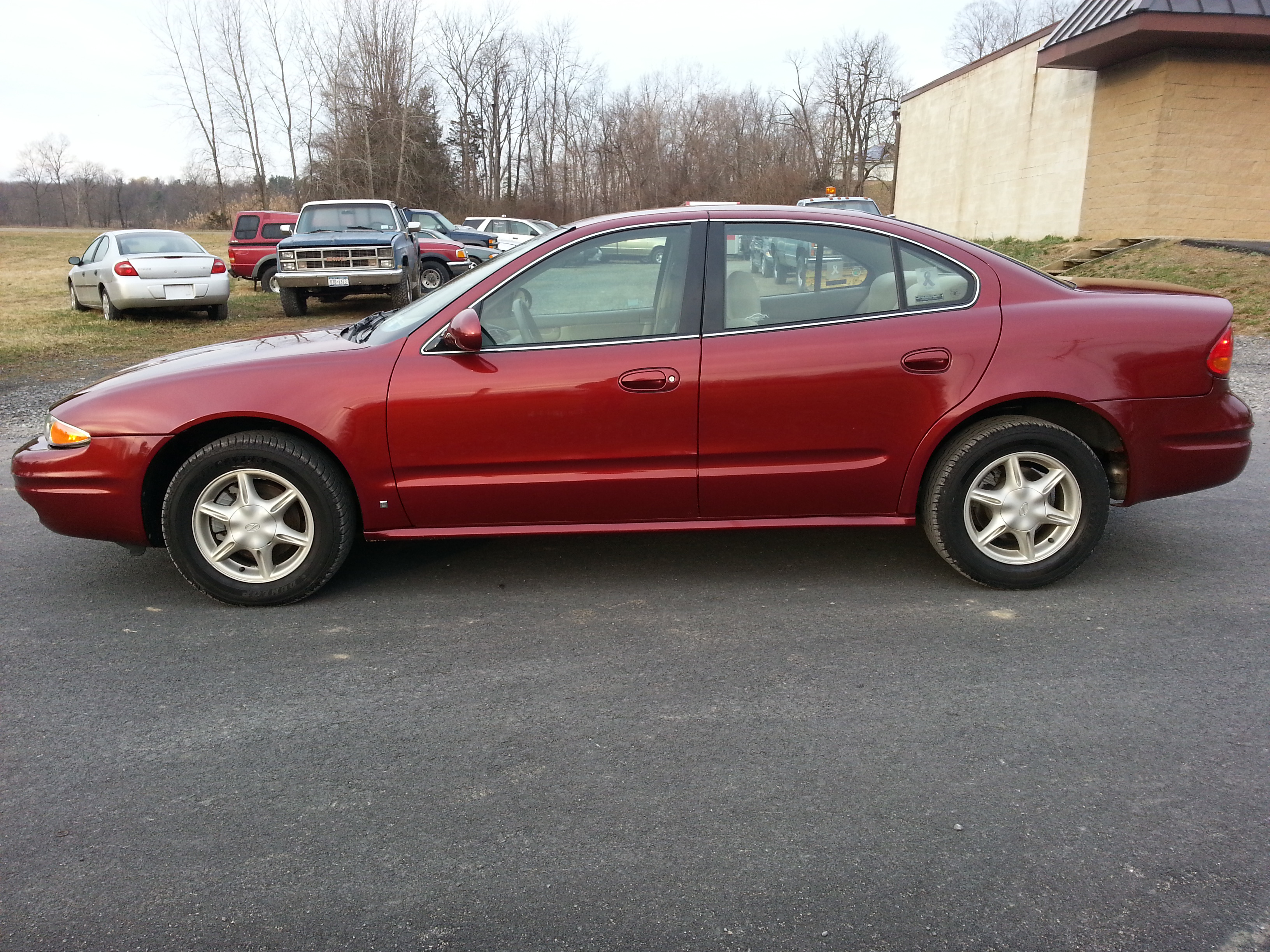

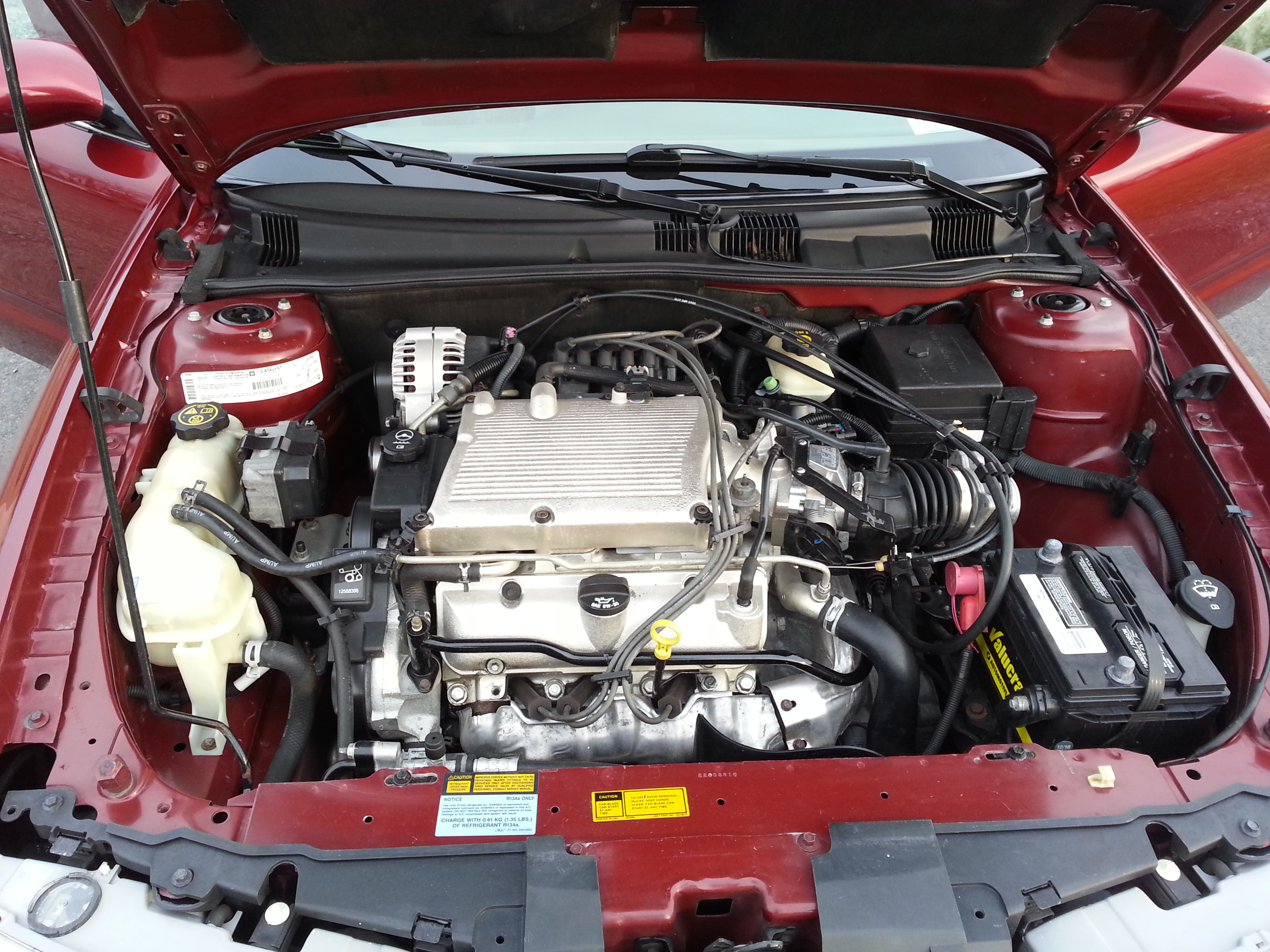

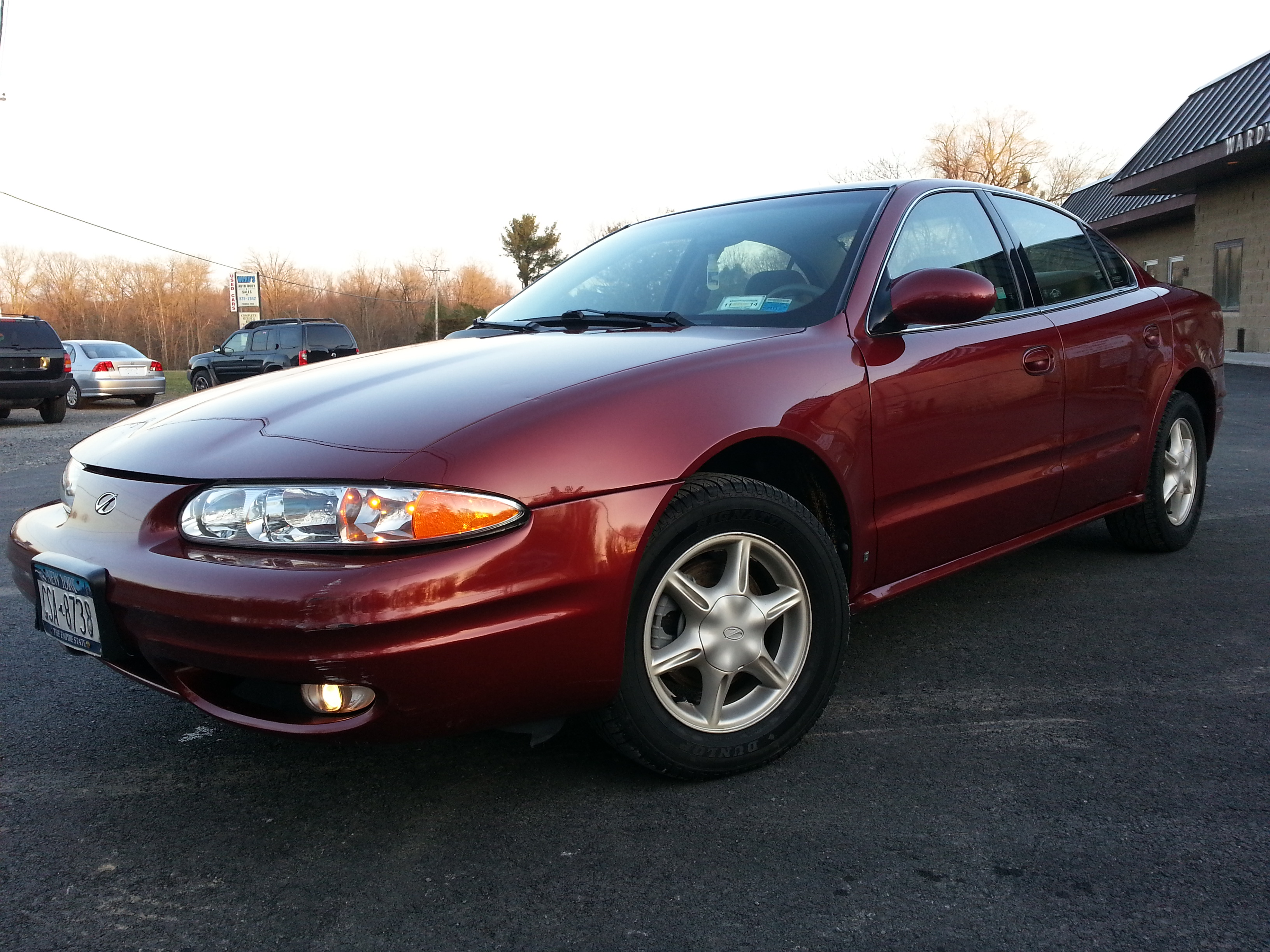

ID:	377494Click image for larger version
ID:	377495Click image for larger version
ID:	377496Click image for larger version
ID:	377497Click image for larger version
ID:	377498Click image for larger version
                                Thanks pocket-rocket, I've been gaining compliments everywhere. The car that bit the 60v6 bug was a base 4 door column shift '90 Lumina Euro. Neutral bomb champ.
                                Anyway, these are some of my "for sale" photos. They don't have the greatest backgrounds. They were taken after a 21 hour detailing binge @ the body shop. Notice no side mouldings, GM squares on the fenders and the clean trunk. Interior doesn't have any leather or custom anything, just like the day it rolled off the line...
                                And look at those door jambs.
                                The engine bay is a little different. No air box, or filter for that matter. Oil and valves are still clean. MAF cleaner is just part of an oil change now.
                                I visited my local mom 'n pop hardware store and found black oxide metric Allen bolts exactly long enough to serve as my UIM bolts. Also found these plastic screw covers @ Tractor Supply and x-acto'd the flip caps off and bored the holes out and made nylon washers that were also black. Hated the engine cover studs on the previous photos.
                                Also have fluid cap upgrades. Coolant and brake are from a '13 Silverado, oil is from a '13 LaCrosse, steering is new GM for an '05 Grand AM, and washer is from an '11 Tahoe.
                                If you can tell, the alternator is not Toyota Almond Beige Pearl. After 5k miles the Duralast rear bearing s***.
                                I also removed the GIANT wire loom on the plug wires. I need 3/4", not that stuff. Also need a rear wire retainer at the back of the UIM. That bothers me. I'm sure it will get taken care of this time around...
