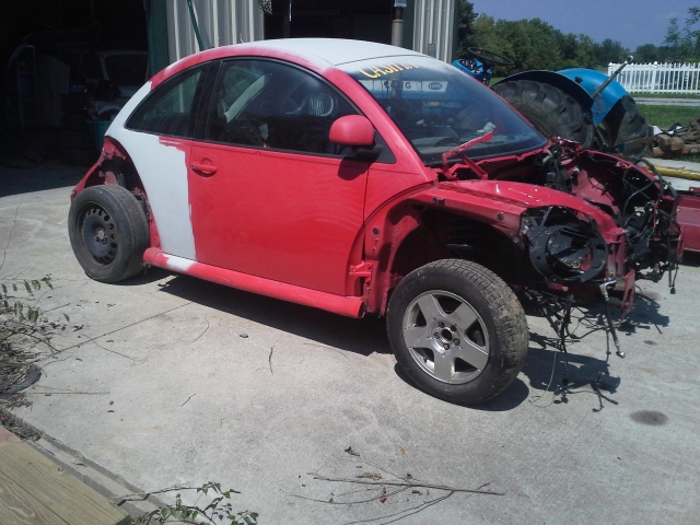

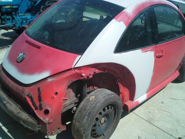

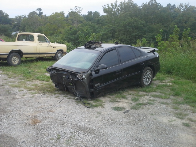

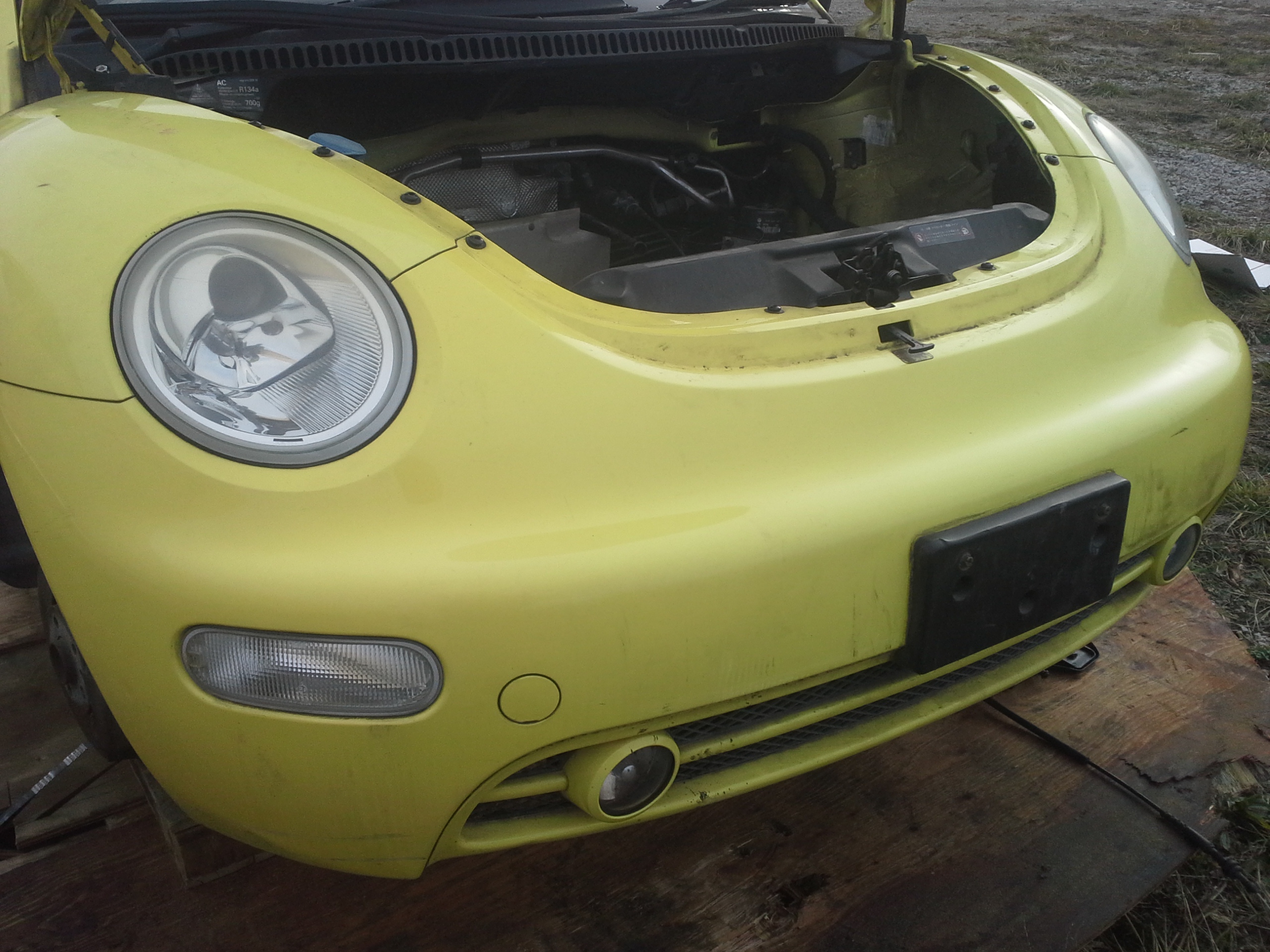

    I came across a 98 beetle shell for $250.00. it was in great shape. Had a clean title, decent body. and the replacement parts would be cheap and easy to find unlike the fieros. so I picked both cars up and got them to the shop. Click image for larger version
ID:	381491Click image for larger version
ID:	381492Click image for larger version
ID:	381493Click image for larger version

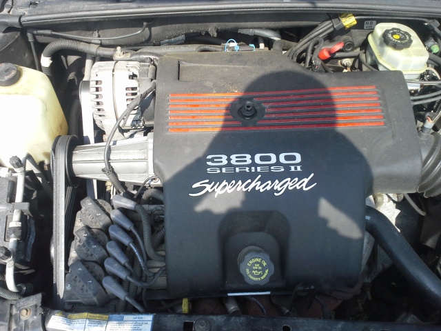

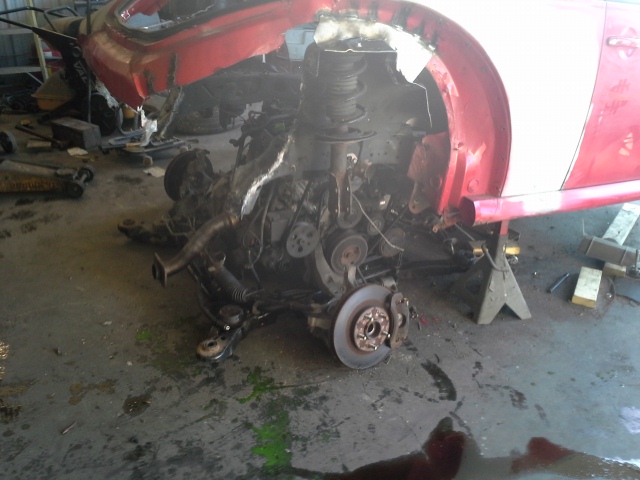

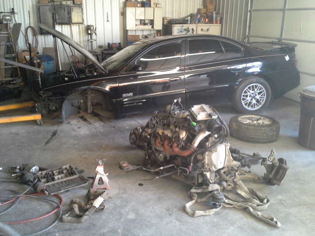

    Then I removed the drivetrain from the Bonneville

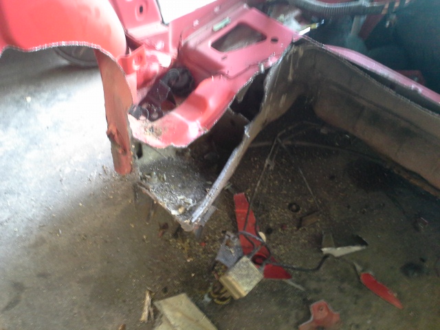

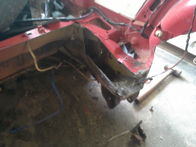

    then I needed the front unibody structure from the Bonneville so I cut it at the firewall
    that cut left me with this part of the Bonneville frame

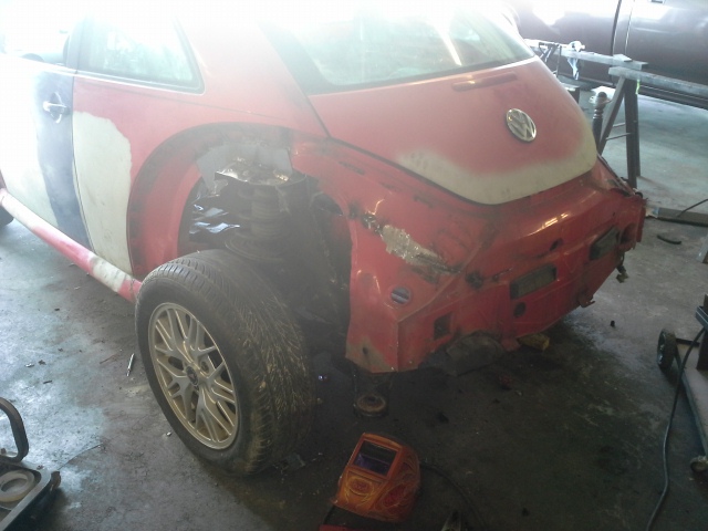

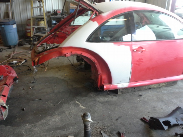

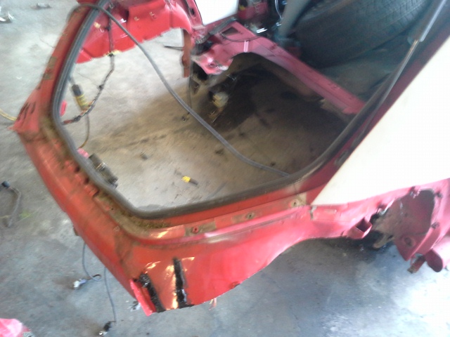

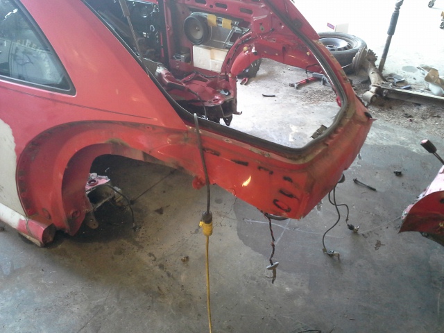

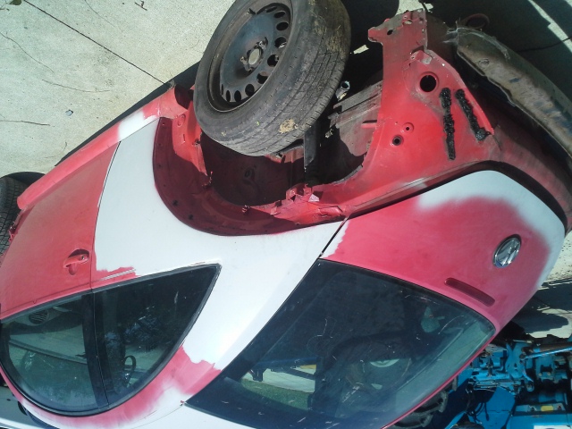

    I then took measurements from the Bonneville frame, this is where it gets really interesting At first I took measurements to check about just doing an engine swap..... then I had an amazing idea. I had never seen a new beetle with the engine in the rear like the old bugs had. so I took the measurements and moved to the rear of the car to see if it would fit. I came to the conclusion that I can make it work so I broke out the tools and got to work. the first thing to go was the trunk pan cause hey.... who needs that.Click image for larger version
    That left me with an empty soul feeling.
ID:	381500Click image for larger version
ID:	381499Click image for larger version
ID:	381498Click image for larger version

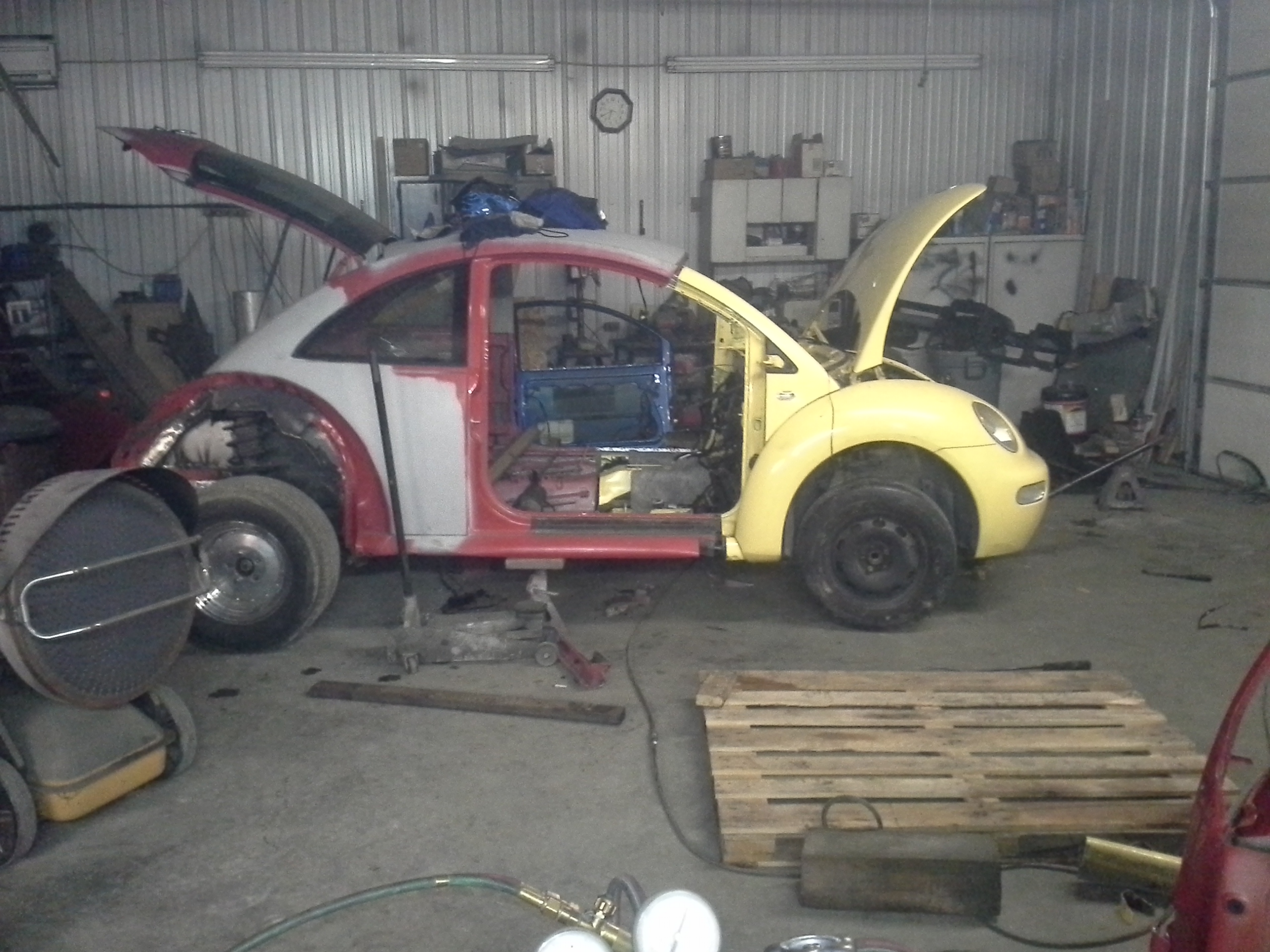

    I then test fitted the Bonneville frame with suspension attached, I set my wheelbase back to the factory beetle specs.Click image for larger version
ID:	381505Click image for larger version
ID:	381504Click image for larger version

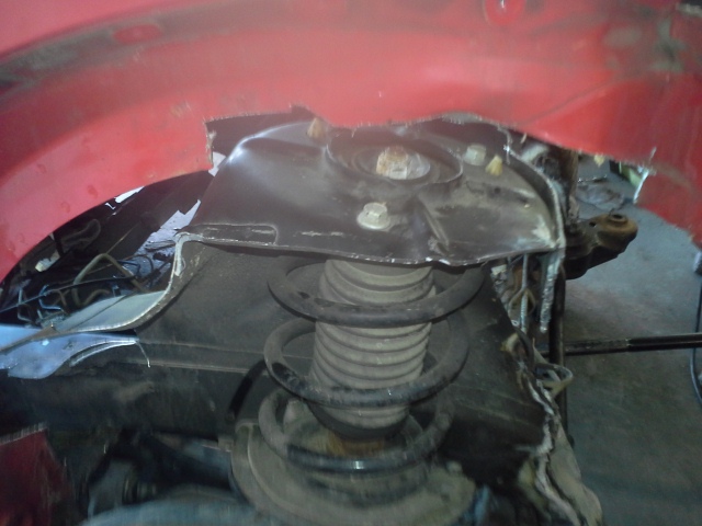

    once I got it where I wanted it I made a mark and cut for strut tower clearance

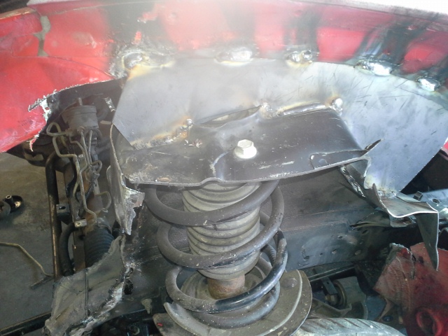

    I then plated them and welded the strut towers in place

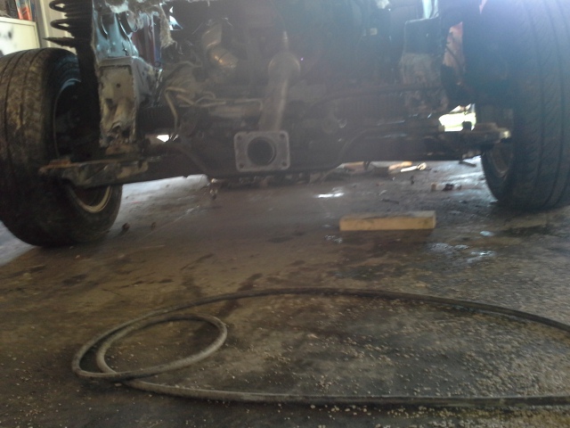

    After a few days of playing around this is the beetle back on the ground with the Pontiac suspension and engine subframe bolted in
ID:	377926Click image for larger version

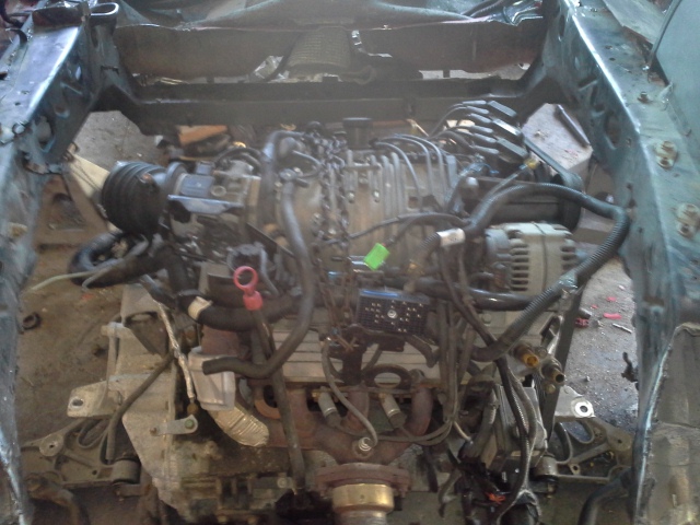

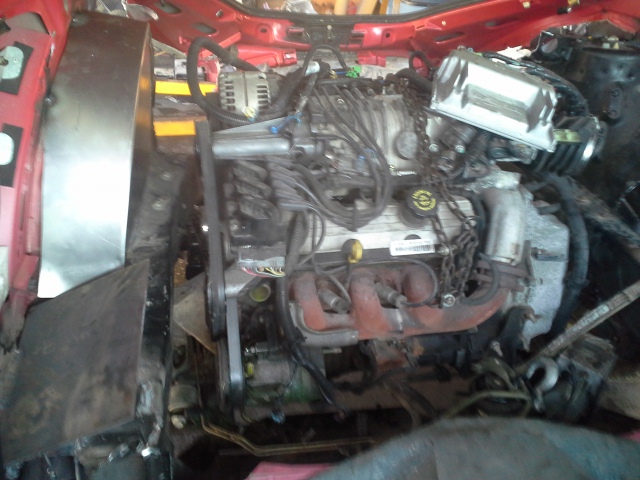

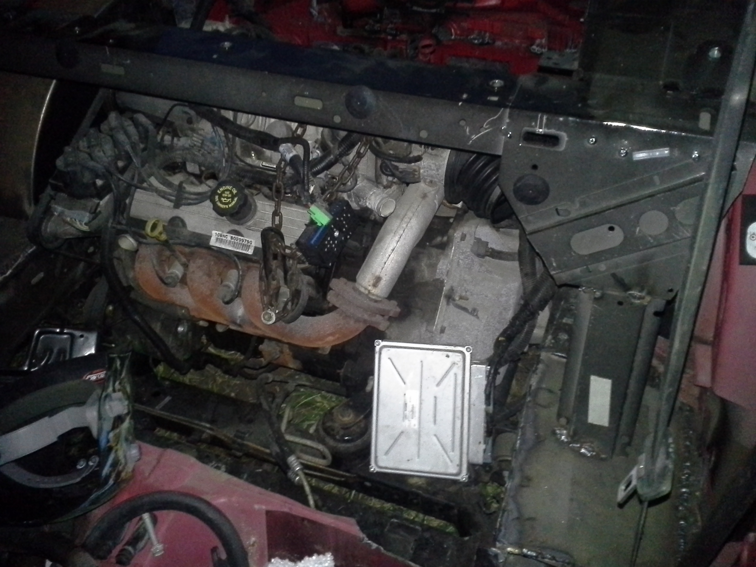

    Then I get to install the engine and transmission so I pulled the subframe out, sat the engine and tranny back on and put it back in the car
ID:	377929Click image for larger version
ID:	377930Click image for larger version

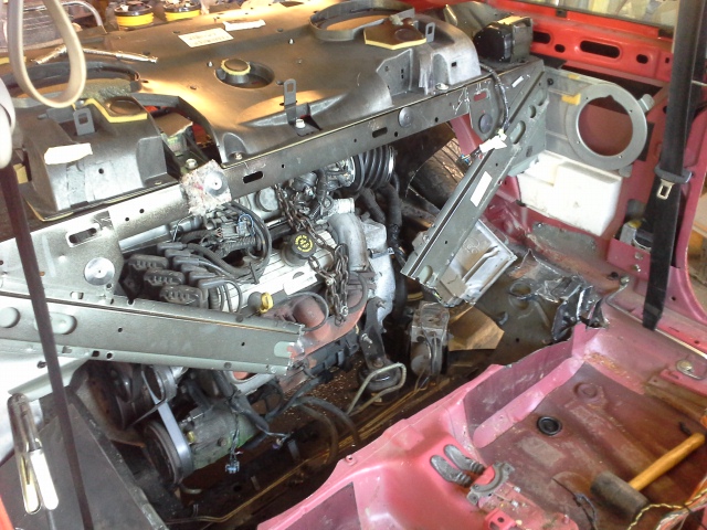

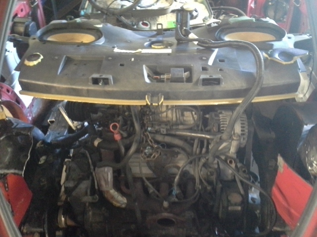

    the Bonneville has 8 speaker surround stereo and I needed a firewall so I cut the rear deck out of the Bonneville and put it over my engine
ID:	377932Click image for larger version
    then I decided I would like to have a really good sized access panel to get to the engine because whats the use of having a toy that you cant work on. so I cut the cross bars off the rear deck and welded them in straight up and down. if you look at the bottom right you can see the top of one of the frame boxes, I will be using this as a roll bar base plate. as I tie the roll bar into the front subframe later it should help eliminate the Bonneville frame from trying to torque up in front and also provide lift in the front of the car resulting in extreme weight transfer and extra traction for launching the car out of the hole.

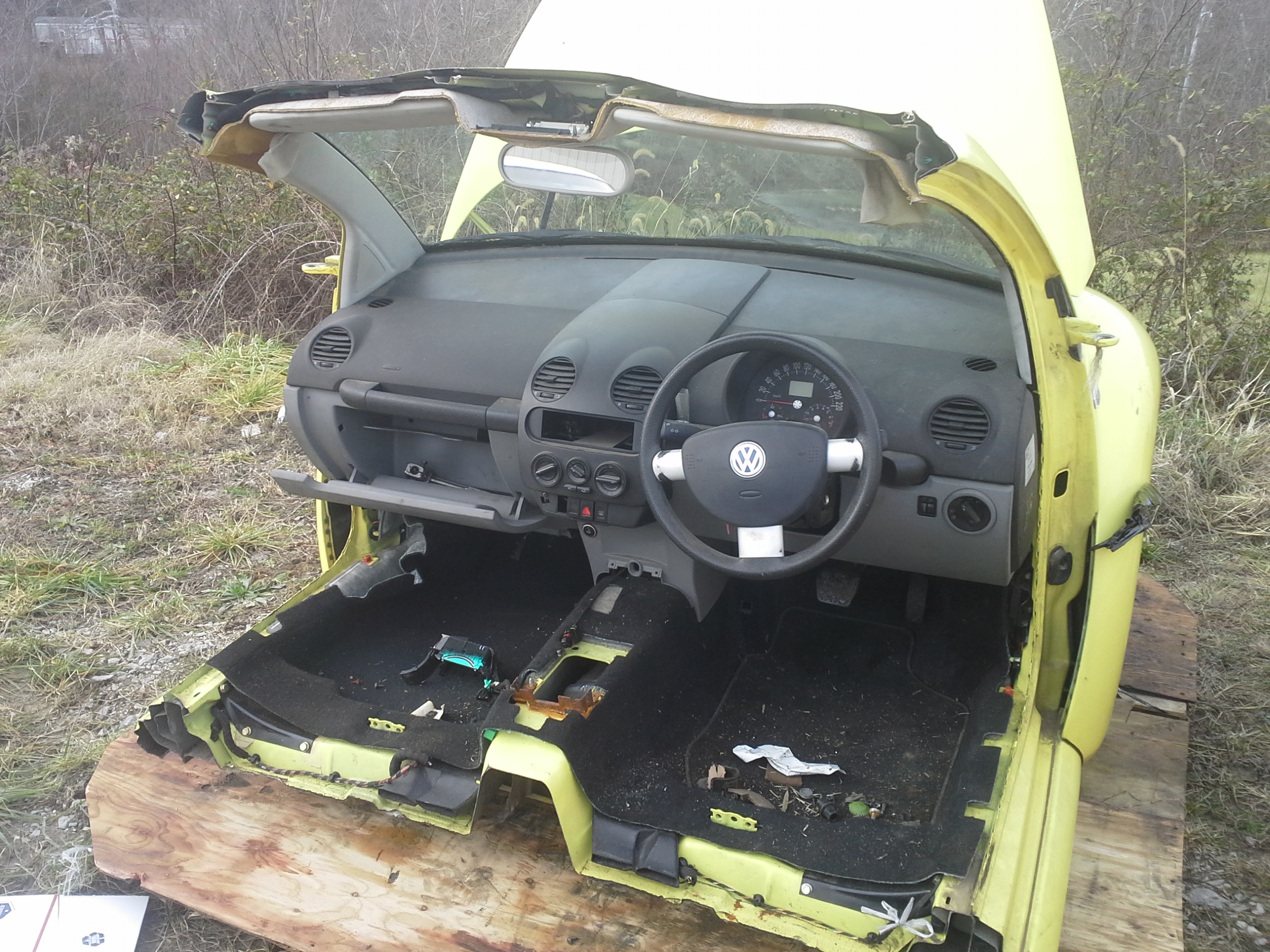

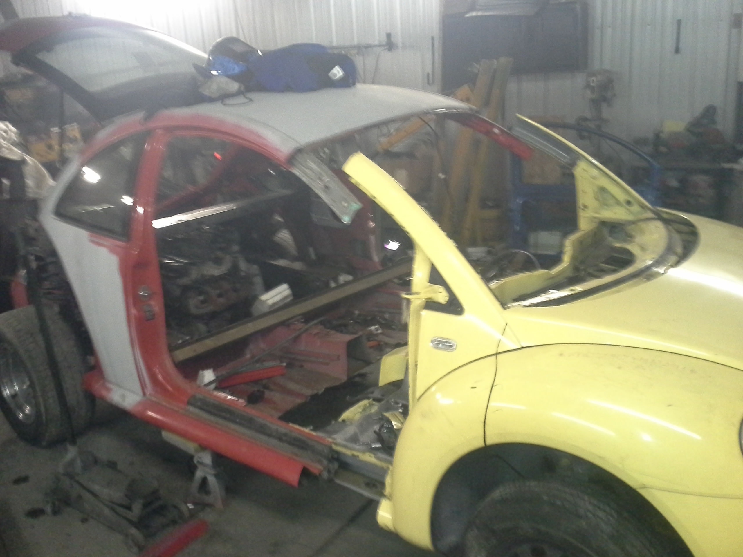

                    What do we have here
                    • young gun
                      • Jul 2010
                      • 250

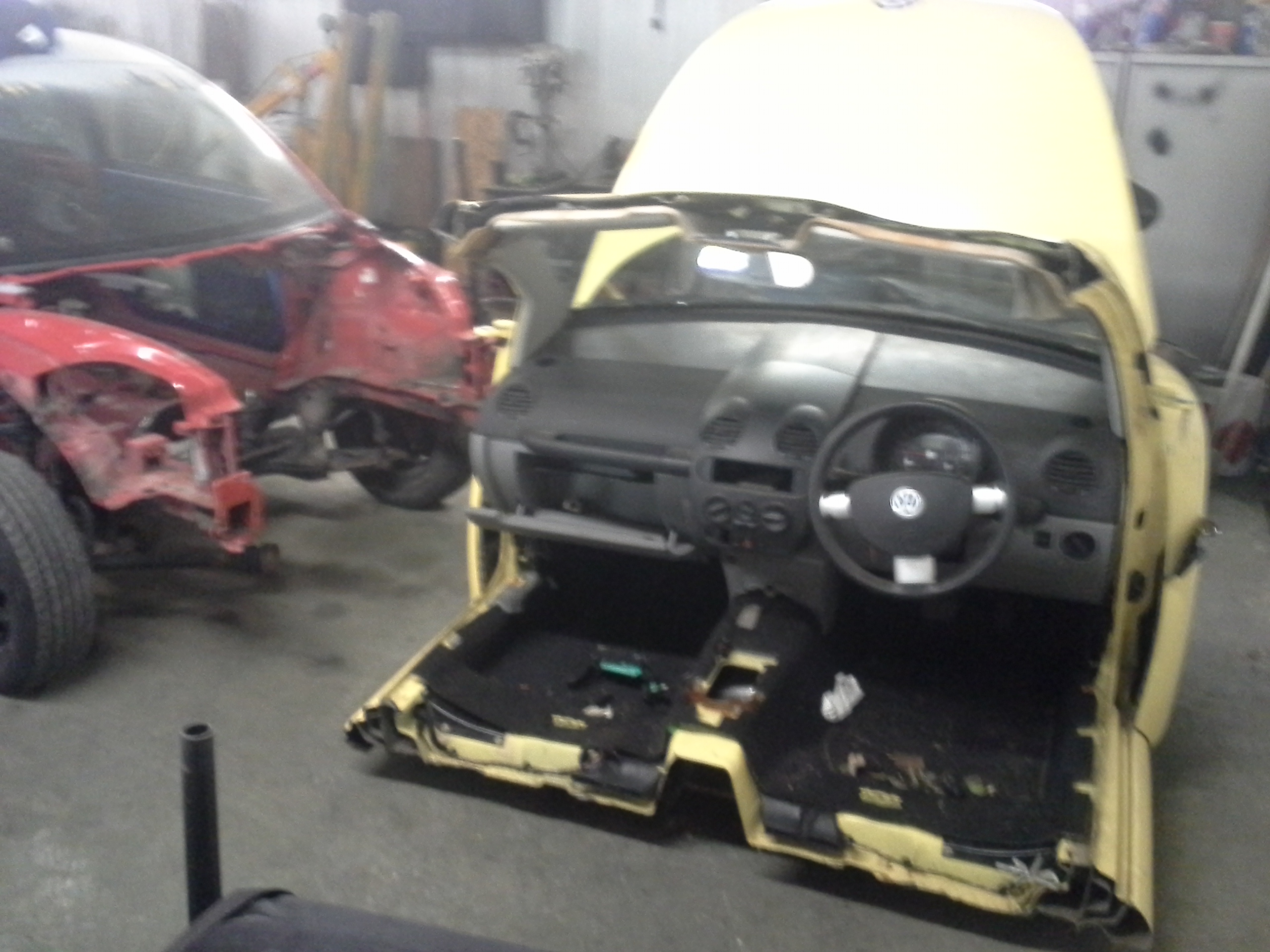

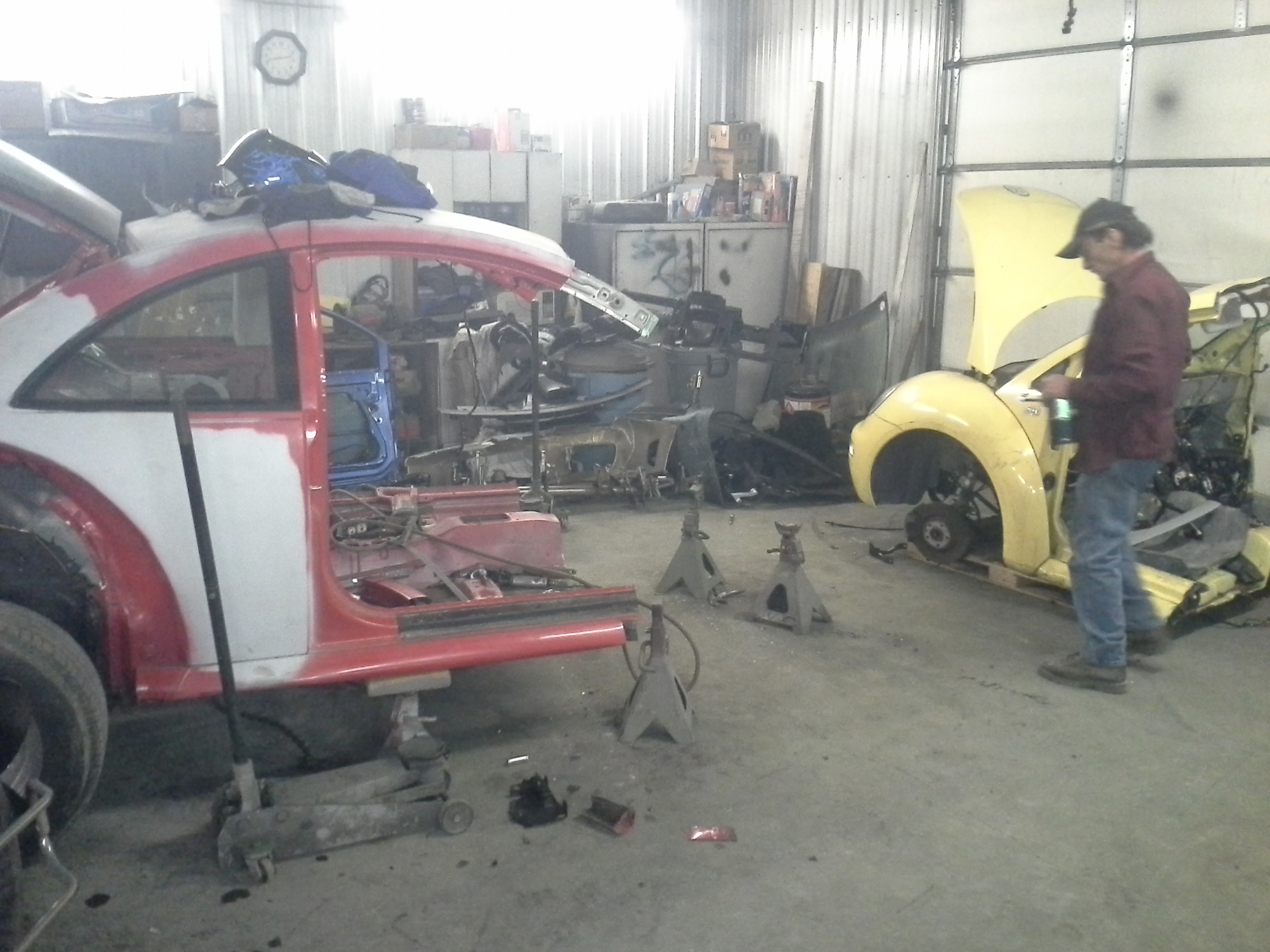

                      Very interesting combination here. Did you end up stretching it a bit with the yellow one or what is up with that?
                        looks like the red one had front end damage, probably just grafted the good stuff from the yellow one onto it.
                          You missed the fact that it's a right hand drive half cut though...
                            so I did... wow, this is going to be pretty neat.
