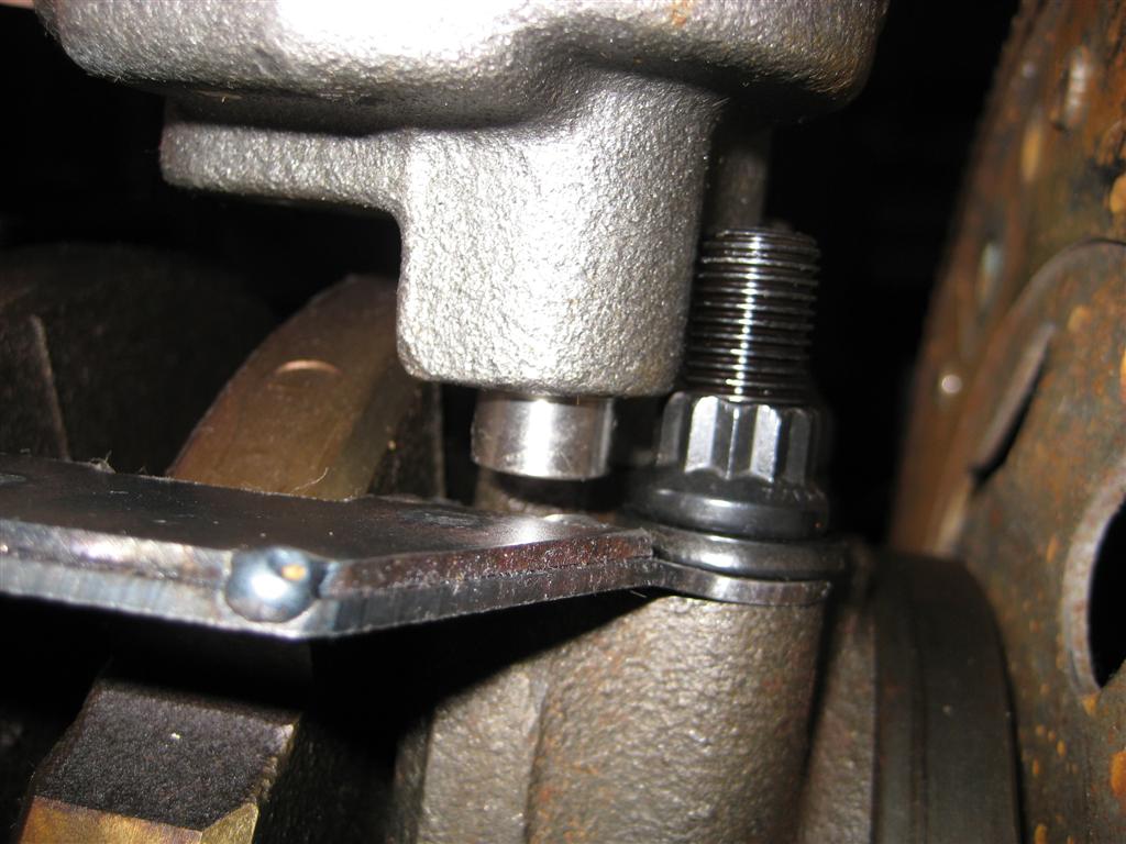

    after looking at the pump closer, it appears its just the body thats going to be clearanced and it SHOULDNT hurt the pump. the only problem is that where i would be grinding is very close to where the drive shaft attaches and i dont want to hurt the strength of the pump. but ill try grinding the pump tomorrow. edit: is there supposed to be a gasket between the pump and cap? i dont remember taking one off but id rather be safe than sry. thx

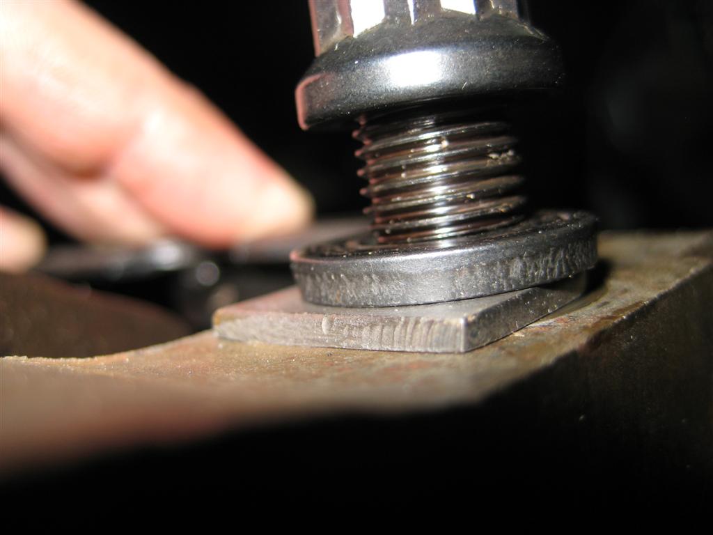

          If it was bottomed out, the stud wouldn't turn. Its supposed to be snug but not tightened. The scraper is .077" thick (or close, I was tired last night and saw it was over .070"), which is enough to make up for 1 washer on the scraper side.
            • 13496
            I took 2 more, to show the difference between with the scraper and without.

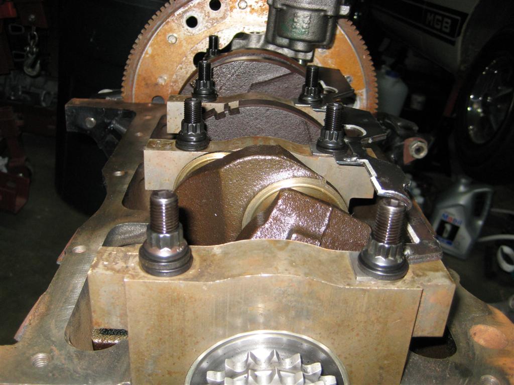

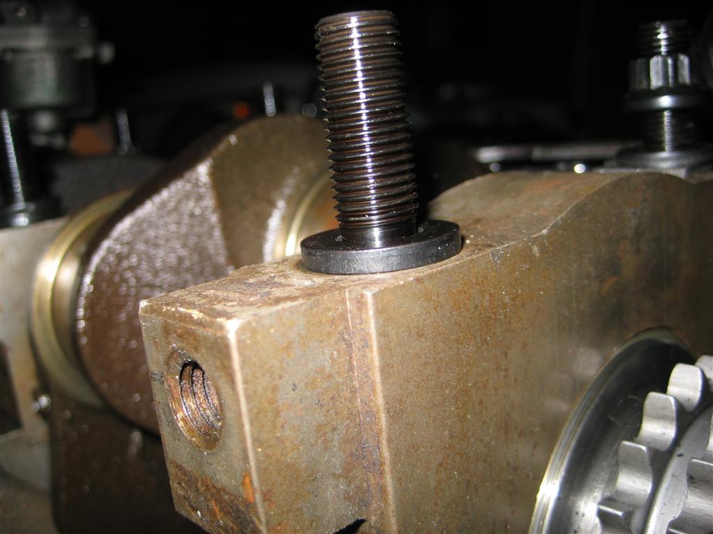

              your studs look shorter than the studs i was given. look at my first 2 pictures. front with no washer, and front of yours with no washer. your studs must be different than mine.

                How long are your studs?

                  I had the same issue with oil pump clearance. I shaved off about a 1/16 of an inch off the pump which provided just enough room for the stud, nut, and double stacked washers. Just to clarify though I am working with the lz9 motor.

                    Right, with 2 washers and no scraper you will have a little more intereference than 1 washer with scraper. I am sure it is nearly the same deal as your LZ9 from the description.
