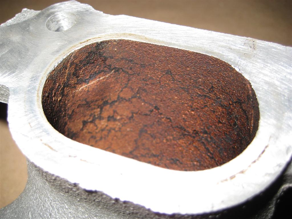

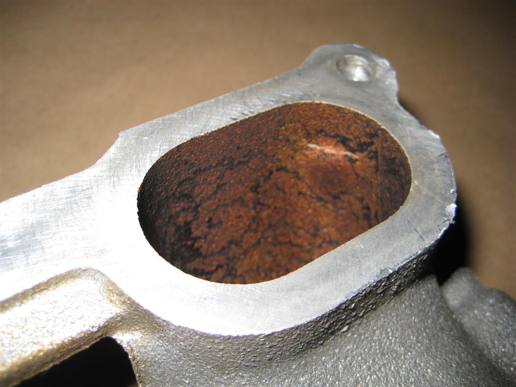

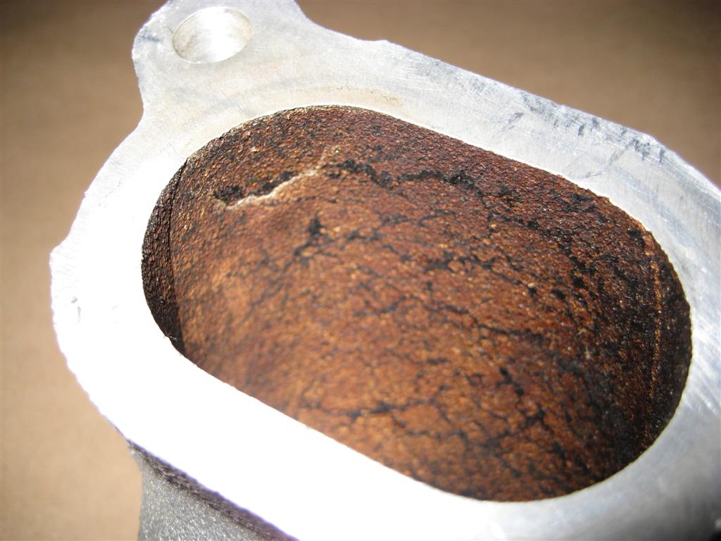

    I have seen 5 manifolds now with the same issue. The bolt holes are not going to take much abuse, especially on the corners. I have a manifold now with 3 cracked! 1 is in the middle, which is a first.
    When shipping manifolds, please be sure the entire manifold is surrounded by something to cushion it from the box itself and any other parts in the box. When installing manifolds, make sure you torque the bolts to 18 lb ft and no more.
