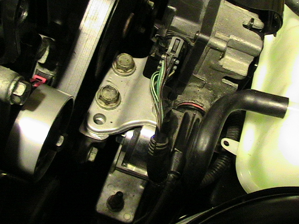

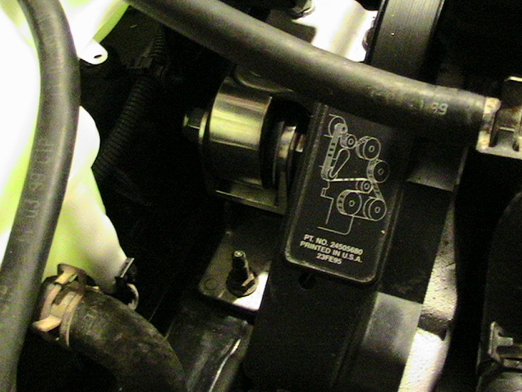

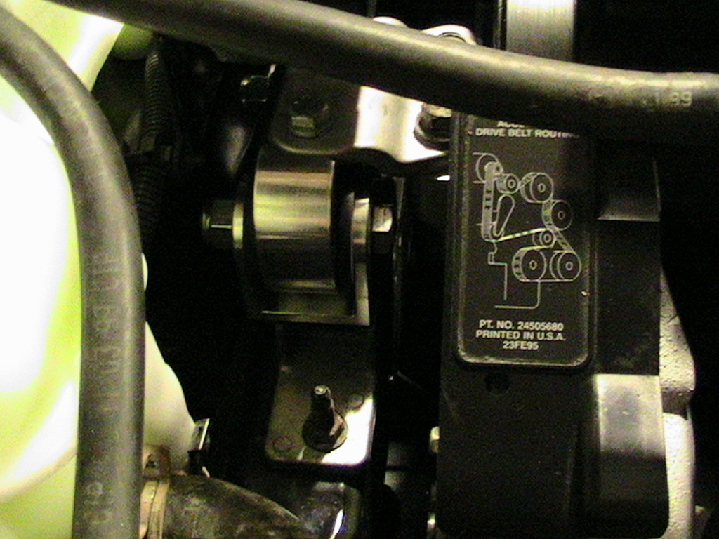

            I've had mine installed for a couple of weeks now and while I haven't gotten on the gas a lot because of a hole in my rear header, I have definitely noticed an improvment over the stock mount. Better traction and acceleration from a stop and it drasticly cuts down on weight transfer in corners. The mount also works great with the Torque Link from MP Racing, the two compliment each other very well. I did find it easier to leave the top plate off untill the lower portion is installed otherwise the bolts don't clear the cruise bracket.
