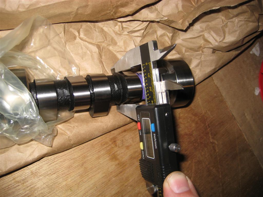

        Base circle measurement is what I need if you don't want to guess.

          How would I go about measuring that? The person who I am buying the cam from says I need .050 inch longer than stock, but I want to double check and be sure.

            dial caliper across the cam lobe. The base lobe is the opposite measurement of the peak lobe (lift).

                If you cannot measure it or have it measured locally, then shipping the cam to me works. Just costs more with shipping. I have attached a pic of where to measure. The lobes on each end of the cam are exhaust. The lobes next to those are intake, so its easy to know which you are measuring.
