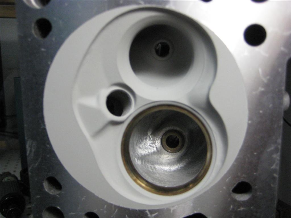

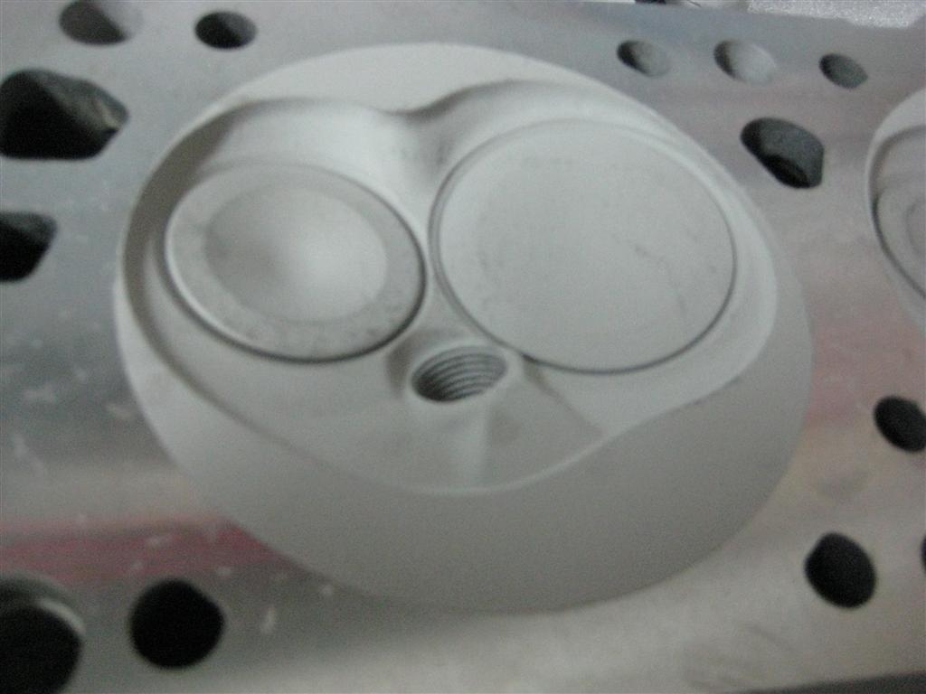

    What do you do if the best isn't good enough? You get them coated.

    What are they coated with?

      Swain Tech did the coatings, and they help block the thermal transfer from the combustion charge to the cylinder head. Keeping the exhaust hotter will help it travel faster out the exhaust.

          That is interesting and can you please explain the benefit of this or a link I can read up on the subject ? I read something lately about detonation elimination by coating the combustion chamber And keeping the thermal benefits. But they also talked about coating the ports also. With a dry film coating

              nice !!! this id the article i read http://www.techlinecoatings.com/arti...ad_Article.htm And was refered there when i contacted my local powdercoater for the lateral links i have coming .

                  Coupled with the same coating on my piston domes, this should help keep more heat in the combustion chamber and then flowing out the exhaust.
                  The theory is that less heat will be absorbed into the cylinder head, where it must be dissepated by the cooling system. So the motor may run a bit cooler, and it should help with durability of other parts.
                  And should also help to produce a smidge more power.

                          $230 to coat the combustion chambers and valve faces, plus another $72 to coat the exhaust ports (6 @ $12 each), so $302 (plus shipping) total.
