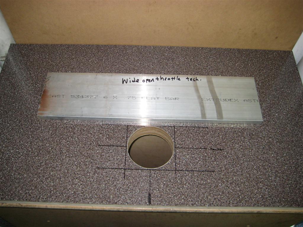

    Setting up the new bench
Name:	flowbench top 2 (Large).jpg
    We are going with the superflow 5" bolt pattern on a 4.75" bore. This will allow us to create head adapters with the proper bore for each engine to go inside the bench, and purchase adapters if feasible for more common engines.

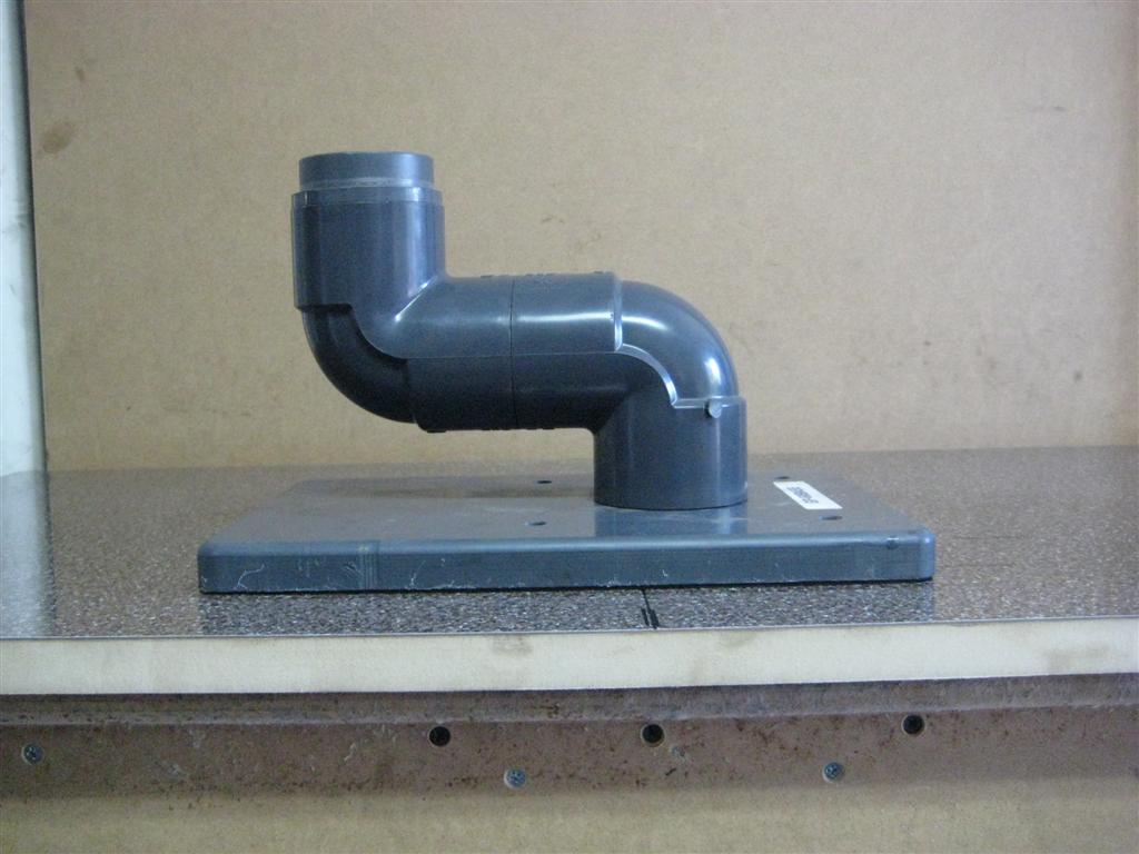

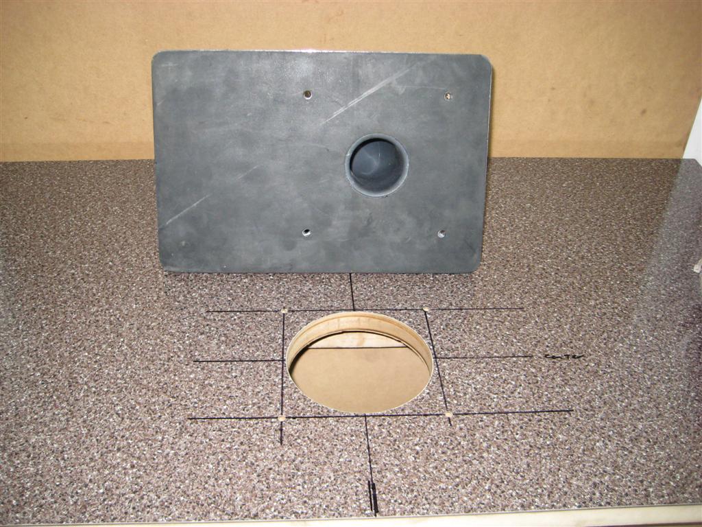

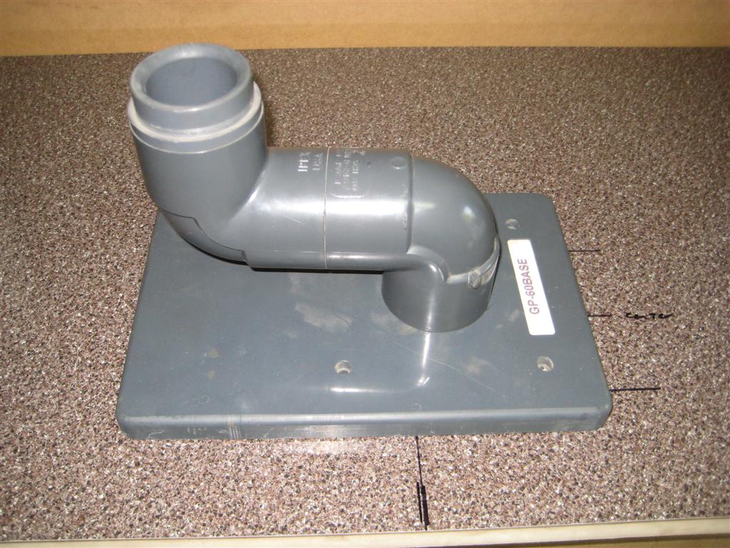

Name:	Briggs Adapter 001.jpg
ID:	377240 Click image for larger version
Name:	Briggs Adapter 002.jpg
ID:	377241 Click image for larger version
Name:	Briggs Adapter 003.jpg
    This is a Briggs 5hp bench adapter setup. Since it uses a flathead, you have to flow through the bore of the engine.
