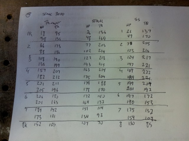

    I am waiting for more information on the billet cam as well, because we need to be able to use some of the really extreme lobes to make that worthwhile. They are full circle lobes so anything that fits a small block cam journal should be available on it.
    The Thumper cam is based on the Comp Cams THUMPR lobes, and dynomation was used to compare how this works for the cams Comp made for the other motors. 2 cams have been ordered, one for a customer and one for our test car. Customer is OBD1 and we will be tuning it long distance. Test car has a few dyno pulls to do for results before we get to putting the cam in.
    I wrote some numbers down for the stock 3400 using the stock cam, street/strip, and the little thumper. This should give you an idea of how its gonna react. Of course with more mods the thumper is gonna make even more top end power. I want to get some real world results though.
Name:	thumpermation (Small).jpg

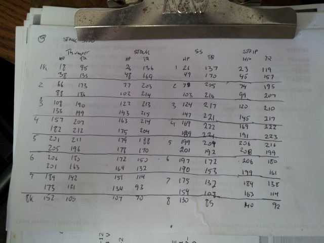

      • 13533
Name:	Thumper (Small).jpg
      Added the strip cam on a stock 3400 as well. You could call it a strip cam with lope.
      Calculated VE at 1000 RPM is 64% stock. This cam is 49%. The cam I was looking at for the Big Thumper was 25%....
