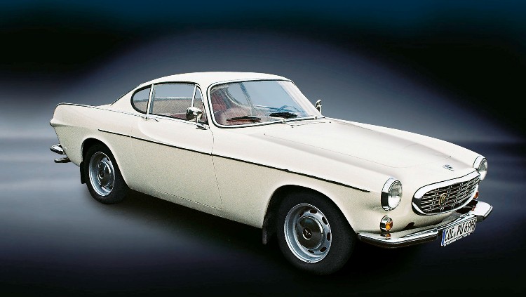

    Ok so I had to look up volvo 1800s.
    Volvo makes me think
    Ok, so...yeah id say that's not even in the ballpark of what I had in mind. Doesn't change what id recommend but now i wanna see pics of the one you are working with. The crossover is for sound, so its all up to you. Im only an expert because I know what other people have done as well as our own stuff. If you can do some custom equal length headers, then its going to be even more so (ask superdave on here). About 32" primaries ideally if you are ambitious.

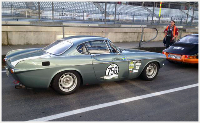

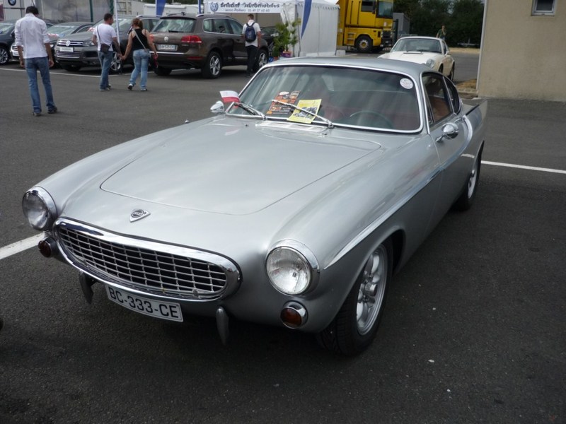

            I'm in Austin for the next few days so have my travel computer, but here are a few pic's of Dad's gift naked and awaiting the booth:
            Still undecided on color. I've used this silver car as inspiration; note debumpered, finer eggcrate grill inset, proper stance on Minilites, and how the subdued silver tones down the somewhat incongruous lines:
            Although I'm also partial to this blue, perhaps with less hue:

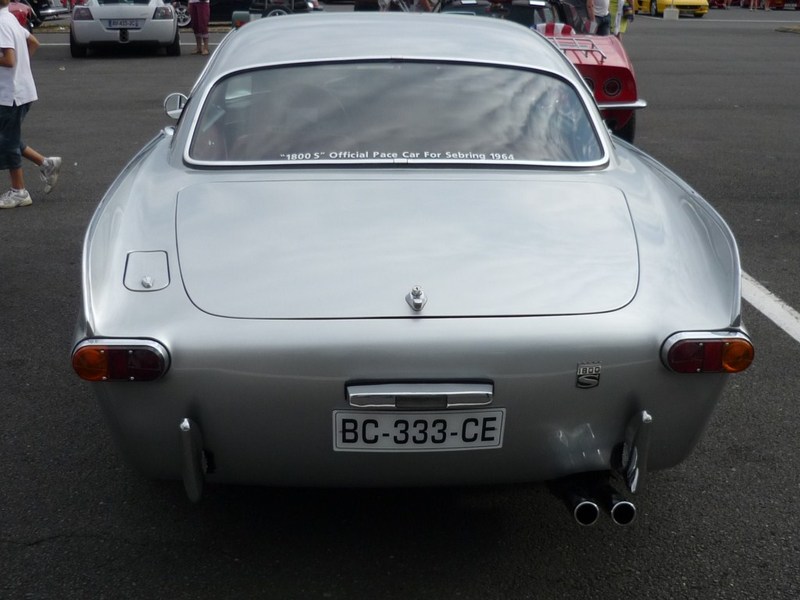

            Interior leather will be black dash, darkened silver binnacle, and a variation on the attached pic, depending upon exterior color; excuse the crappy photoshopping.
