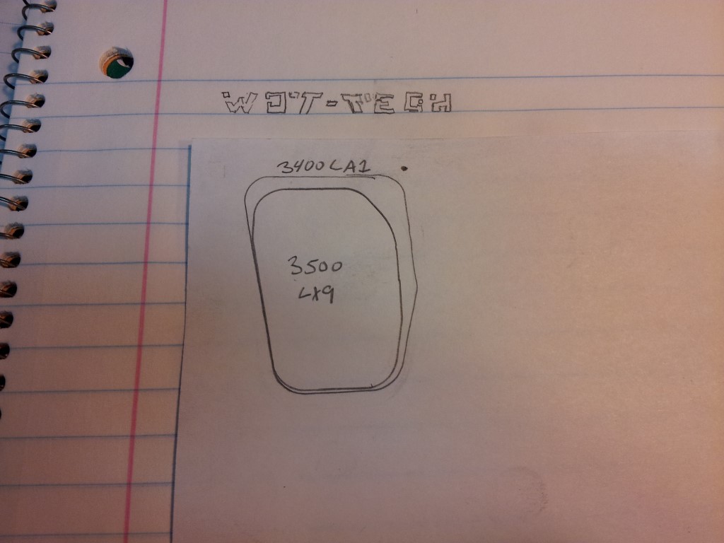

        "The real story is the intake side, which aside from the new port shape, has highly modified runner and bowl area. This radical change in design is what puts these heads at the top of the flow list for 2.8, 3.1, 3100, 3400, and 3500 LX9 engines."
        Ill add to it here with a picture.
Name:	3400 vs 3500 intake (Medium).jpg
        Unless you are making custom lower intake manifold gaskets and designing a new lower intake runner, stage 3 3400 with matching components are the best flowing top end you can get for a 2.8-3.5 LX9.

              Reason you don't or can't do this with 3500 heads/intakes? Just not worth it because you've already done it with the 3400 stuff? or something preventing it on that casting only?
                3500 intake port is already pretty close to the gasket, I always opened them up to it but it's not much. The GM gaskets were slightly larger than the Felpro as well.
                  Exactly what I did to mine, but according to his image the 3400 LA1 port that he ends up with is larger than a 3500 port.... so what gaskets is that engine running?

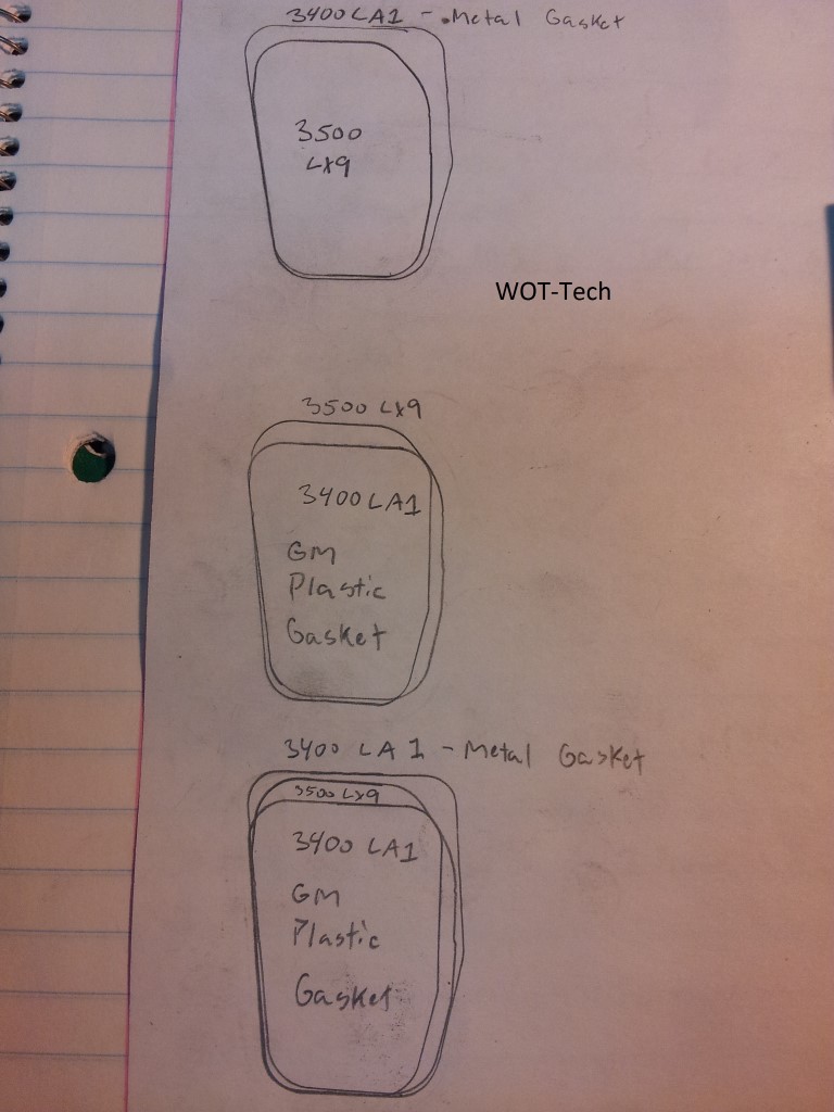

                          • 13525
Name:	3400 v 3400 v 3500 (Medium).jpg
                          We don't end up with these shapes for the 3400 ports. It was just to show the amount of space we have to work with between the gasket sizes.
                          You cannot run plastic gaskets with our stage 3 ported 3400 heads.
                          New pic has the old trace, so 3 traces total.
                          Trace #1 is 3500 gasket vs metal 3400 gasket.
                          Trace #2 is 3500 gasket vs plastic 3400 gasket.
                          Trace #3 is 3400 plastic, 3500, 3400 metal.
                          The gasket size is practically the same as flow potential in this case, because it also limits the size of the lower intake path around the injector boss. The 3500 raised intake port certainly improves the flow curve, but its also closer to optimal to start with. The 3400 has a lot of material that can be removed to improve flow. There are also areas that do not improve or hurt flow, which is why we do not gasket match with either gasket.
                          just to be clear, Stage 1 and 2 3400 use the plastic gasket size port, so any gasket works. Stage 3 is metal gasket only. Currently, all our lower intakes are plastic gasket size ports to the head unless stage 3 heads are ordered. Then they are matched to the metal gasket.

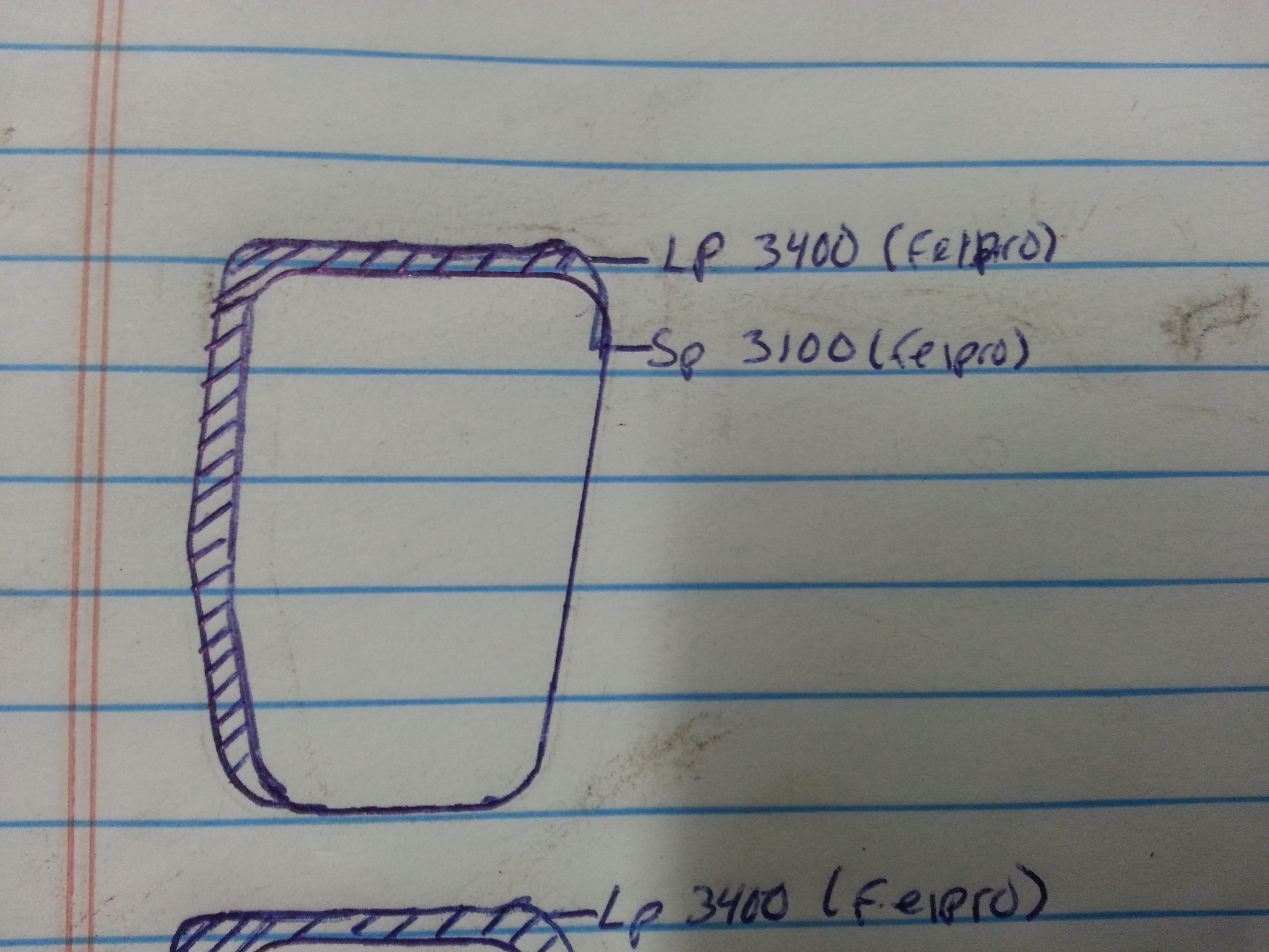

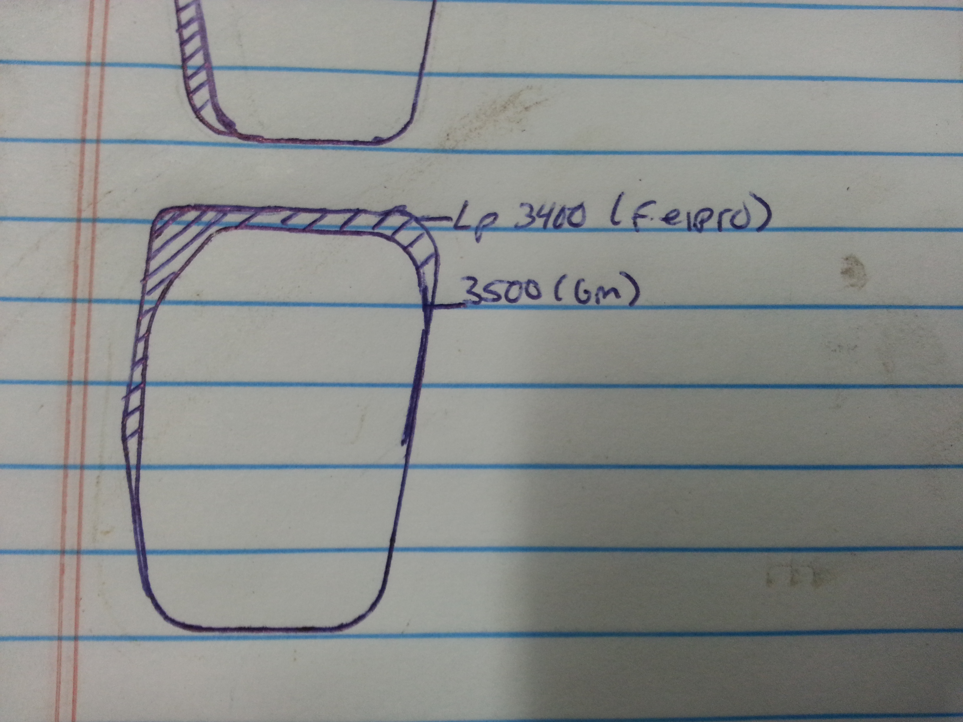

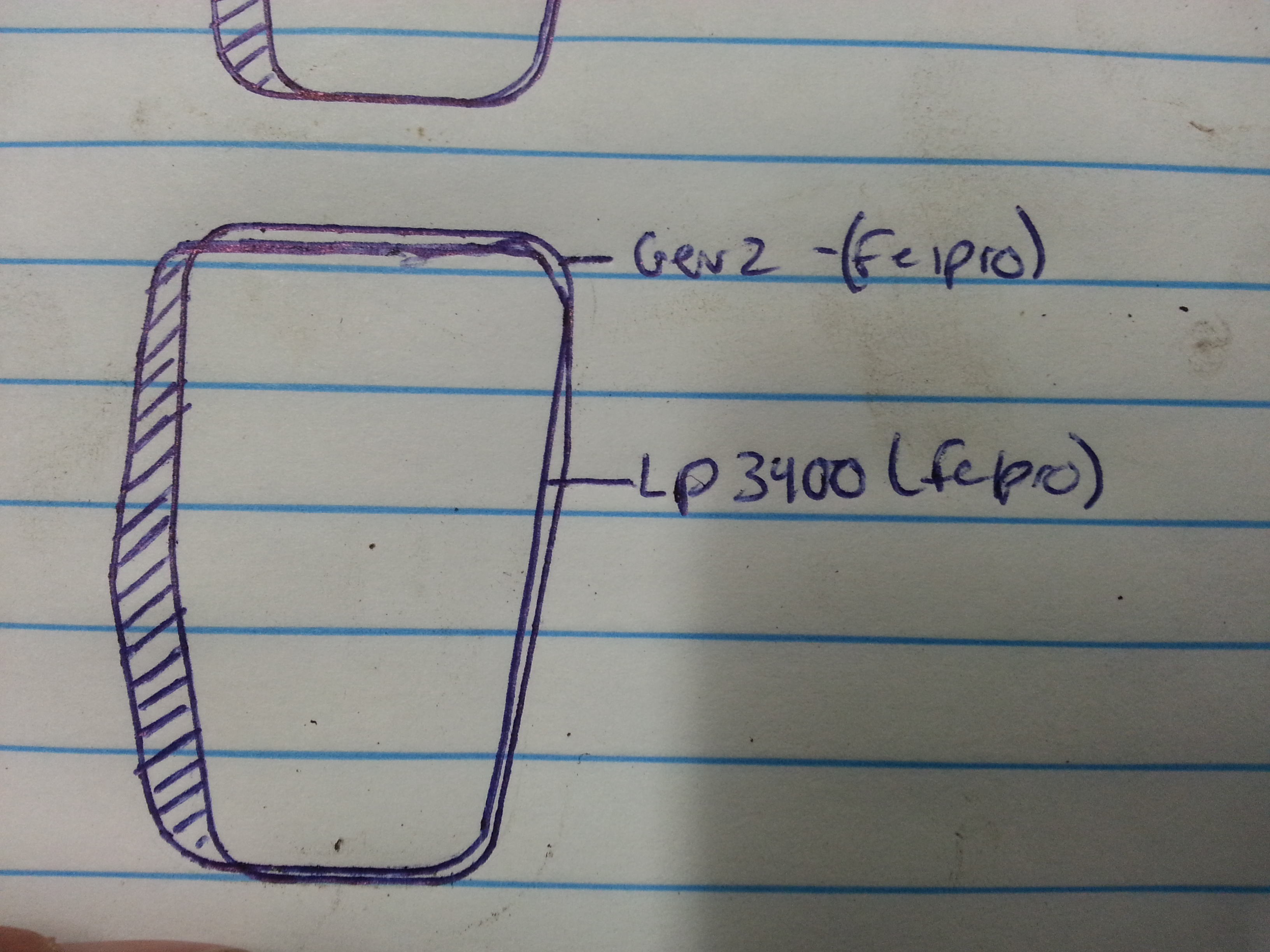

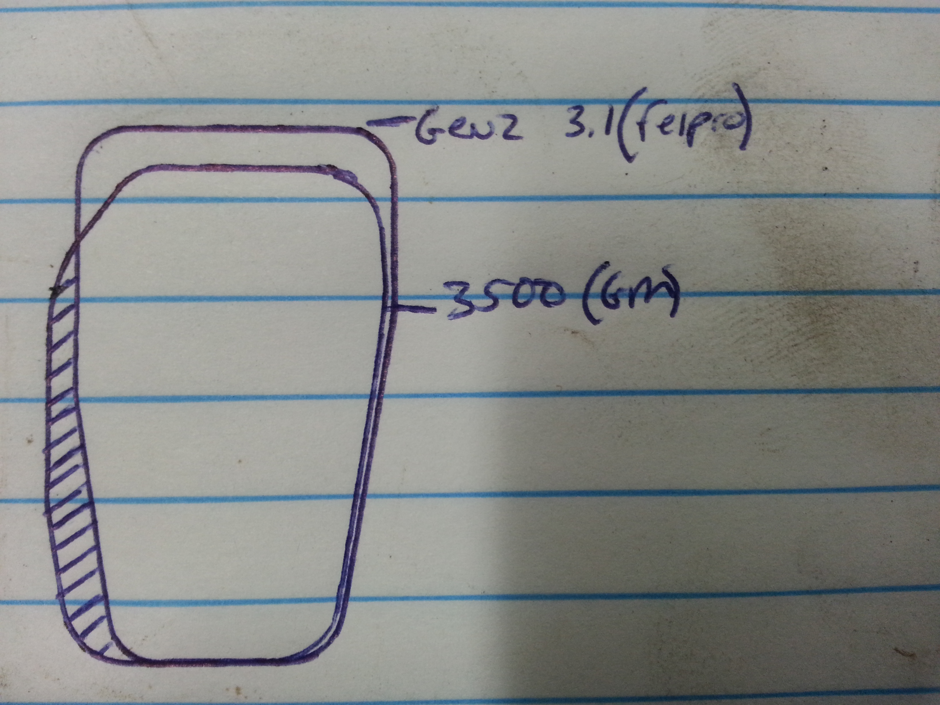

                            Ben's pics had me interested (since i'm cleaning out my garage this week mostly). I found my stash of gaskets. Traces look like mine for the most part.
                            Here are a couple more... 3500 VS Gen 2, Large port 3400 VS Gen 2 and 3400 VS small port 3100.
Name:	LP 3400 vs SP 3100.jpg
ID:	377723Click image for larger version
Name:	Gen 2 VS LP 3400.jpg
ID:	377724Click image for larger version
Name:	Gen2 VS 3500.jpg
