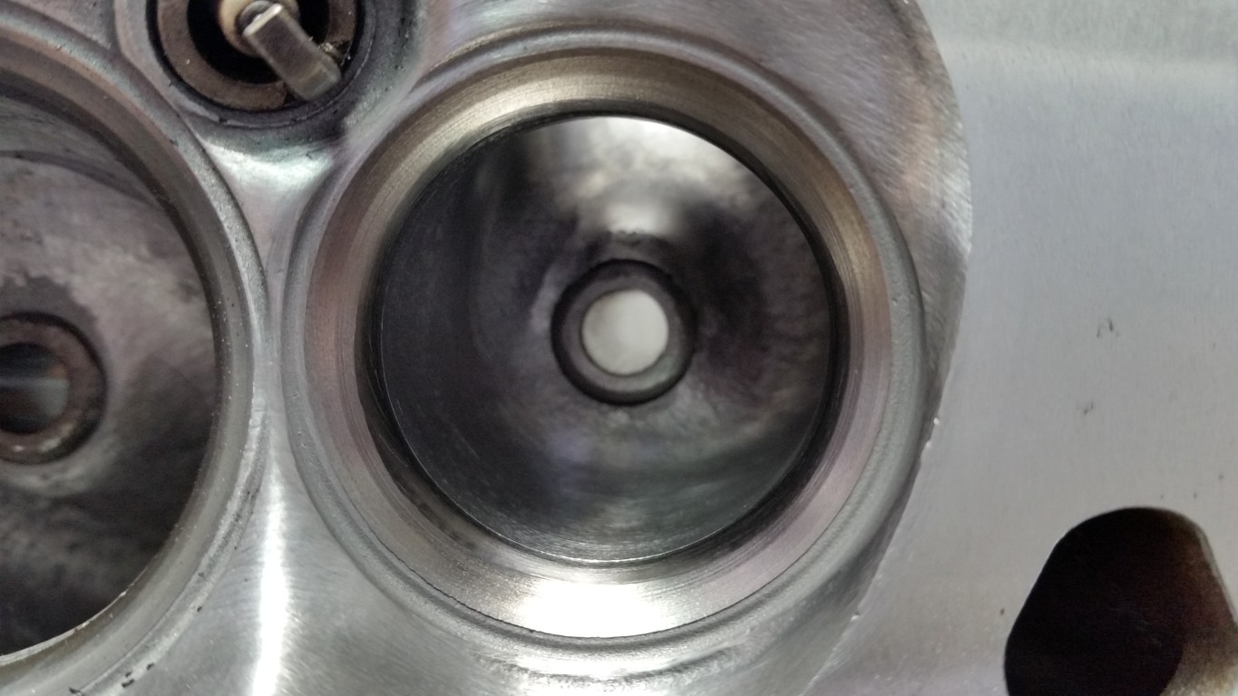

    If you take your heads to a shop and have a valve job done, you very well could get something like this.
Name:	20160810_131010 (Medium).jpg

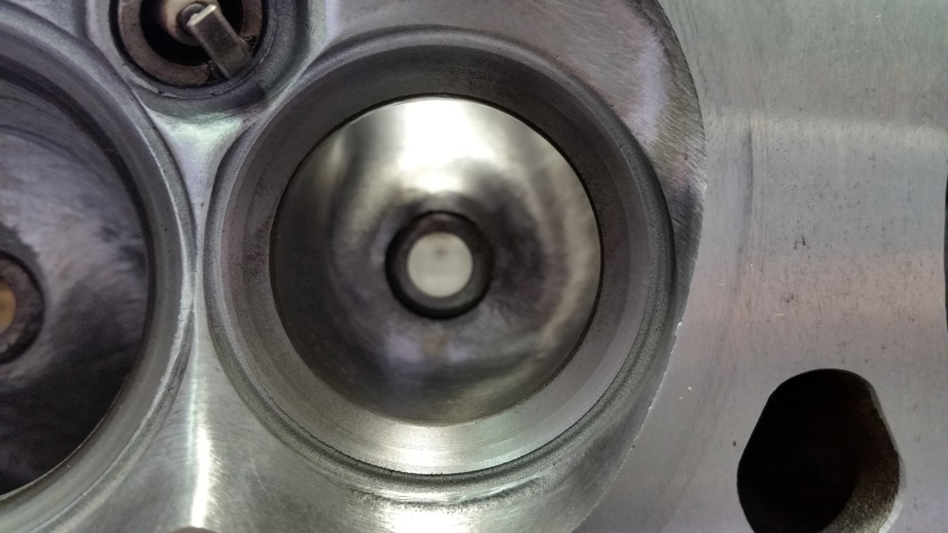

    Then opened up the ID of the seat, and blended to the next angle once the width was better.
Name:	20160810_153045 (Medium).jpg

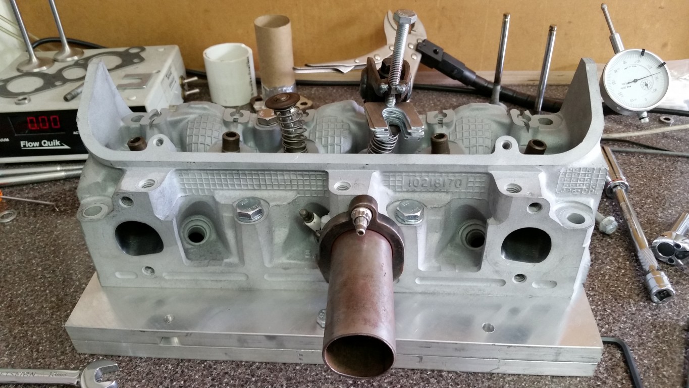

    Flowbench testing
Name:	20160810_154533 (Medium).jpg

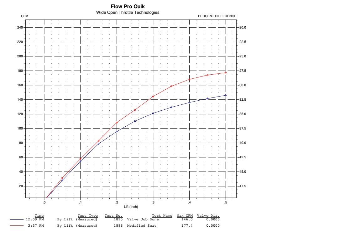

    Results
