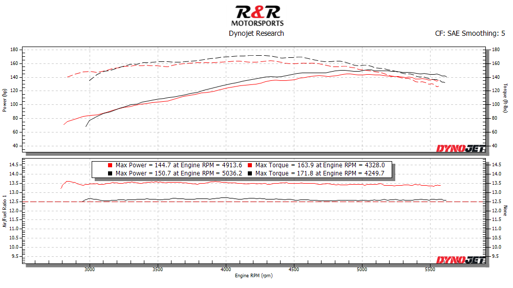

    200k miles, unknown history, all stock. Ran the tune we sell, and then tried to get more power from it as it looked like it was leaner than usual. More fuel didn't help in this case. Dyno is in Paw Paw, MI if anyone is interested in testing their car, or tuning.
