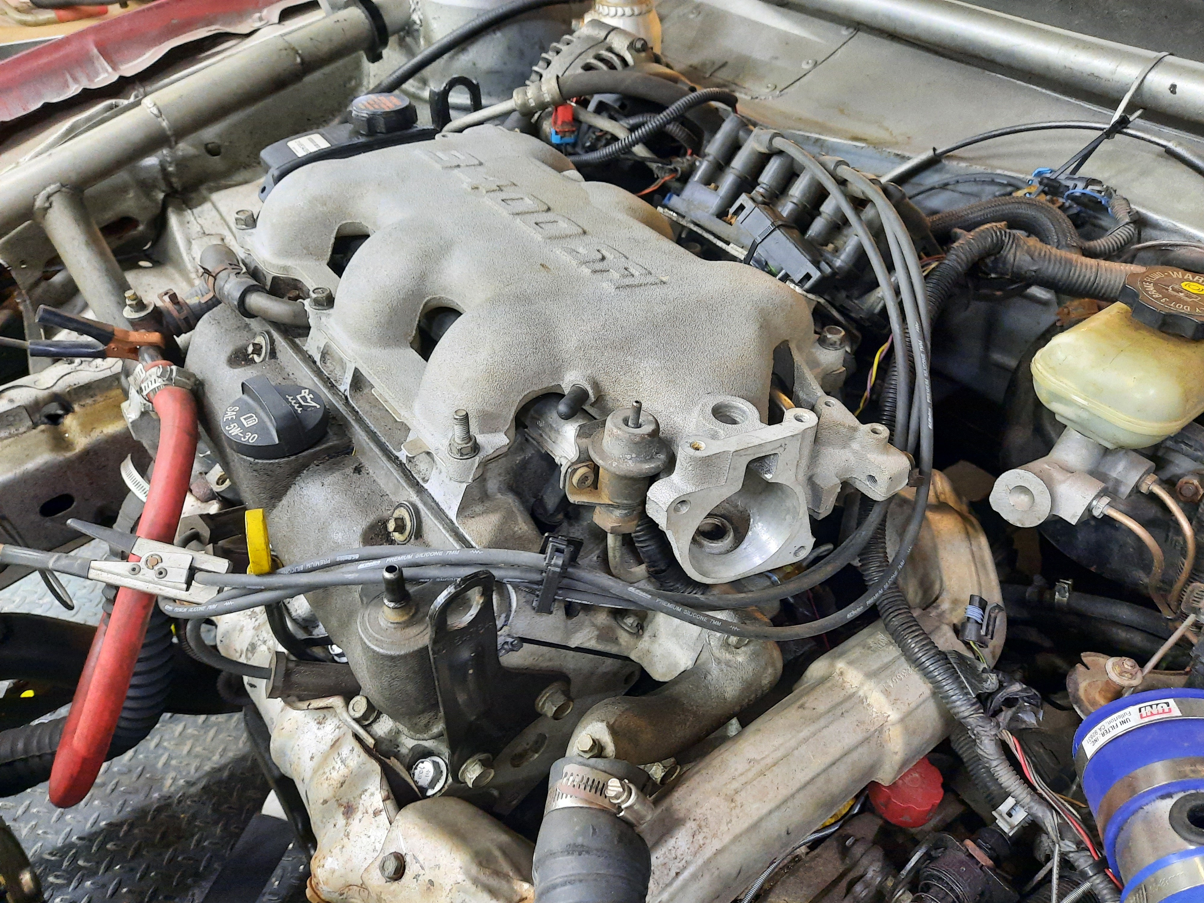

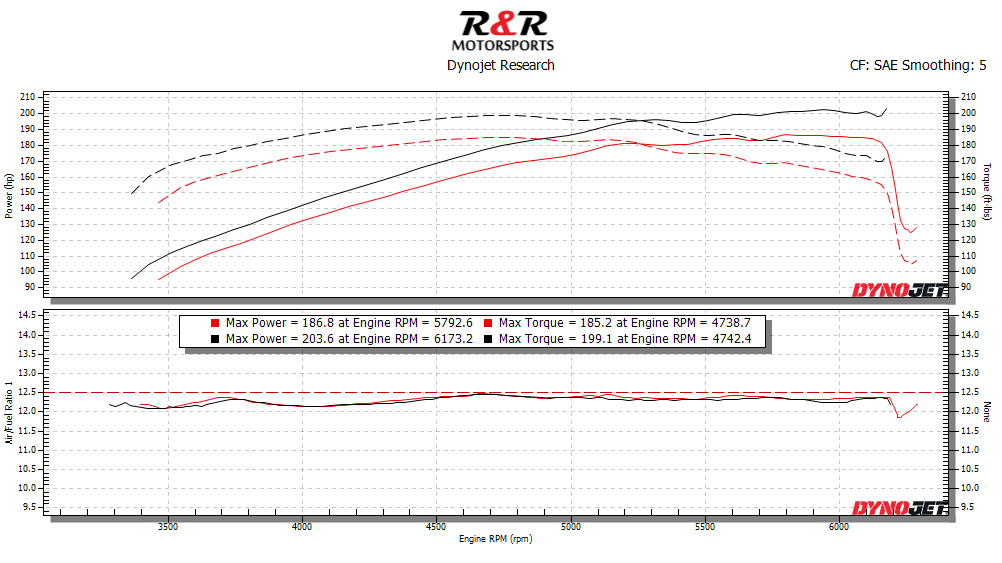

    Dyno Results for 65mm Throttle Body
    3400/3500 with 3400 upper. street/strip cam and 12.4:1 compression with the stock throttle body vs a 65mm throttle body.
