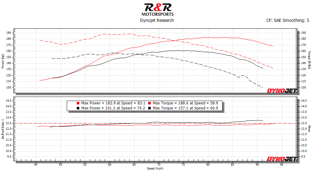

    Dyno Results Stock vs Street/Strip Cam
    Stock other than high compression, with the before having a 65mm TB but not ported, and the after with the upper ported to match the throttlebody. 6300 RPM peak for the runs.
