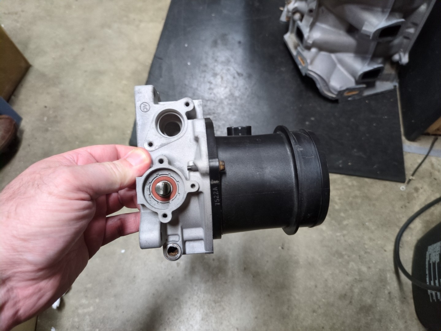

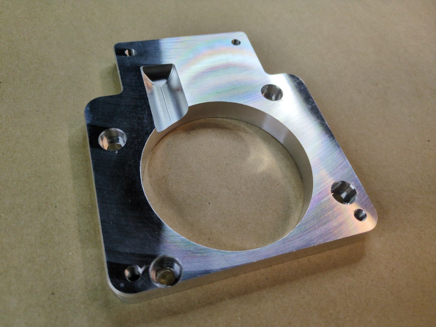

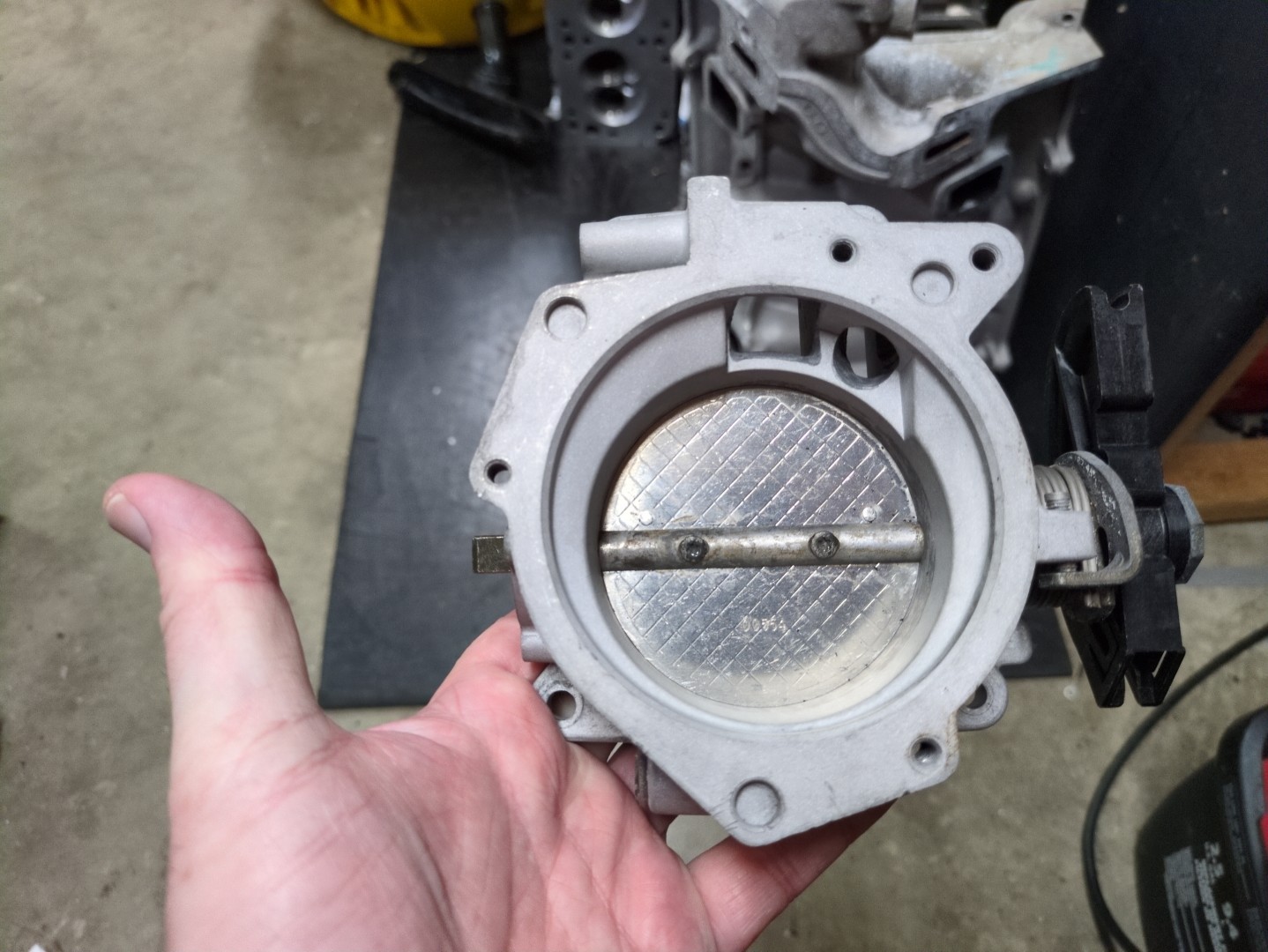

    For the LX9 and LZ4/LZ9 upper intake to use the 96-99 Olds Aurora 4.0 throttle body. Also used in similar years Cadillac 4.6 engines.
Name:	IMG_20250412_170525 (Large).jpg

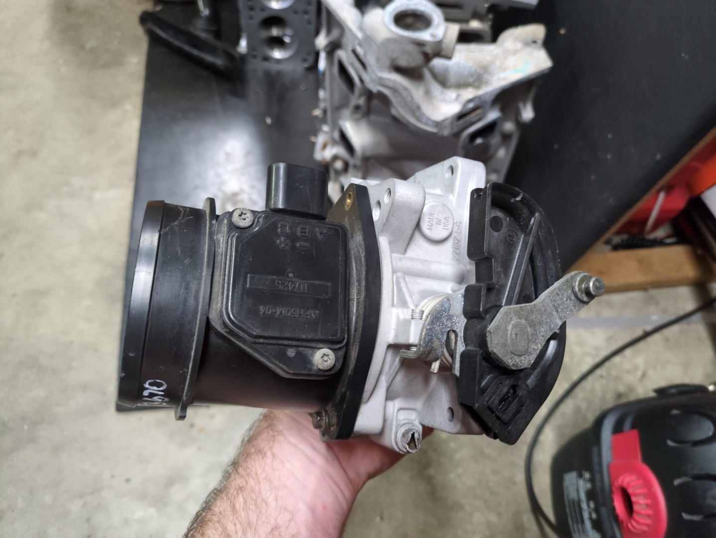

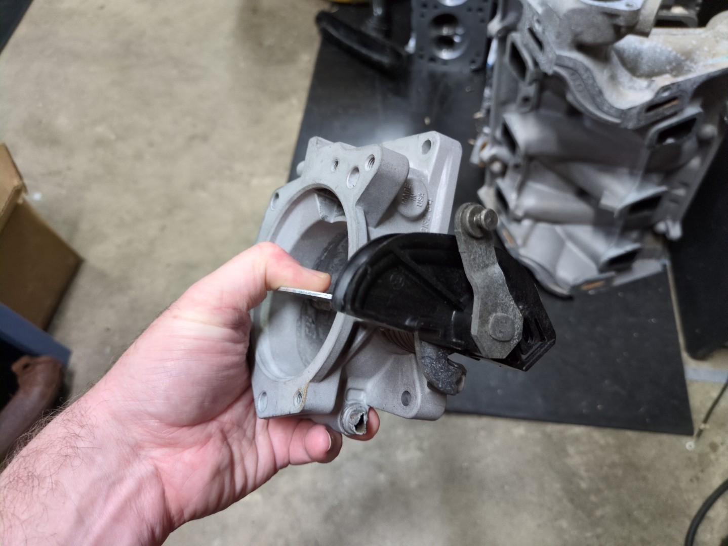

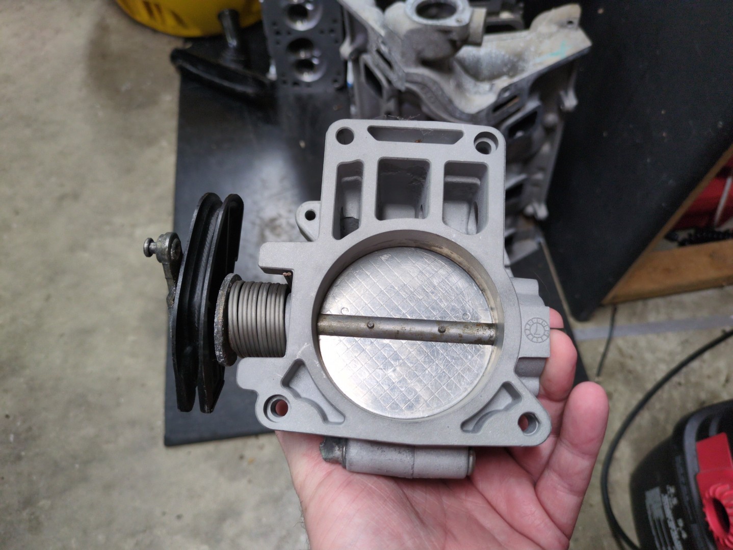

    I will add some pics of the throttle body, and why it was chosen. If there are other throttle body options we should check out, please let me know!

    Got a picture of the specific throttle body this is designed for?
      • 13530
      An upgraded MAF replacement (no MAF, just tube) is available but only used in testing so far.
