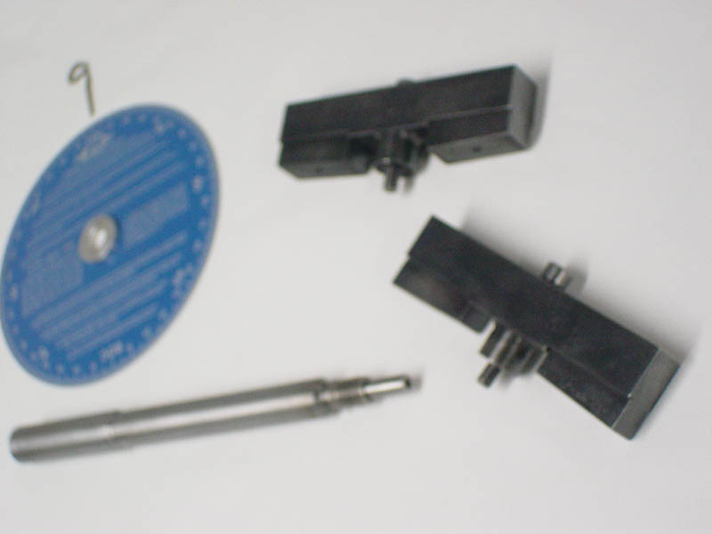

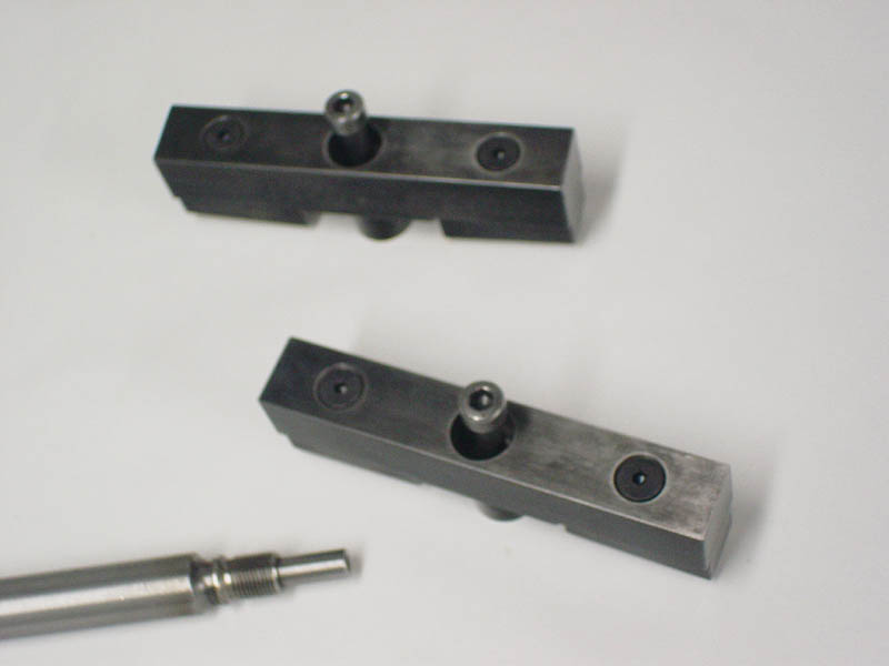

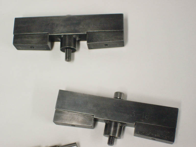

        These are the tools that I made for my cam timing project. The ramps on the hold-down tools are machined to 3 degrees and are accurate to +/- 1 minute. I made the tools with removable timing blocks so that I could make different angles of ramps in the future. The compression stop is self explanitory as is the degree wheel. As I mentioned in my earlier post, using the degree wheel and compression stop, I found the cast-in timing pointer on my front cover to be 2 degrees retarded. This being said, I don't think that I will perform another timing job without using the stop and the wheel.
