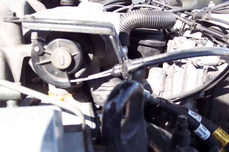

    the throttle cable appears free . anyone seen this before?
    i thought maybe there is something going one with the cruise control. but how would i go about disconnecting it?

    I would pull the IAC and check it and the passage in the manifold as well. I take it no codes are thrown.

        Replace the IACV and clean the throttle. Then do an idle relearn.

            86 i dont know how to do an idle relearn? would you guys explain it for me.
