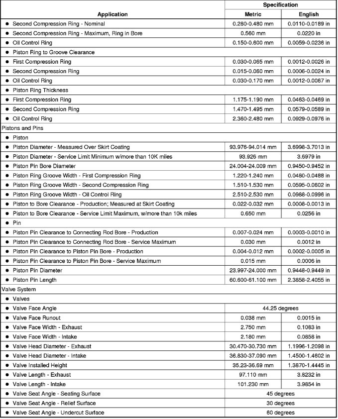

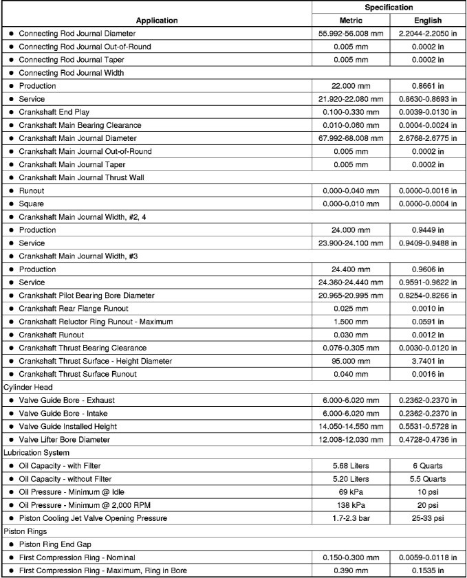

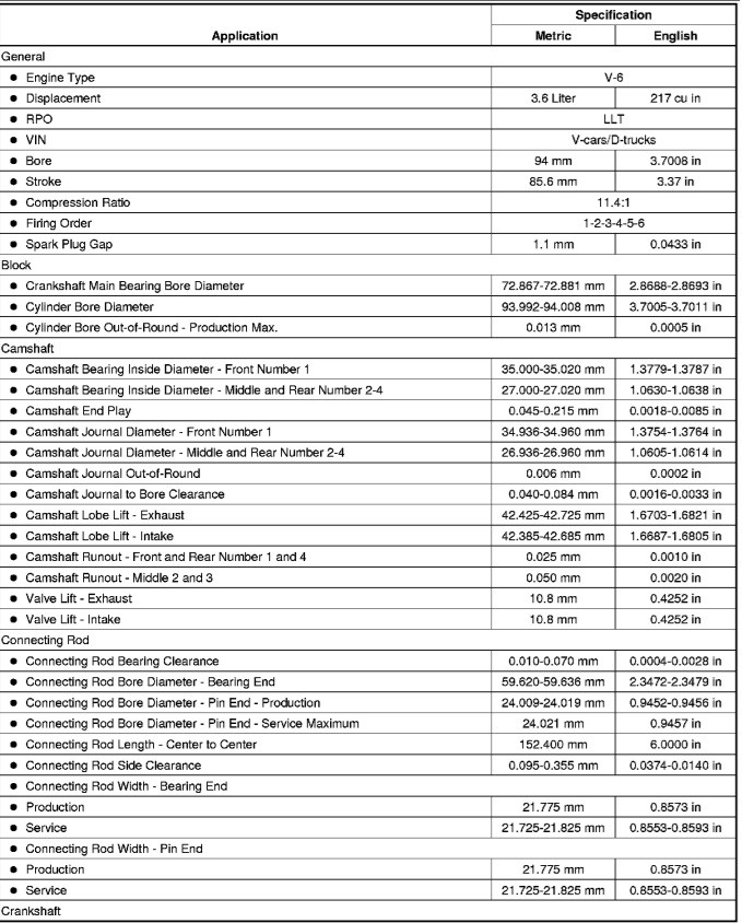

              At one point I found the complete specifications for the 3.6L LLT engine on this site. Now of course when I'm trying to relocate it ... I can't find it. Can someone point me to it again ... please. Thanks!
                • 9191
                I swear it's on here somewhere, but I can't find it either. It should be here: https://www.60degreev6.com/vb5/artic...nt-dohc-vvt-aa

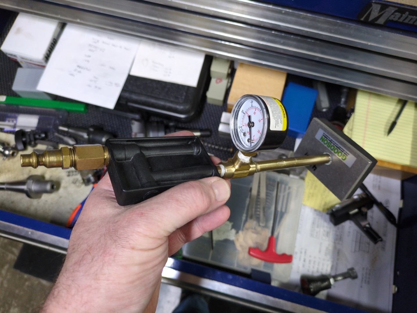

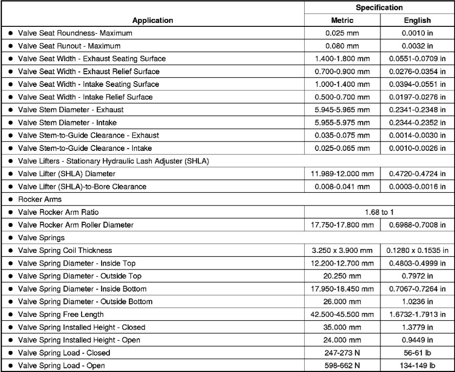

                        Thanks Ben, I would tend to agree with what you said. I think I'm going to lap-in two new exhaust valves and see where I'm at. I don't have a flow bench so I can't vacuum check the valves. Thought I would leave the cams out, temporarily reinstall the heads on the block and do a leak-down check to test them instead. Now I just have to find the specs for how wide the seat to valve contact area needs to be ...
                          • 13534
                          Valve job machines have a vacuum checker built in usually to check the work. I made my own that uses an air compressor as a source.
                          https://www.harborfreight.com/air-va...ors-96677.html
                          Take that apart and use the black piece inside, with some threaded pipe and a vacuum gauge.
                          These plates have a closed cell foam applied for an exceptional seal. Several sizes available. Replacement parts and accessories sold separately.
                          Stick one of these on the end to see up the intake/exhaust ports.

                            I'm not sure I'm following Ben?? Take the air pump apart, modify it with some threaded pipe and a vacuum gauge and put a Goodson foam pad on the end to see up the ports?? Maybe I can find a YouTube video on what you are trying to tell me?? Thanks!

                              Click image for larger version  Name:	LLTSpecs1.jpg Views:	0 Size:	178.5 KB ID:	427496 Click image for larger version  Name:	LLTSpecs2.jpg Views:	0 Size:	189.2 KB ID:	427497 Click image for larger version  Name:	LLTSpecs3.jpg Views:	0 Size:	198.0 KB ID:	427498 Click image for larger version  Name:	LLTSpecs4.jpg Views:	0 Size:	226.5 KB ID:	427499
