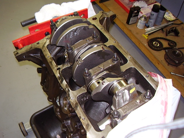

      Where are you sending these? By the way the stock rods are forged, all you have to do is shot pean them and they should do the job, as far as pistons you can get hyperutectic by sealed power. They even have the anti-friction coating on the side.here is a pic

        it wont let me post the other two pics.
