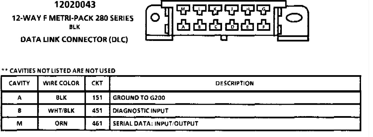

You need to wire the ALDL connector and take a look with a scan tool or laptop to see what is going on. It will be more expensive to start guessing and throwing parts at it. It might be as simple as miswired connector.
if you need diagrams from any 82-02 GM car, i've got them...
more?Attached Files
