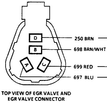

    a way to test the EGR is to connect pin D to a good 12volt source, and then connect pins A B and C to known-good grounds(one at a time) to see if a certain valve is sticking.
    EDIT: if the lead arcs and you don't hear the solenoid move, its bad. you should hear it easily if the engine is off.

        test them the way i described, or if you have a tech1 or 2, do it that way. with the tech tools, you open the valves when the motors running. solenoid 1 should make it stumble noticeably, solenoid 2 should almost kill it and solenoid 3 should kill the motor unless its got a VERY tight tune...

          I ran your test, all 3 solenoids seem fine, opens and closes fine, took a little carb cleaner and cleaned out the inside and the diaphram of the solenoid with open/close test and cleaned most the carbon out. Ran a idle re-learn and now it seems to be running fine without stumbling! Its amazing what 20 minutes of your time can make a difference. Now to the sticking tach prob.
