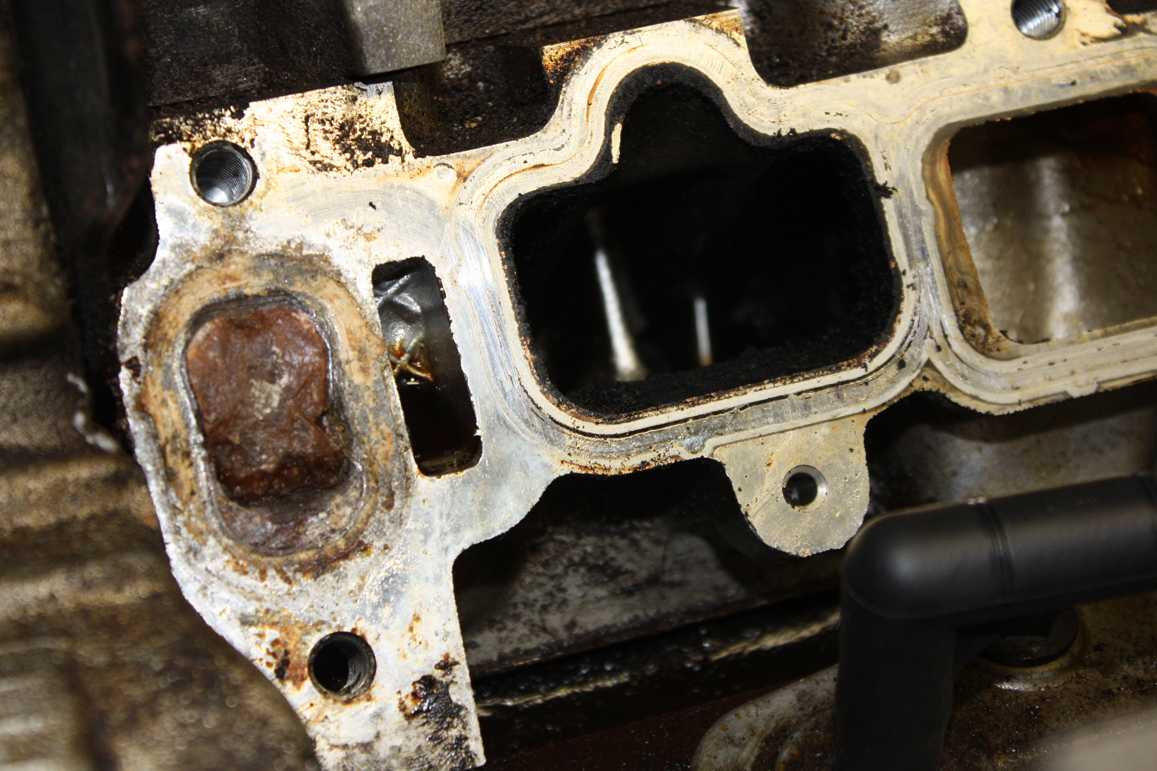

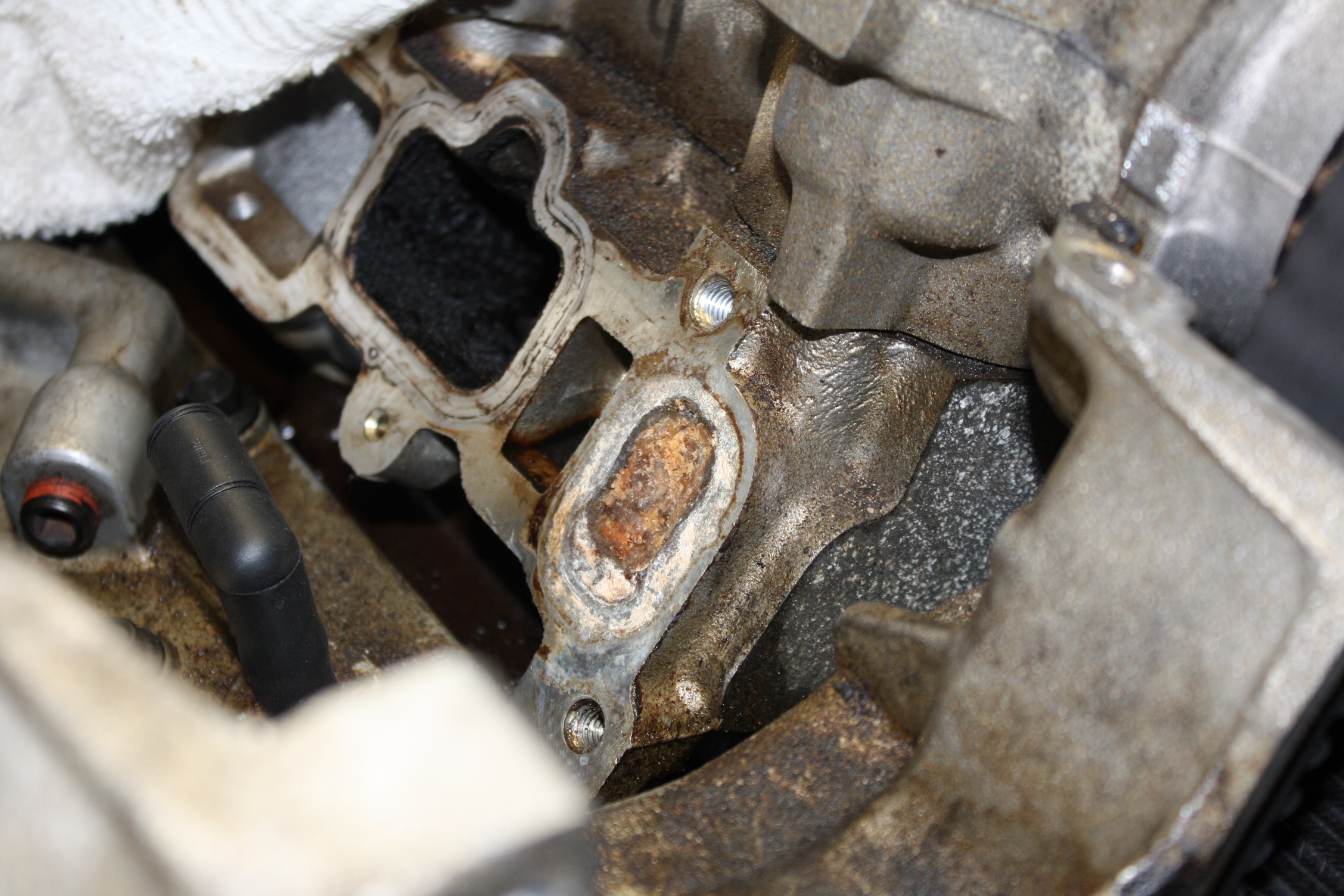

      Thanks for the offer of help. I've attached 3 photos, showing the right and left heads and the ports in question and one of the intake manifold where it mates to one of the head ports. The stuff feels just like wax and you can scratch it off just like you would wax on a candle. I can't imagine it is straight parafin or wax though as I doubt it could withstand the 190 degrees of the coolant without melting. Is it possible that its a buildup of some kind? All the other water ports are as clean as a whistle, though. It looks like there is no port on the intake where it meets the head ports in question. Click image for larger version

        That be the old orange Dex-cool coolant. Clean as much of that as you can out and when you get your engine back together, flush the coolant system and go green.
        • Mjkanejd
          • Aug 2010
          • 4
          Thanks very much. I cleaned it out and everything looks fine.
