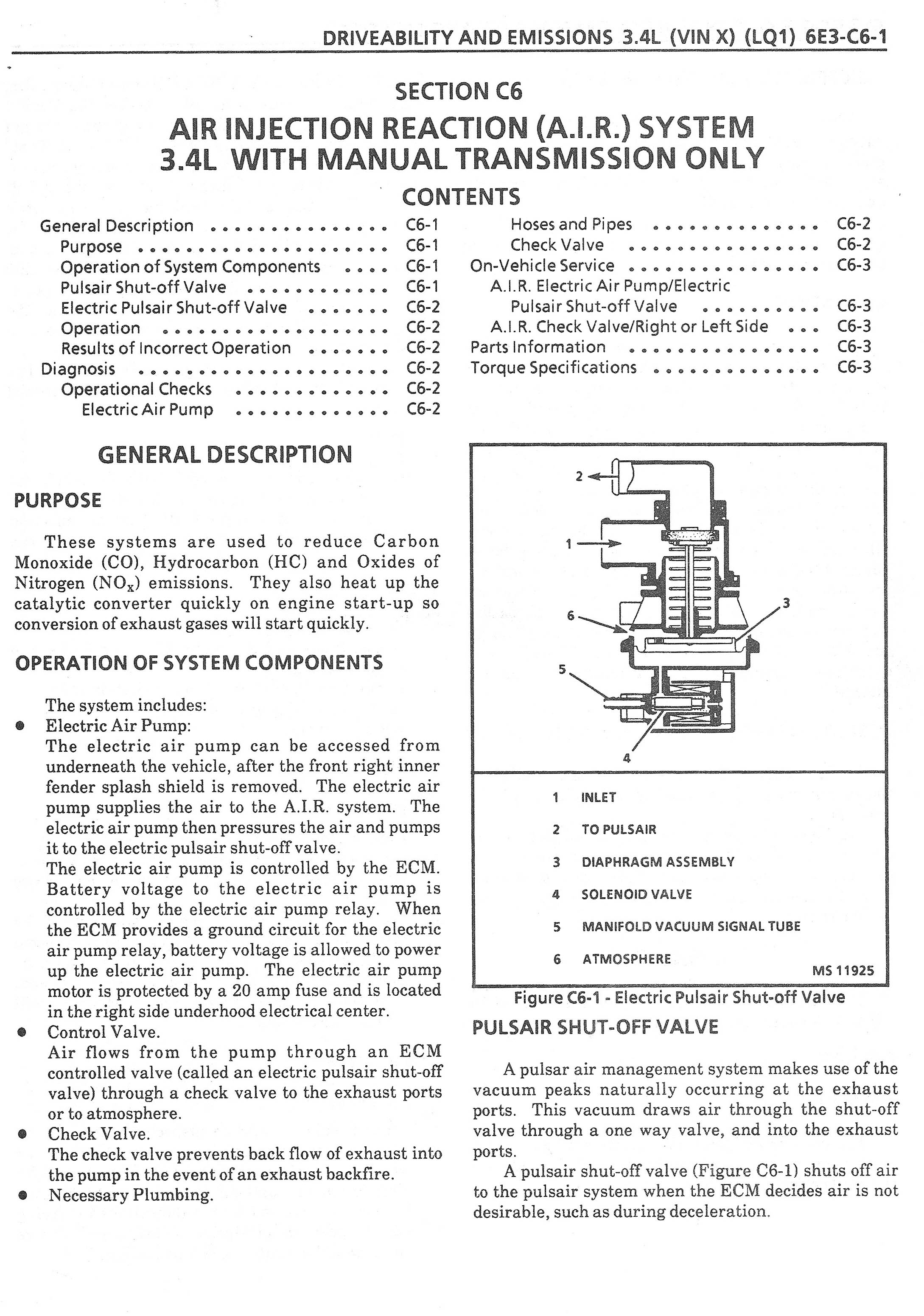

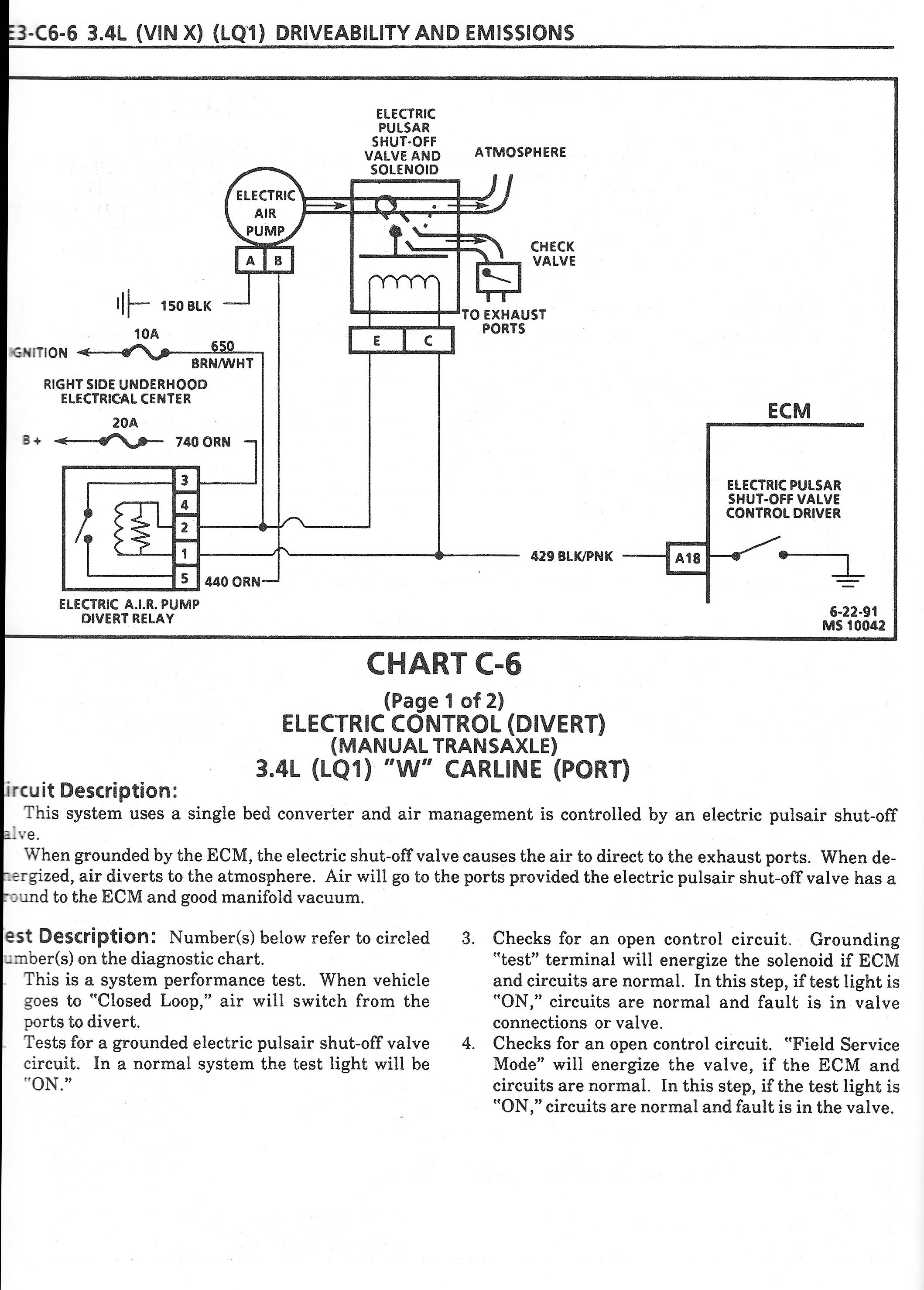

    My 91 gtp came with an AIR system on it and previous owner had it disconnected. I have not been able to find any into on it in any on my searches hints? Also how important is it that I have it connected ?

      There is information in the shop manual. If you'd like I can scan the available pages.
          that would kick ass

            I'll get it done tomorrow.

              Is there a way to shut it off on OBD-II? I know the code can be shut off with a DHP (which I have), but that's not going to stop the PCM from trying to run it and I could see this messing up fuel trims as it thinks the pump is there.

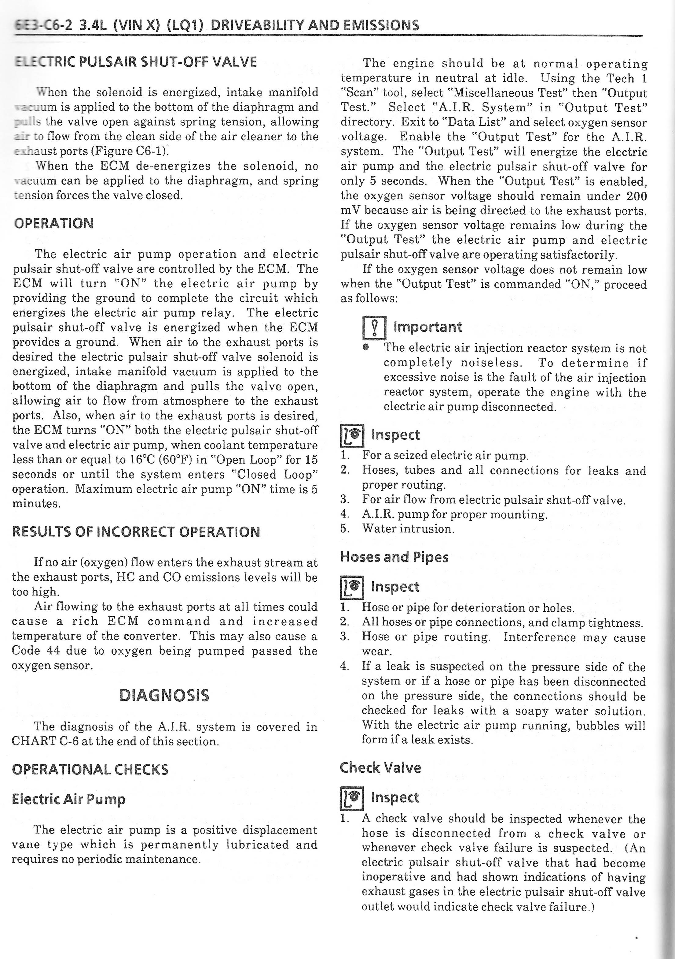

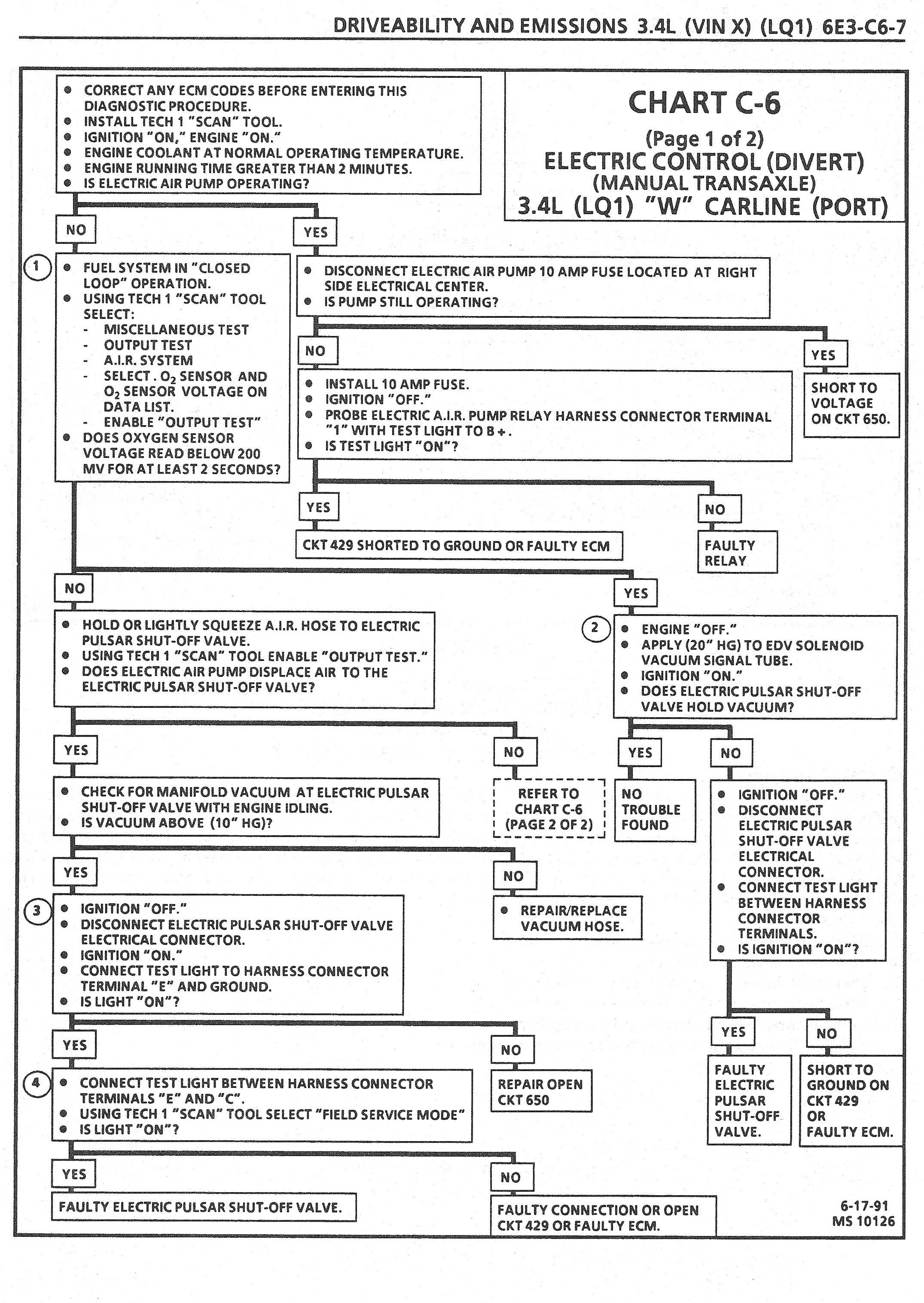

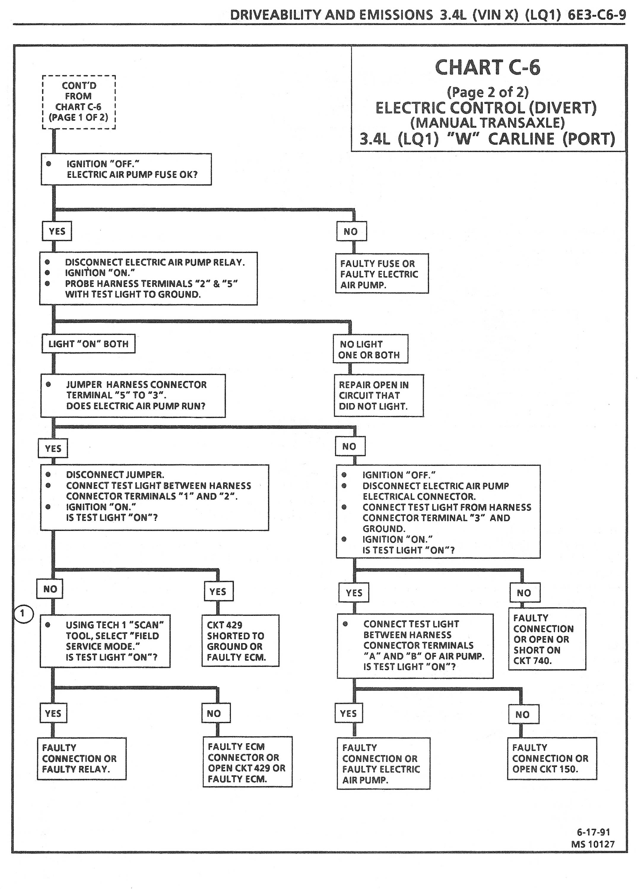

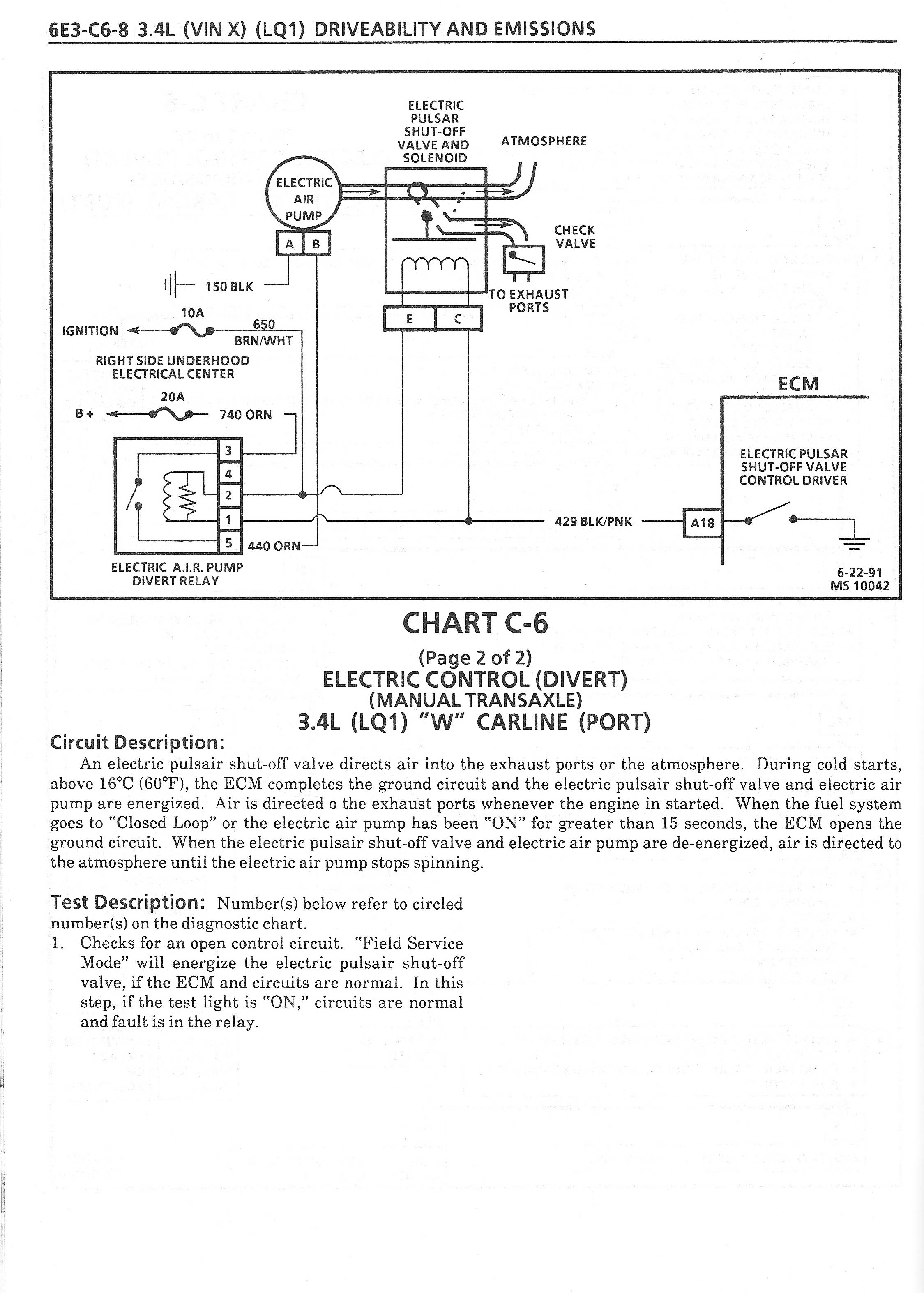

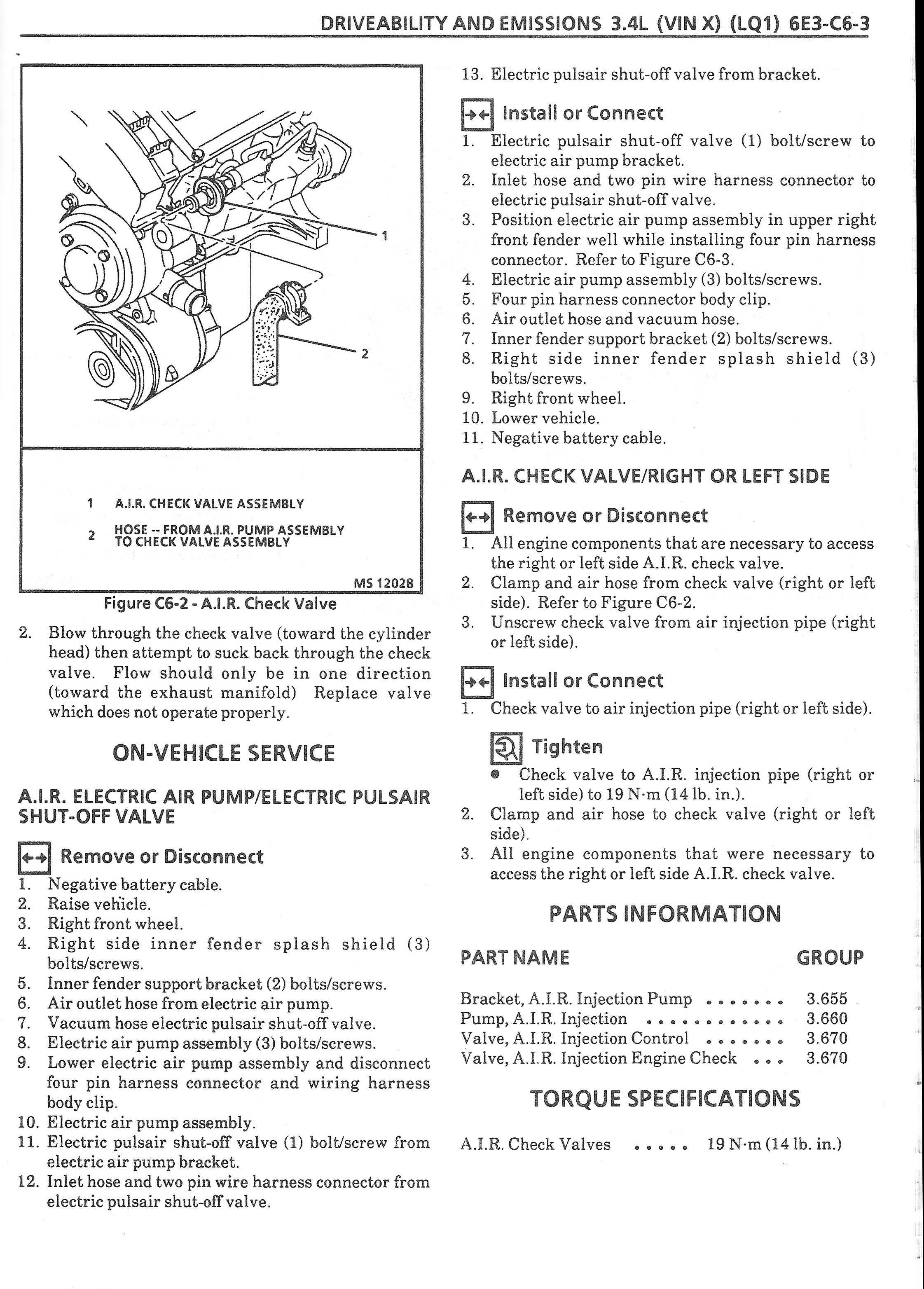

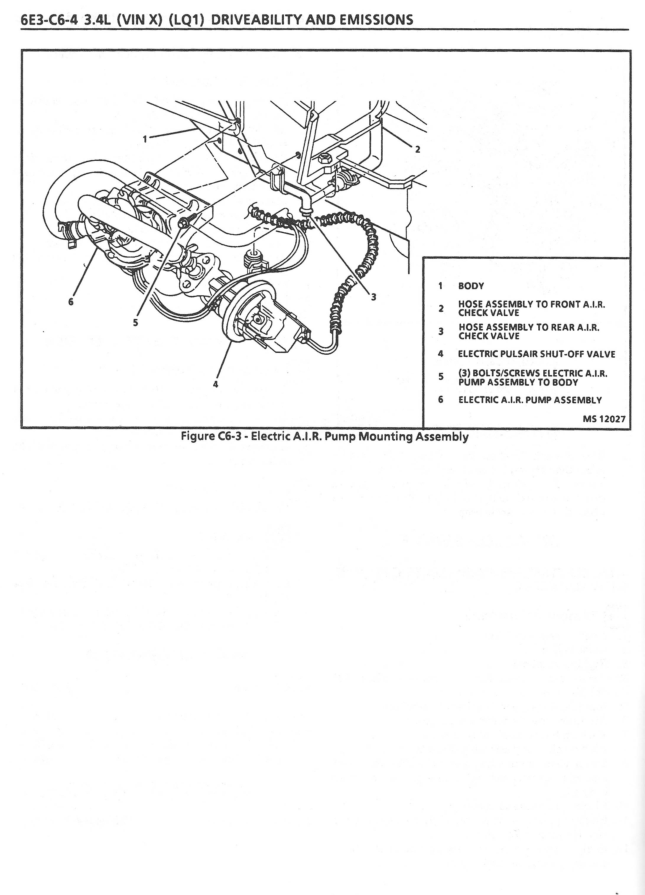

                This is from a 1992 Lumina service manual. Hope it helps.
