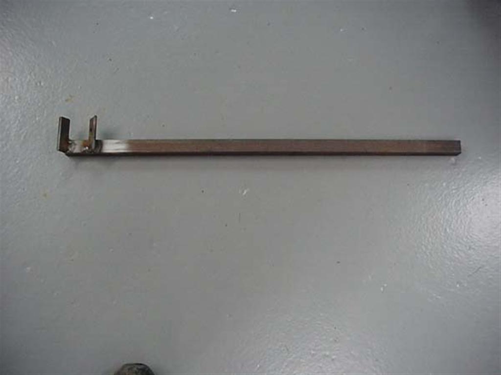

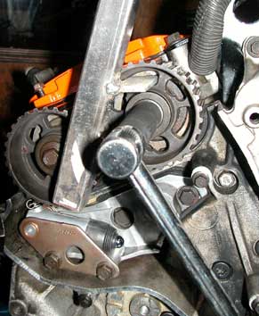

            STOP WHAT YOU ARE DOING!!! DO NOT use the cam hold down tool to loosen/tighten the cam gears.. They are NOT designed for that and could cause MUCH trouble... There is a tool to hold the cam gears for tighten/loosen.. They can be made fairly easily... The hold down tools are just to make sure the flats are lined up and should NOT be torqued, just good and tight. I've heard of the hold down tools bending, the cure is to double up on the keystock pieces,,, AND don't over tighten. I have heard of the threads pulling out..
            I've got to go out for awhile,,,, later I'll find a pic of the cam gear holding tool and post it for you.
            As a suggestion PM pocket-rocket and have him outline step by step EXACTLY how to time the engine. He IS very knowledgeable and can explain the process so that you can understand how and why it works...
            I'll get back later,,, I just wanted to make sure you didn't do any damage...
            Good luck,,,

                I DIG!!! Just you were sayin the keystock was bending and I saw the threads getting stripped out... Really not the biggest problem you could have,, worse case a drill and a heli-coil would fix you up... But that is more work than I want to do,,, if I don't have to!!
                To be perfectly honest I haven't done this job yet... Although I've worked on much more complex valve trains than these.... I was a bike mechanic for many years and Ducatis were one of the bikes we specialized in... They use a cam and rockers to open the valves and another cam and rockers to close with VERY light valve springs for idling... Lots of fun setting all that up!! I know/understand what has to happen, just without doing it myself I wouldn't want to give advice.. That's why I suggested Jon (pocket-rocket)... He's done plenty, but more important he does the best job of explaining the process I've come across...

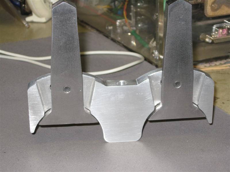

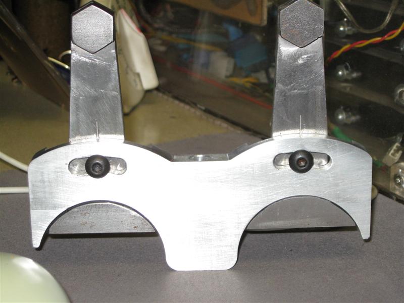

                Well now I babble.... Here is a couple of pics of the cam gear holding tool... Also a couple of pics of my adjustable cam timing tool.... That's for custom cam timing.....

                              That Kentmoore kit looks like it has everything, IF you want to spend the $$. As Brad said, all the required tools can be made. As far as the Cam "Timing" Tool, or Cam Hold Down Tool, it is exactly the way it sounds. It is for timing the engine,,, that's ALL... You see, the 2 camshafts (in EACH cylinder bank) have a "Flat Spot" on each cam. The "Timing Tool" clamps across these flats and holds them in place so the camshafts can NOT move. The camshafts are now locked in the proper position. With the lock rings removed the engine can be turned to line up timing marks or better yet a degree wheel, without the camshafts moving. THIS is how the timing is set. To remove the cam gear bolts I STRONGLY advise using a tool to hold the gears or you will probably bend the cam hold down tool or strip out the threads that bolt the tool down.... If the tool gets bent it could throw off the timing... As the cam flats may no longer be lined up....
                              The adjustable tool allows you to set the timing to a custom/non stock configuration... That tool was part of a group buy and not really easy to get ahold of. Every now and again someone lists one in the Buy/Sell Section.... The automatic trans LQ1s seem to like the 6 and 6 setup,,, that is one cam advanced 6 degrees and the other retarded 6 degrees. Forget which is which tho.... The manuals like a different configuration....
