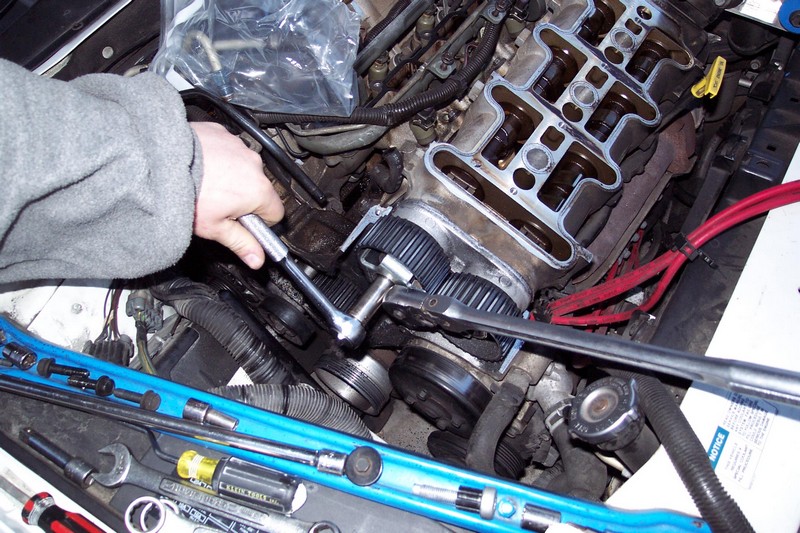

          As far as the other parts, the only one you need is the cam GEAR holder (different than the hold down). It holds the cam gear in place so when you are honking down on the cam gear bolt you don't rip the hold down threads out from the torque. It has 3 fingers and fits into the holes on the inside of the pulley. You won't need pullers because 94+ engines don't have lockrings like the 91-93. They have tapered collettes that hold the gear in place on the end of the cam by way of friction from the bolt. Simply loosen the bolt, take a 2x4 and put it on the back side of the pulley (drivers side) and smack the end of the 2by with a hammer to knock the gear loose.
          In this pic you can see the guys right hand holding ratchet attached to the cam gear holder and the socket for the cam gear going through the hole on the holder.
