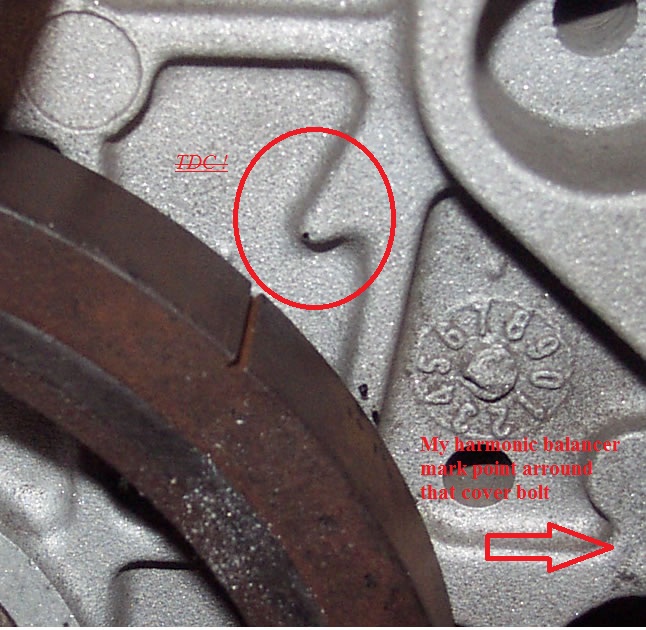

    Second: harmonic balancer mark like 25* off the mark in cover. possible bad balancer ? can be used anyway ?

    Get a new balancer if its not the chain or some other issue throwing that timing mark off. The rubber may not be solid to the metal any more otherwise.
    6/-6 and 13 degree exhaust retard are in crank degrees. The width of the timing mark is 1 degree, so you could make new marks if you wanted. Autos like advancing the intake 6 degrees and retarding the exhaust 6 degrees. Manuals can use the higher RPM better for 13 degree exhaust retard, stock intake. Idle is a bit rougher but I am happy with it in my car.
    Doesn't matter which bank you set first as long as you set 1 bank, rotate the engine 360 degrees, and then do the other bank. I like to do the rear bank first.

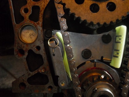

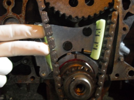

                        Cloyes timing set. Things are getting a little infernal hard. The tension in the timing chain, can't even fit it in place. (pic)Click image for larger version
ID:	377158Click image for larger version
