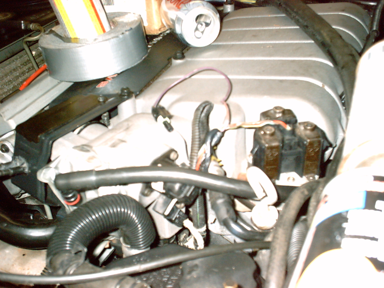

                  Here's a crummy pic I took a while ago... As Jon said,,,, the IAC is the top one.....
                  Here is a process to relearn the idle,,,, at one point that helped my 93.... I used the second method... Didn't hurt,,, anyway!!

                    Thanks for the pic. Are you referring to the piece behind the vacuum tube with two bolts on the "wings" of the part? Do I need to replace it? What is the pintle and passage?
                    Tom
                      Yes, that is the part. I would try pulling it out and cleaning the pintle songs passage with some carb cleaner before replacing it. The pintle is like a plunger on it that moves in and out to control the air flow aroun the throttle body to control idle, like a controlled air leak. The passage is the hole it is in. It could be binding up from carbon deposits.
