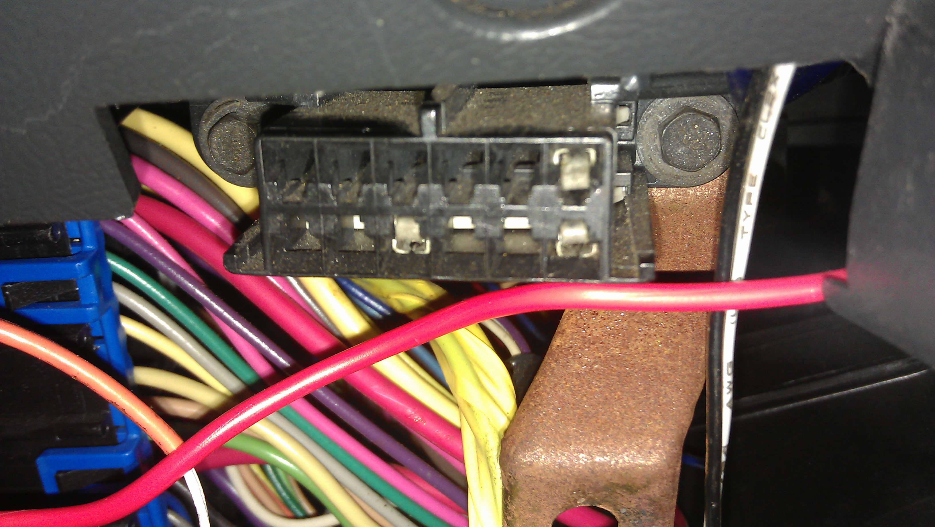

          Well, I checked this out 2 weeks ago, but I barely have time for forums nowadays.... the car still does the stupid weird idle whenever it's cold but I did find the ODB connector.
          Now here's my problem... From what I've read around in forums, there's supposed to be 4 connectors, and the 2 on the top of the connectors are supposed to be jumped. Ok, cool no problem, but my car only has 3 plugs.
          Here's a pic of it
          So as we can see, there's only 3. I tried jumping the 2 in the corner and nothing happened. I also tried jumping the 2 on the bottom and same result.
          Now, on this specific car (1994 Olds Cutlass Supreme), is there a specific way to get the light to blink, did the p.o. decide to screw around with the wiring, or is this car ODB1.5?

            It may be time for you to buy a GM service manual.
            Don't forget that rough cold idle is a hallmark of rotted lower intake manifold gaskets.

                  One thing you have to remember, we're talking LQ1 here.... Some things are VERY different from the 3x00s... If a LIM gasket goes it won't get oil in the coolant or vice versa... The only coolant related thing is the short hose between the LIM and throttle body,, unlike the 3x00s where the LIM has coolant running through it and the gaskets are exposed to the oil... You need to take off the Upper intake mani to get to the lower... The upper mani is that metal thing you were talkin bout... Not too bad of a job really.. The gaskets seem to go fairly often... I did 2 on the original engine and it seems the new engine has that problem as well... For the life of me I can't find a leak, but there has got to be one somewhere... I'm going to try it with propane... Going to run a hose DEEP under the UIM and saturate that area...
                  I believe 94s were OBD1.5,,, so to speak... I think the way you'd have to get codes would be with an ALDL Cable and a laptop... Pretty sure you can't jump A-B and count flashes like with OBD1.. Professional scanners are VERY expensive..
                          I should have known better... So in a nutshell.... driving this car like this; what am I risking here? How bad can the damage get if I keep ignoring it? Or better said, what can get damaged if I ignore the LIM gasket? Besides the car boggling and feeling like a cylinder isn't firing right at idle, the exhaust smells like gas. It kinda reminds me of those old school cars without the cat. Another thing that bothers me about the situation is that sometimes the car feels hesitant. As if it doesn't want to move. IDK if that's the trans limiting the engine (I know the trans in that car wasn't GM's best at the time to handle the power of the LQ1). Then there's 70MPH @ 3500RPM. Isn't that a bit ridiculous for this car with the top up?
                          I think I got to everything,,,,
                          GOOD LUCK,,,,
                          Tom....
                          From what the people on the W body forum are telling me, apparently, no W body came with 1.5. IIRC that mostly applied to the N bodies than the W ones. I may be wrong, but I'm just restating what most have told me about the W and ODB

                            "OBD 1.5" is a TOTAL NON-ISSUE if you have a REAL scan tool. You'd never know there was such a thing as OBD 1.5, except shitty consumer-grade code readers and scan tools aren't sophisticated enough to work properly.
