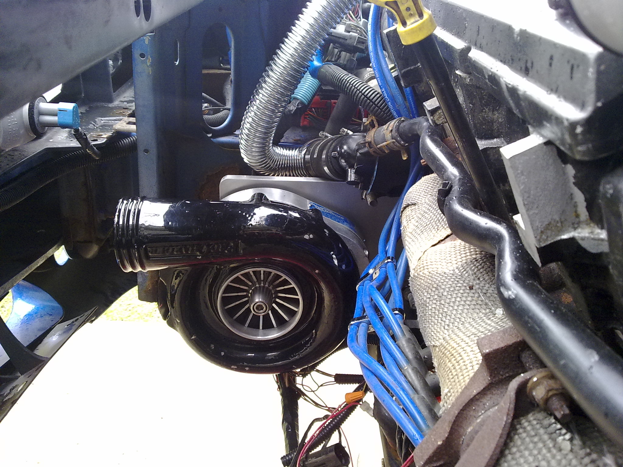

                    kinda like this, sorry its sleeping under a garage right now but i've had it done since the starting of spring and never got around to taking pictures of it and had to dig up this one. and about 300hp maxing out and what not, what about gearing???? that doesn't make sense. 3800 gtp's that are fwd that run 11's and 10's. proven anything is possible. suspension, gearing and tires helps you get thoughs numbers. a 3800 on f1 tires (street legal) ran 12.7 1/4 time and yea is squawked bad and still made that time. I know it can be done cause I was the one who built up that gtp..

                      I would not be affraid to run the intermediat shaft with the charger like the sho has it.. Keep the carrier bearings greased and your fine. Some have a housing over the shaft some don't. I strictly used this pic to show an example of it..
                      The issue i see with mounting it in place of the A/C compressor is space.. It would be awfull close to the rad/fans and you would have alot of piping, not to mention the piping would run right past the exhaust manifold and heating up the charge...
                      Here is an example with the housing over the shaft. RIPP charger for a 3.0L Eclipse

                        You just run a shorter thicker rad on the other side and run the piping forward in to a IC and out the other side and up were the battery is and in to the TB. That's vary easy to do. The only thing that concerns me with his rig is the cast alum on the timing cover. There are just 3 bolt holes and none are vary strong. But if he add more bolt holes and a brace to the engine block or if he has the money build a new timing cover he be all set.

                          dave called it out just right about the piping location. the three bolt holes work out great. they held up fine we put enough pressure on it so that there's no way its going anywhere.... I'm a toolmaker and ase tech. i fabed this bracket with t6 aluminum. the intake piping..... ahuh look at the pics again it runs right in front of the vents, its not even close to the exhaust manifold.. the radiator is mounted to the right of it. a custom air filter was made cause it was cutting it close. i'll have to get pics posted later when i get a camera again for you to understand

                                I just looked at my spare block I see what you mean that should hold nicely
                                Still a brace to the engine block would help. Another concern is engine movement. Just make sure you get a nice flex silicone joints or you may tare the ic up. Engine may twist 10deg or more. I like it!
