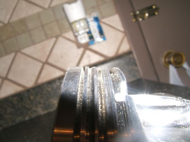

                Nope, it hasn't been brought up regarding 60V6s that I know of so I wasn't aware of the vette issue. I know that the 3.6 pistons have an accumlator groove. Found this on the topic
                "Accumulator Groove is the groove between the 1st and 2nd compression ring. It does make the piston lighter, but the real purpose is more abstract. Pressure spikes that get trapped between the 1st and 2nd compression rings tend to unseat the top ring. This action encourages ring flutter and loss of piston ring seal. Past efforts to reduce ring unseating pressure have included increasing the second ring end gap. Now, with the addition of the accumulator groove, ring flutter can be controlled in all engines. The void created by this groove between the rings tends to average the normal pressure present, keeping the pressure low enough to prevent lifting the top ring while maintaining some preload on the 2nd (oil scraping) ring."
                How will this fare with gapless rings? I plan to run the 3.6 pistons in a 3500 motor with some modification to the pistons to lower compression. Really wasn't planning on new rings but someone else might. Has there been anything done on this setup?
                  • 9190
                  Here is a picture of the 3.6L piston Ben was talking about...
