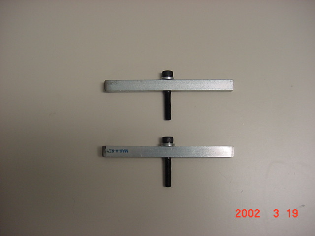

    In a pinch it's easy to make your own tool. All the links to the info don't work, guess that hasn't been updated yet.... Anyway,,, I happened to save the text:
    "The specs for my home made tools = 1/2" x 1/2" x 6" key stock with 5/16" hole in center. Bolts are M8 x 1.25 x 50mm, two washers are needed on each. Sorry about the dark pics, flash was not working for some reason."
    Hope this helps,,,,,,
    Tom
    PS,,, Also found the pic....

      thanks I'll give it a try with that
