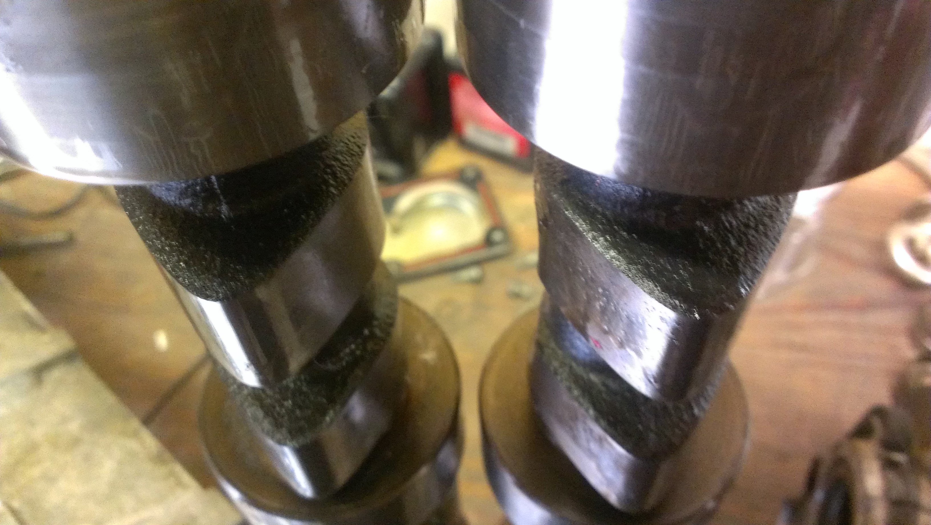

        Slight update. I pulled the rear cam carrier off the 97 engine today, and decided to tear it apart to see the differences between the two cams. As you can see in the picture shown below, the 97s exhaust cam (left) does appear to be a bit less aggressive than the 95 (right). I've since proceeded to install the 95 cams in the 97 carriers, so I can still retain the lighter 33mm lifters and the 96-97 cam cogs. I have to reinstall the back carrier tomorrow, then swap the 95 cams over to the front carrier. I should be putting the engine back in soon, and I'll be sure to share my results.

            Looks the same to me. If you want to know for sure, send an intake and exhaust cam out to get speced. I have the 91-95 specs already and it was 25 for each cam plus shipping. I seem to recall the 96 and 97 engines only having a timing change, not a lift or duration difference.
            Also your 95 cam looks pitted.
