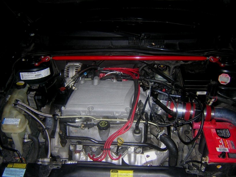

    OK, so I've finally done it. Yeah I know others have already done it but I've been wanting to do this for over a year now(and have had numerous financial setbacks) - and I might be the only one doing this on a stock tune PCM... for now at least... the demise of DHP's Powertuner has made me re-think my tuning options. For now, it runs great(even with leaking injectors). It was quite an ordeal though, not what I would call easy but SO WORTH IT! I'll post up more pics tomorrow, for now enjoy this one and feel free to make any comments/suggestions you might have.
    P.S. Ben, I had to do a significant amount more grinding to clear the FPR; nor sure what your test fit motor was but it was way off when I first tried it.
    -RUSH

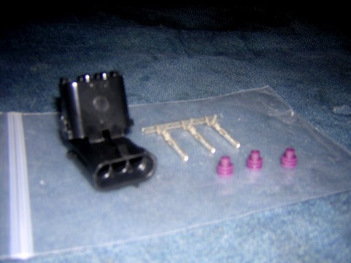

                    The 3500 MAP sensor pigtail.
                    -RUSH

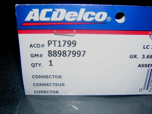

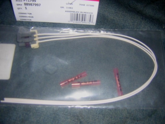

                      • 13531
                      How much was that? I can get a harness adapter to go from the old type to the new type and not have to solder/crimp anything.
                      • SE'sarecool2
                        Gearhead for life
                        • Jan 2006
                        • 76

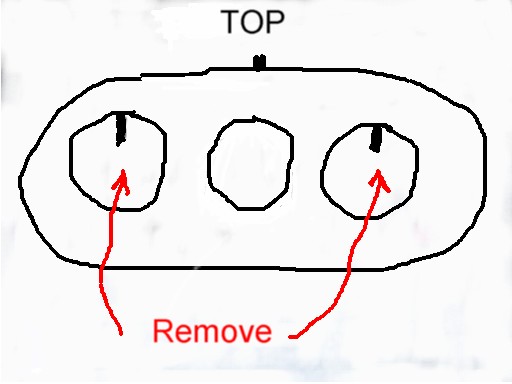

                        The connector I got from EFI Connection; thanks to Isaac for finding this source. It was too cold to go junkyard hunting for it. Slight modification is needed to make it plug in properly though. There are two index ribs inside the connector that must be removed.
                        -RUSH
                        • SE'sarecool2
                          Gearhead for life
                          • Jan 2006
                          • 76
                          It was kinda expensive(about $25)but I had a connection(my brother works at a GMC/Pontiac dealer)
                          -RUSH

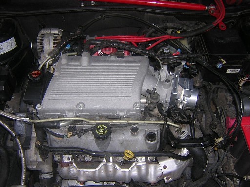

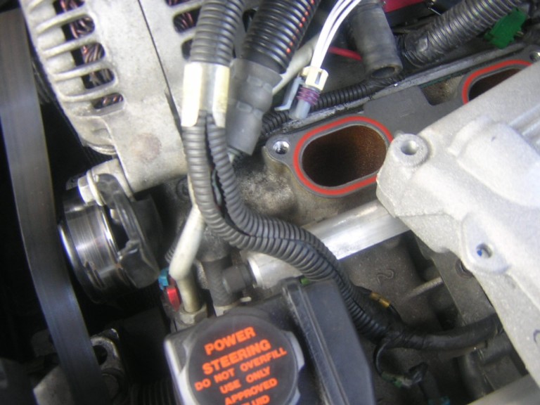

                            Another hurdle was moving the p/s pump out of the way so the injector harness could go under the fuel rail; otherwise it would've been pinched between the UIM & the p/s reservior
                            -RUSH
