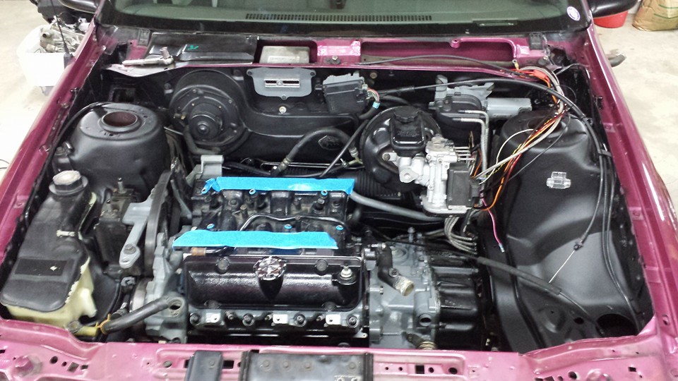

                    Other updates Drive line in

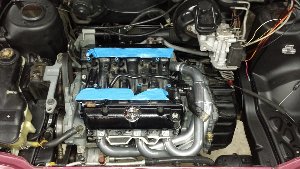

                    Headers on for looks...

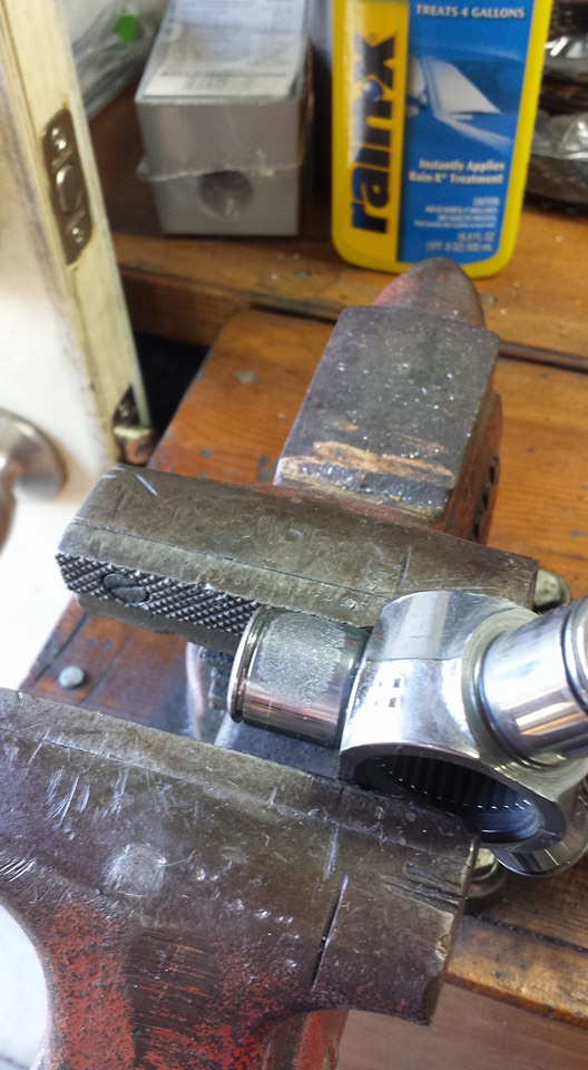

                    And wear I found on my old tripod from my axles...

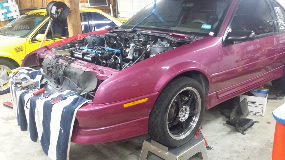

                    I love doing things twice so with that being said... I installed all the suspension components so I could set the car at ride height and measure axle lengths...

                    I will be re-moving the suspension again tonight to clean it up and prep for new rear bushings. I'm hoping the axle length I need and parts necessary will have some combo out there and not require a custom length shaft but if it does, I'll just swap the stock diff back in and run what I had in there last year for axle lengths till I can get the new ones... And worse case I drive it to MS like that and just don't drag race. Very disappointing about that, but I guess that's what I get for being the only one to try this shit...

                      Um....yeah, I'd say that tripod has seen some abuse.
