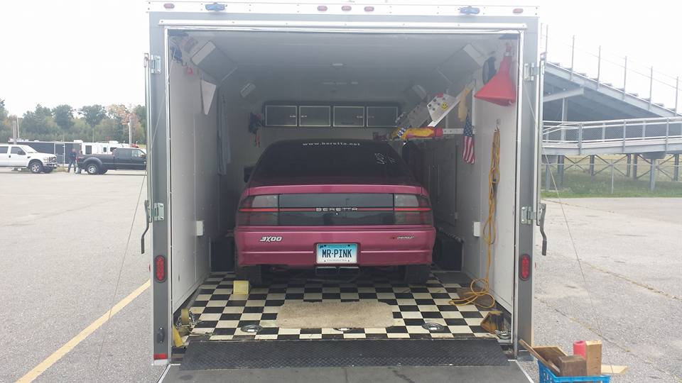

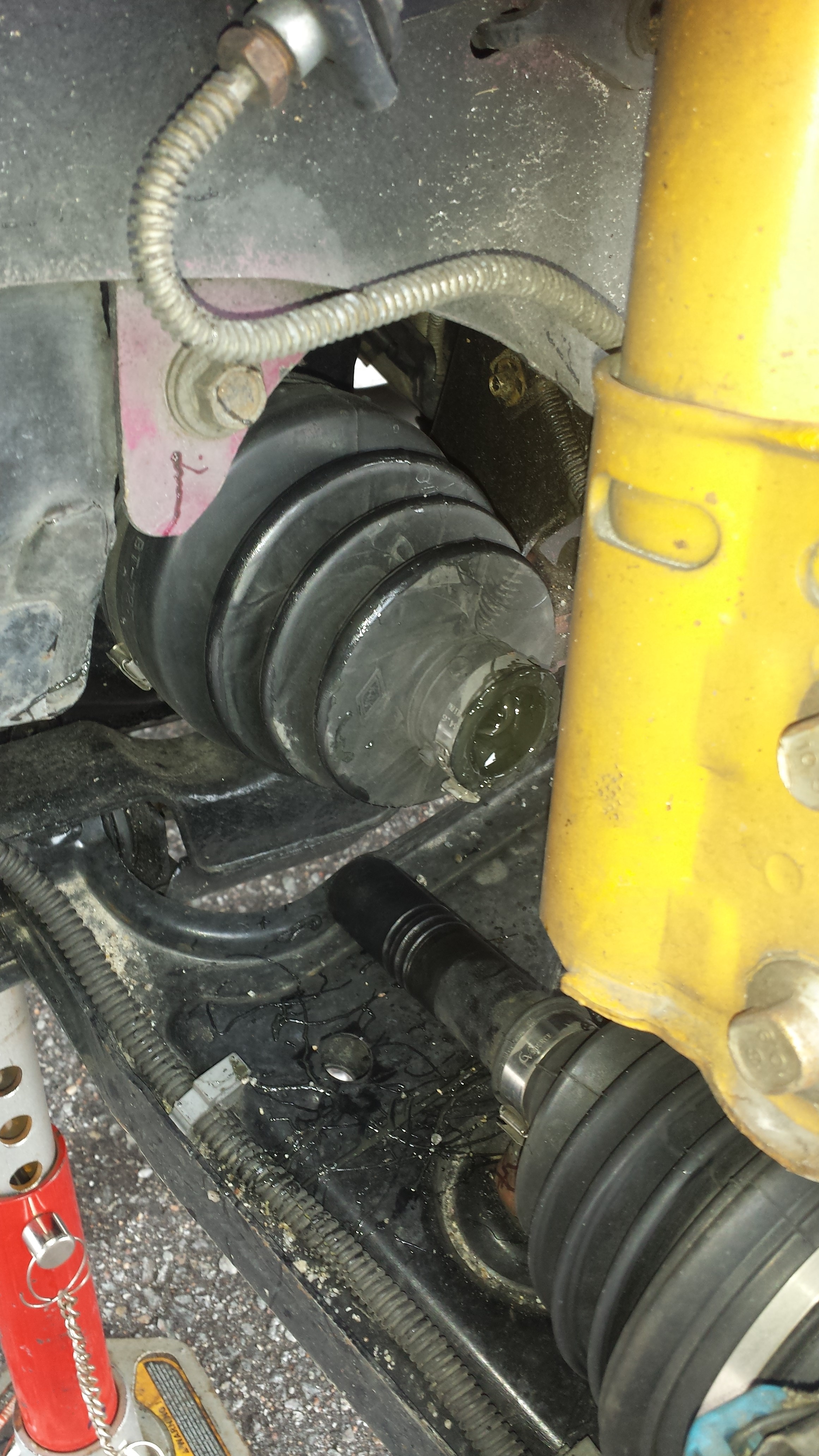

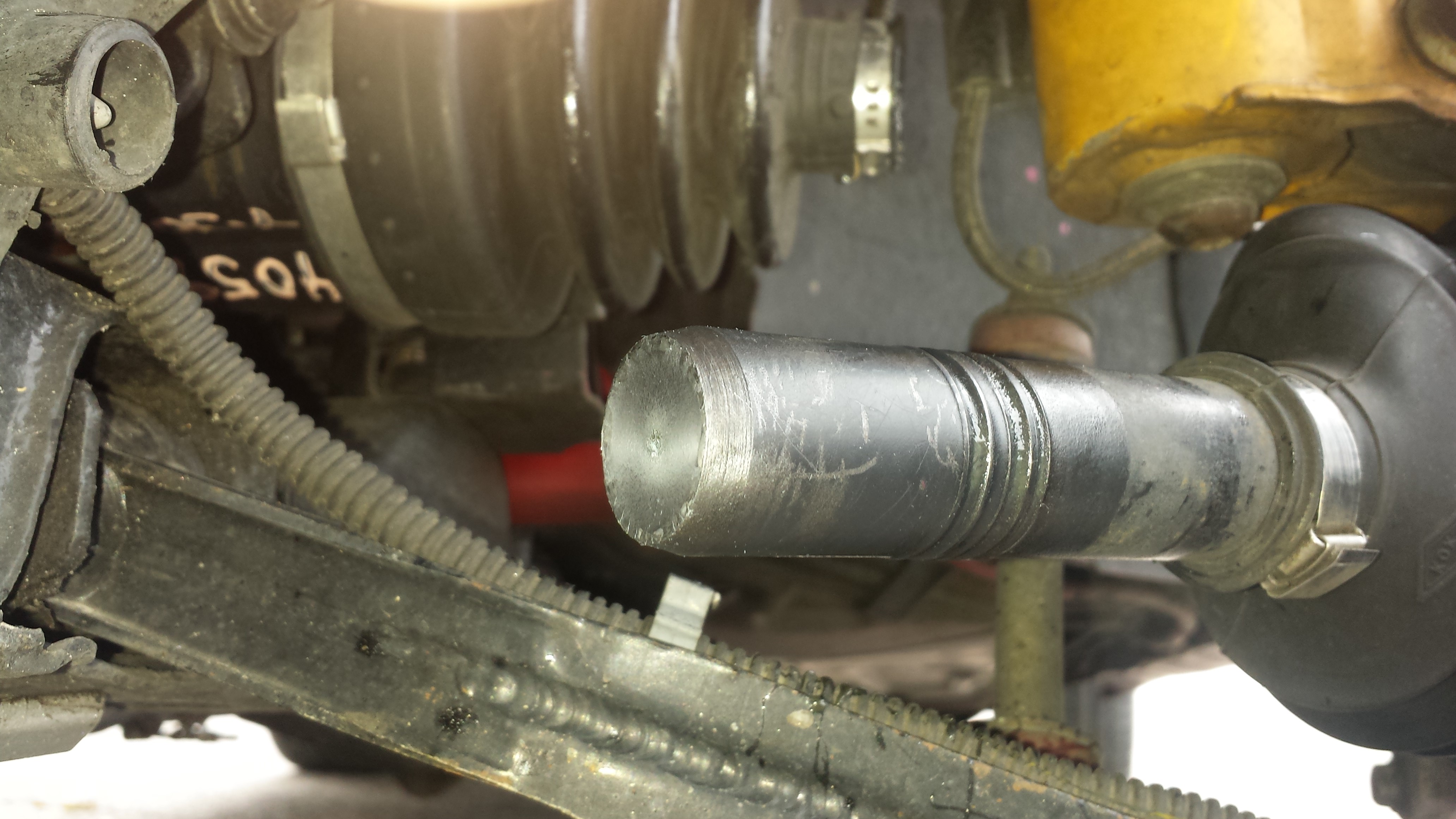

      SO... finally got a chance to bring it to the strip.... Didn't even make it off the line.

      Talking with CV Source to find out what bar he used in my axle, as well as if he has any ideas for longevity... And i have feelers into Driveshaft Shop and RCV Performance for the bar only and not the CV parts since I have that already.

      Had to drive all the way home with the Forester and camper and borrow a friends truck and enclosed trailer. 6+hrs of driving that day.
