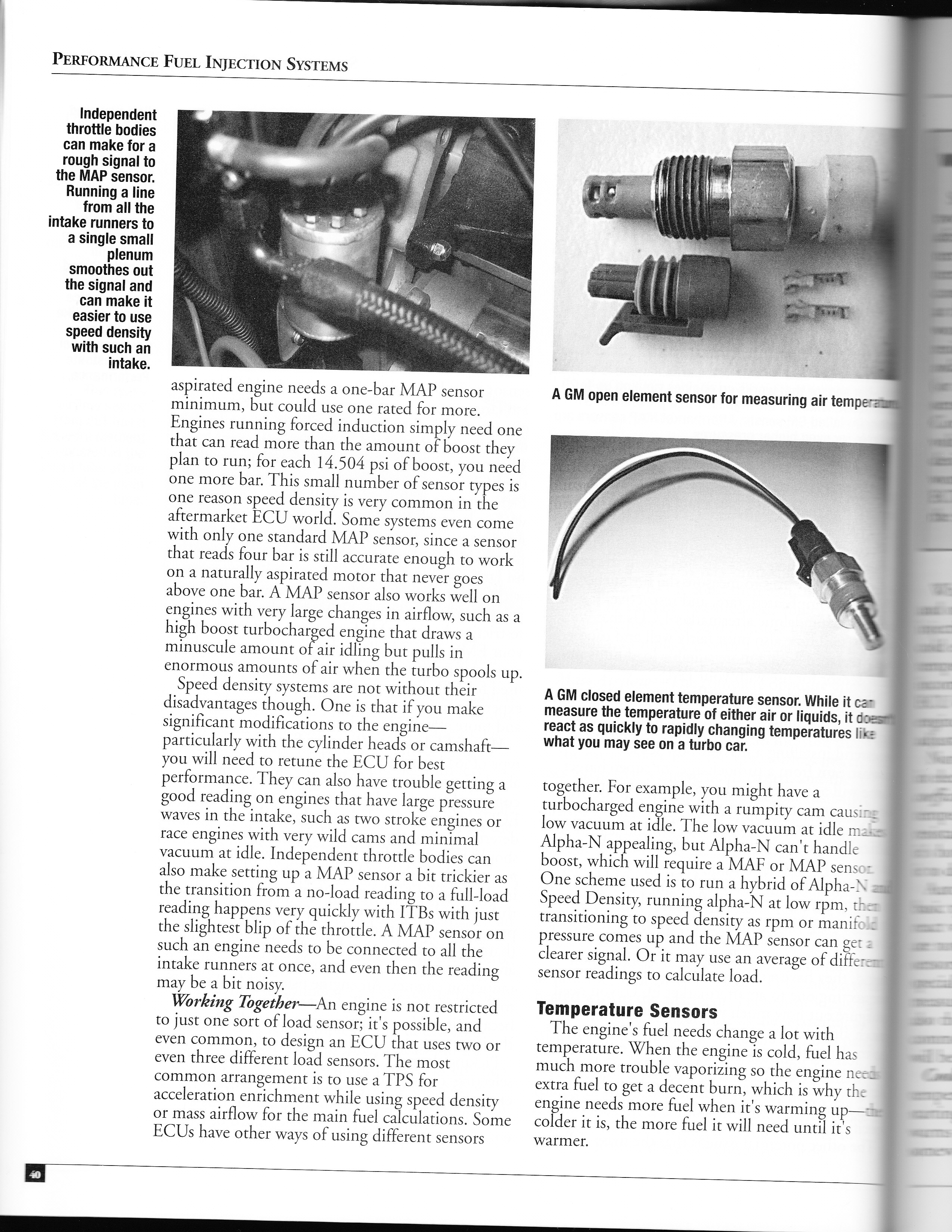

              One of the biggest changes i made was flipping the fuel rail and the ITB's center rail around to hide the fuel and vacuum connections in the back. It also got the fuel lines away from the coil packs which was a fire waiting to happen. I also modified a vacuum ball to act as a buffer for the MAP sensor, we'll see if it cleans up the signal or not.

                I would think a vacuum ball would be a little too big of a buffer for the ITB setup and react too slowly. I've read in my performance fuel injection book that you want all TBs reference going to a common "buffer" like deal, but not a very large one due to what I just mentioned- just to get a reading from each cylinder. If I run back across it, I'll scan it and shoot you a copy of that section if you like.
                  #188
                  That would be cool to see, thanks.
                  It's got a balance plenum already but the volume is extremely small and with having the brake booster and PCV running off of it also it seems like i'm not getting as good of a MAP signal as i could be. It's high enough at idle to throw a code 33 so something is up.
                  I did find that the 3 drivers side ITB's were open a little more than the passenger side, i re-adjusted the idle stops so we'll see if that helps when i get it back together. It's tricky since i'm not using a IAC motor to get the idle right, it's getting closer though...
                    #189
                    Ok, I found it, but they didn't address size, but do mention that it cleans up the MAP sensor signal, and they have a pic
                    It's from this book:
