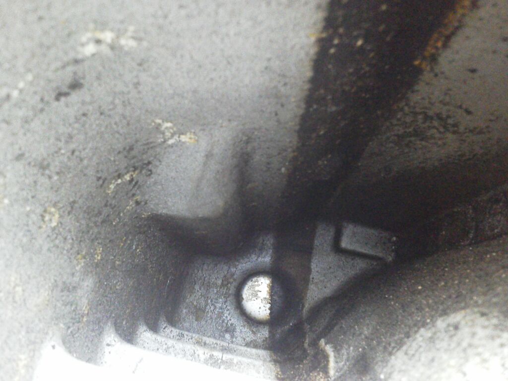

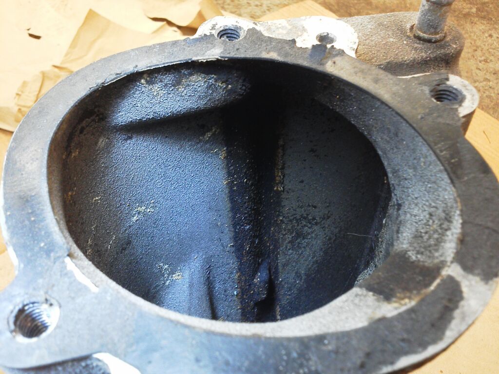

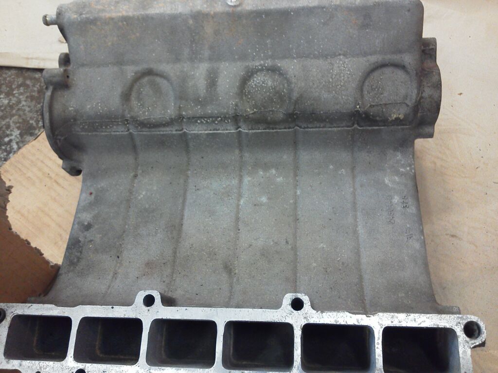

    Formula 88 is still worth a big search for.
    This is a 96 UIM that was soaked 2 days on each side in Formula 88. No scrubbing, no rubbing, no agitation, no circulation. The real evidence is the carbon line inside the intake because I needed more Formula 88, but Lowes didn't have any more.
