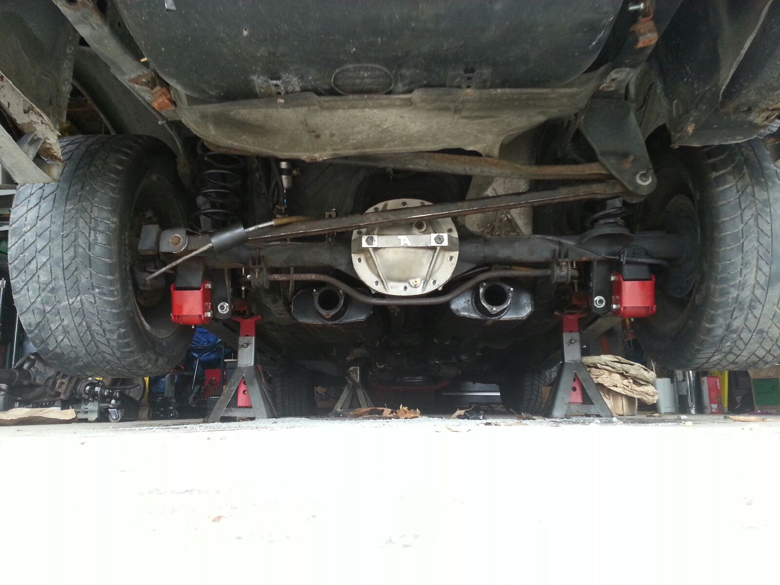

                Spent the afternoon swapping the rear ends, everything is done except bleeding the brakes and installing the diff cover/adding fluid. It'll probably be next weekend before i get to that though..
                I did install a new set of control arm relocation brackets, that went pretty smooth. The biggest pain in the ass was the E-brake. lol

                    for some reason both cables weren't at the same length (the inner), they're off by about 3/4".. lol
                    tonight i finally got the TA diff girdle installed, once the RTV is set i'll add in the fluid. I went with the good Royal Purple stuff.
                    Was going to bleed the brakes (and holy crap, this rear has bleeders that aren't rusted to hell!) but i don't have enough fluid on hand.. gotta wait till tomorrow. damn

                      And it moves!
                      I drove it a whole 50' yesterday. Still needs a good shakedown but so far the brakes seem to work well.
                      Also, I believe I found the cause of my "Gangster lean".. One of the rear springs wasn't sitting right in the rubber isolator. Right now the car is sitting level.
                      Pic of the new rear with the TA girdle and LCARBS installed.
