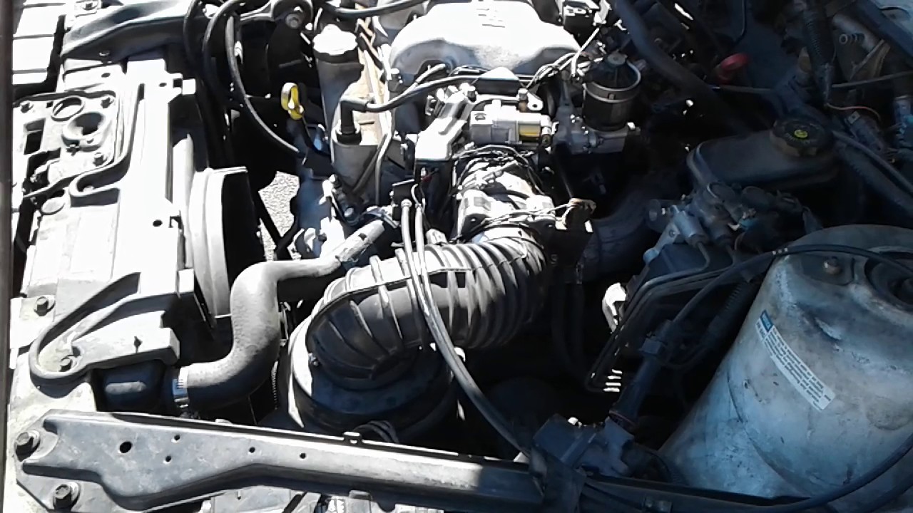

                            Time to pull the transmission! Assume the position.
                            Passenger side brace off.
                            Driver side brace off.
                            Air cleaner and battery out.
                            Throttle body off.
                            Wifey pulling that last spark plug wire.
                            Upper intake off.
                            Power steering pump shoved aside.
                            Fuel rail shoved aside.
                            Lower intake stuffed.
                            That's about all my back could handle for the day.

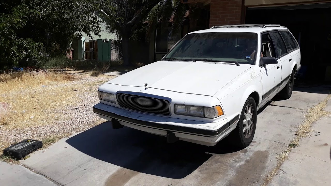

                            Things were quiet for a while. The wagon ran like a champ and went like a stabbed rat, surprising a fair number of folks during the On Ramp Grand Prix and the Stop Light Drags. But, as is the nature of project cars...
                            February 8, 2020:
                            George broke down today, in the most George way possible: the smallest part ground the entire operation to a complete halt. It had to be dragged back home by my other car.
                            Here we see George in his natural habitat: occupying the parking spot of shame in the street.
                            Here we see the problem.
                            To the untrained eye, there might not be anything amiss. The missing part: the 7x trigger wheel that used to be bolted to the crank pulley, which is necessary for the engine to run. It fell off today.
                            It's probably going to be a little while before I can get another one. So tomorrow I'm going to have to put on my big boy underoos and do some work on the yellow sedan to make it worthy of my daily commute.
                            This shit always seems to happen right after I fill the tank with gas too.

                            Today's misadventures involve the fuel pressure regulator on the wagon. I've been having extended cranking times when cold. If I cycle the key 4 or 5 times, it starts fine. Says FPR to me. Let's get started.
                            The regulator is easily accessible on this car. Unlike newer cars with returnless fuel systems, the regulator is attached to the fuel rail.
                            Intake tube off.
                            Throttle body off.
                            The fitting on the bottom is L A R G E. The small screw on the side that I did not take a photo of is a T27.
                            Out.
                            Installation is the reverse of removal.
                            I will find out if this fixes the issue for sure tomorrow morning.
