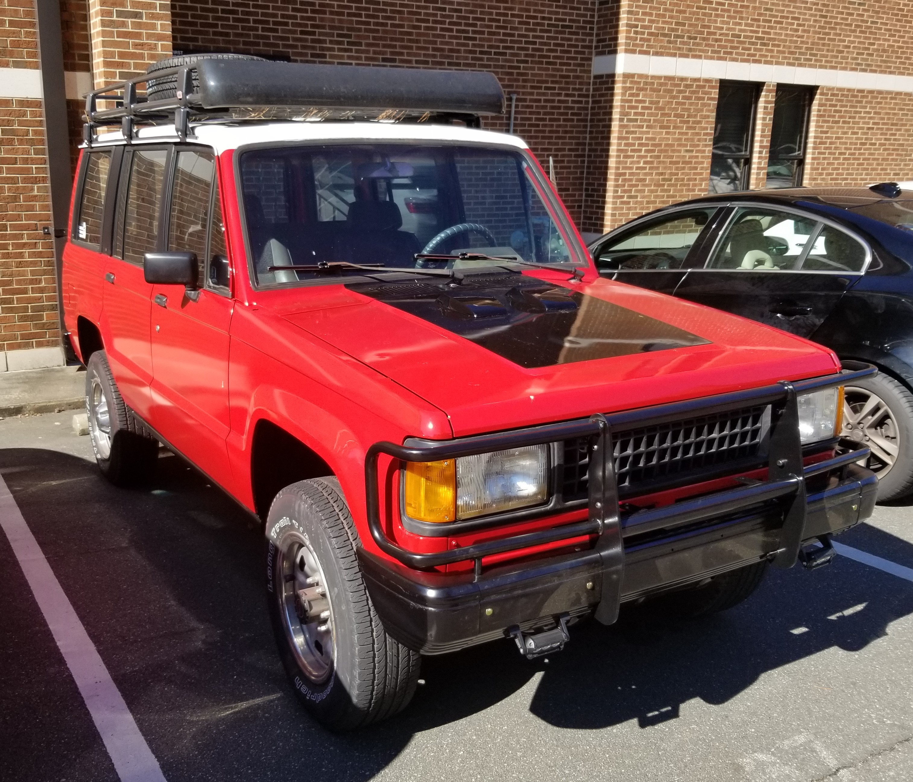

                    • SeanF
                      • Jan 2020
                      • 9
                      by the way, just flipping the breather cap over seems to make a noticeable different, maybe a little more torque? Not earth-shattering or anything, but it does seem to help. Pretty cool.

                      • Evan Walker
                        • May 2020
                        • 11
                        Now, that's fantastic! Welcome to the forum!
